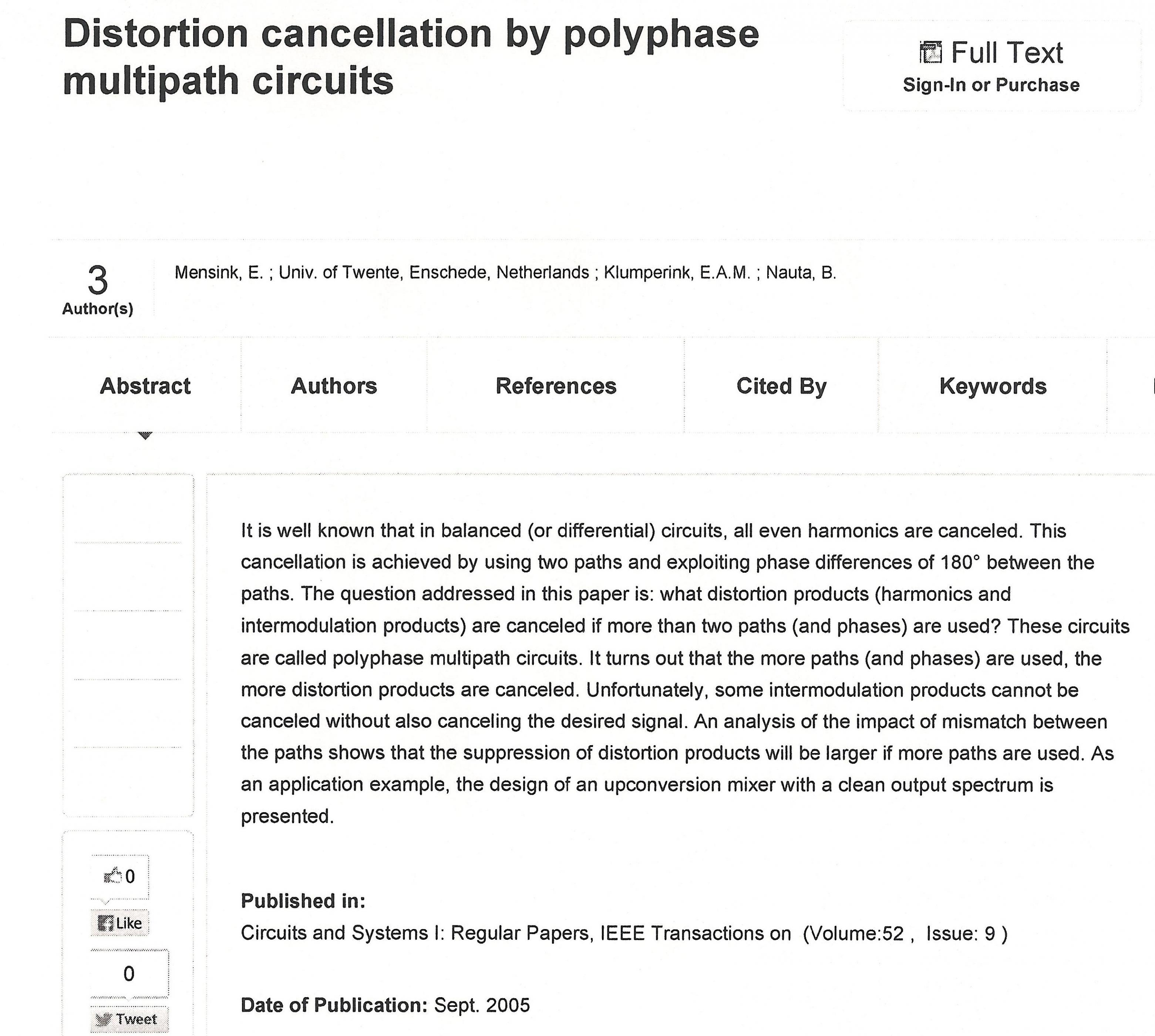

David -- Encouraging your direction - Just saw this:
Thx-RNMarsh
