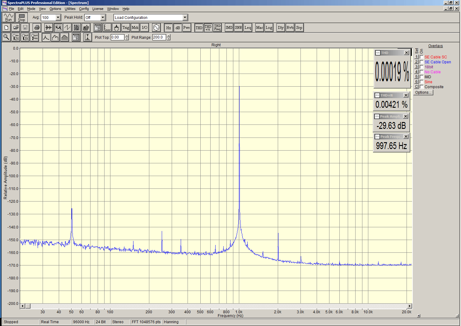

Just boxed-up my PCM4222EVM and ran some tests with Victor's oscillators...
The lowest i can measure is 0.00018% on occasions, which is -115dB THD (no noise)...
The connection is single-ended (negative EVM's input grounded).

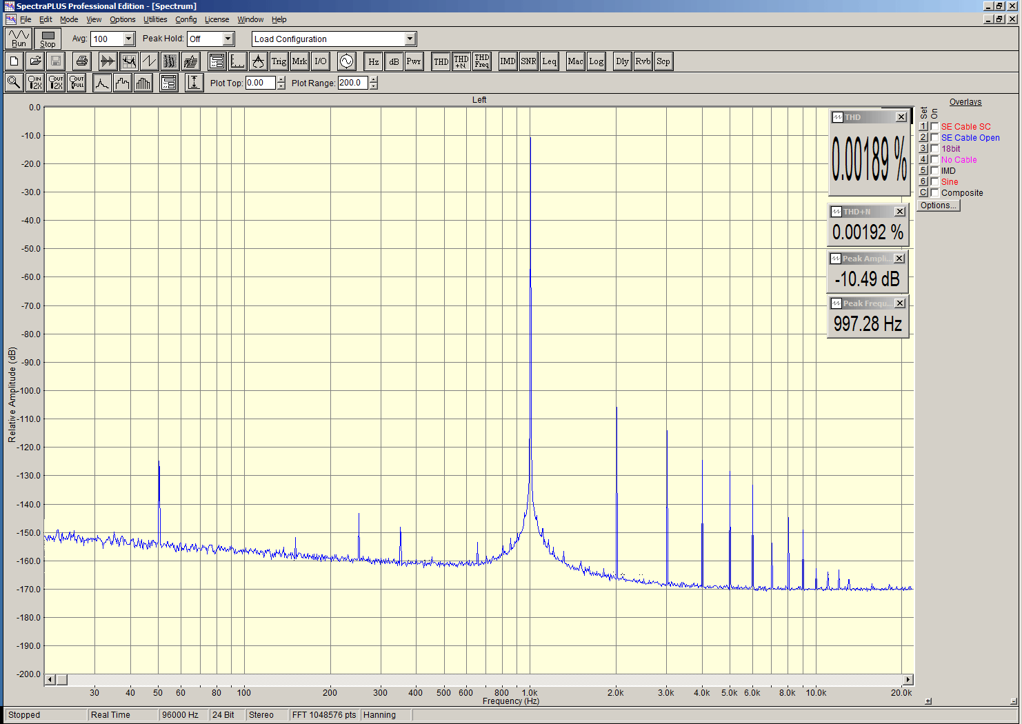

The distortion rises rapidly when i turn the voltage on the oscillator upwards, 0.5vRMS gives rather nasty distortion, and it increases to 0.02% at 2.6v RMS sine 1kHz. Lowest THD is at minimum voltage (300mV)
Same thing goes with 10k and 11k oscillators...
Am i in trouble or that's the limits of my ADC? The noise floor is clean at -170db with enough bins (2^20) and averaging.

Are you using a notch filter?

Here are measurements of both the TI PCM4222EVM and the AKD5394A of the same (AG16) generator. There are a number of plots of the same generator that Richard has published here. I believe you are getting about as good as you can from the TI board. I tried a number of optimizations to get it this good. The AKD5394A was worse before I switched to an external master clock. It made less of a difference on the TI board. They are both using the external clock.

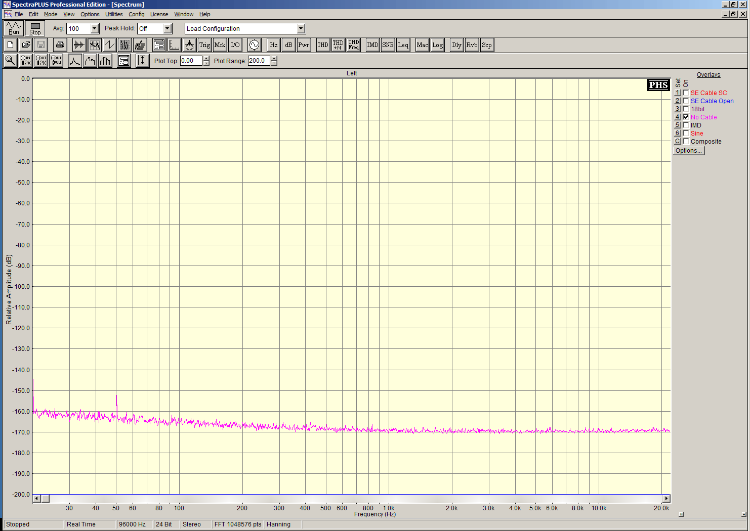

The noise floor is rather clean...

No notches, just Victor's ocillator directly connected to PCM4222EVM (hmm, circa 2m microphone wire in between, source impedances aren't matched between negative (which is shorted to ground) and positive (oscillator's output is 600ohm)).Are you using a notch filter?

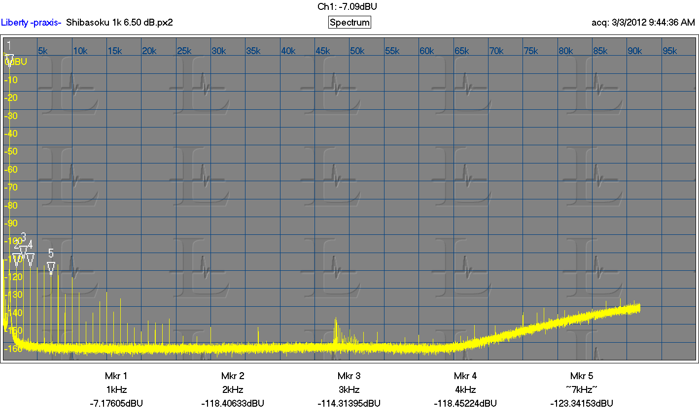

Below is the full spectrum of the measurement I posted earlier at 192 KHz sample rate. You can see the noise rise with frequency.

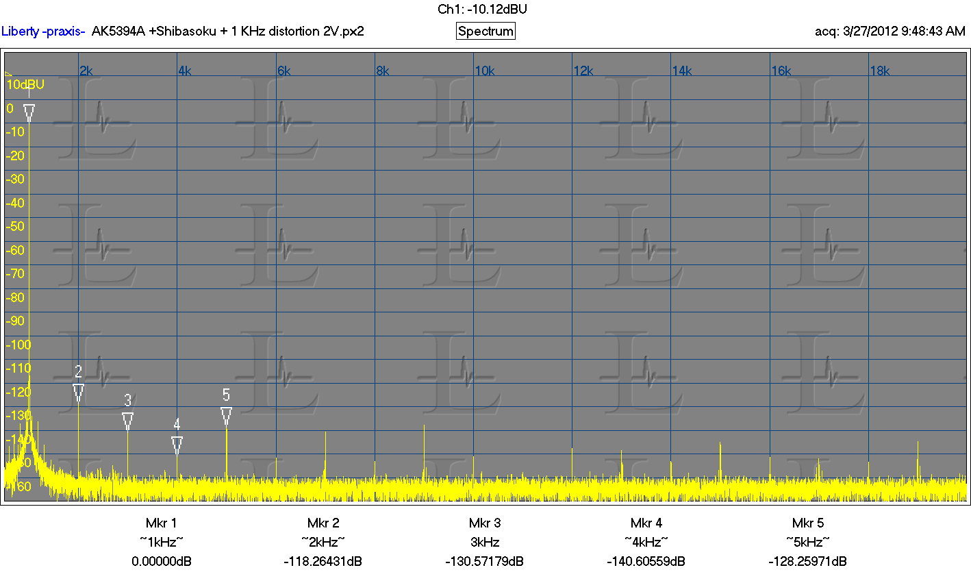

Also, just to make it clear that a lot of resolution is possible with an ADC here is a plot I made of the AG16 with the AK5394A (16 million points, 3 averages, something like 40 minutes to do). The noise floor really is -180 dB and this ADC does not have a rising floor in the operating band. It also shows that getting the resolution up (bandwidth of each bin is really small, something like .012 Hz) gets the noise floor down. You would get the same from a swept spectrum analyzer if you could get one with a .012 Hz bandwidth but it would take much longer to sweep.
With luck I'll have a working shop and can get back to interesting things tomorrow.
