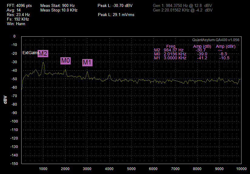

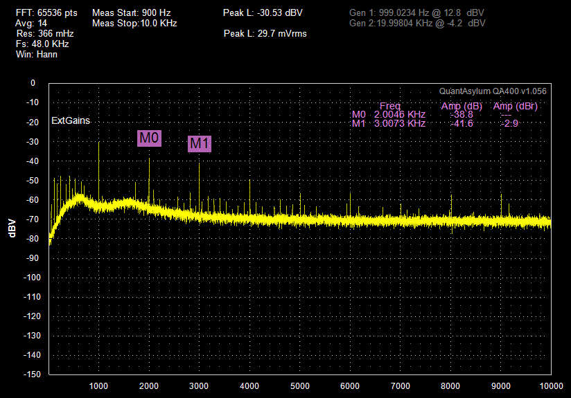

If you increase the resolution on the analyzer the noise will drop and the pesky harmonics will come creeping back out of the noise. You are measuring with a 30 Hz resolution. With the QA400 set to 48 KHz and max resolution the bandwidth is .33 Hz. That should get you down at least 10-15 dB lower.

Here is a plot of my KH4400. This is from the monitor output. The top line is -90dBc. The fundamental is at -120 dB the second harmonic is at -128 and the third is -131. this is with a .3Hz resolution. The second plot is at 23 Hz resolution which makes everything look much more wonderful.
The KH4400 is box stock except for tweaking the second harmonic as low as I can and the addition of the external sync input (which I need to work on). It measures THD+N as -110 dB/.0003%, THD at -120 (.0001%) (400Hz-30KHz). More than good enough for most measurements.

I thing that mostly a coincidence. When the distortion levels of the generator and the analyzer are close you can get constructive and destructive addition because of the phase. Fundamentally your measuring instrument needs to be significantly better than what you are measuring or you can't tell who is who.

I hooked up the QA400 to the KH4400A oscillator (thru an attenuator) and when I take the THD of the loop-thrugh test and subtract it from the KH4400 THD, I get the same THD as the 725 says.
Subtracting the THD from a system performance/loop-trough test is completely meaningless and potentially very misleading. As Demian says in the above post and I have stated multiple times in this thread, the analyzer must be specified (or at least otherwise meaningfully characterized) beyond the level of the measurement. The AD725D is not specified at the -140 dB level.
