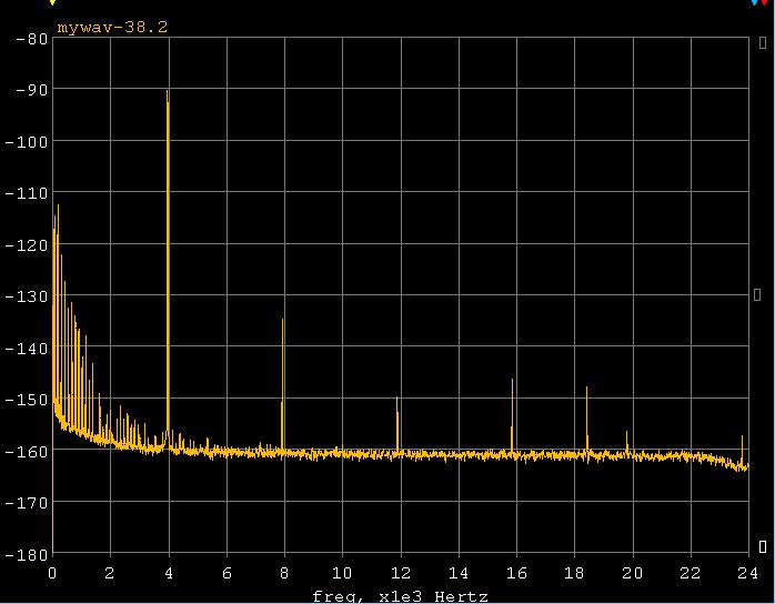

OK, tonights results. I set up my (for lack of a better word) regenerative amplifier at 4.2V rms as the 0 dB reference. I put the output through a twin-T filter after calibrating the gain through the path. There is probably a way to reduce the seconds a little more (-124dB after correction for the notch) but the rest all fall below -140dB or so. The distortion cap was added to the 797 which killed the thirds.
In the plot pictured remember the 2nds are 10dB more and the thirds 5 dB due to the notch being passive.
Schematic to follow. I used an EMU0204 and CoolEdit/Audition, one instance of Audition was doing the 3960Hz injection and I put it in the backround in an infinite loop. A second instance took the measurement in the forground.
The result was very stable and useful as a test source (IMNSHO).
EDIT - I think I will call it the Noscillator.
How sensitive is it to the regen setting? If you turn that down and increase the drive does the distortion increase?
Seperate- how close to the residual distortion of the opamp is this? if you measure the opamp with the boosted noise gain do you get a similar spectrum of distortion (I'm thinking of a way to predict the ultimate performance of a system that is amplifier limited)

OK, tonights results. There is probably a way to reduce the seconds a little more (-124dB after correction for the notch) but the rest all fall below -140dB or so. The distortion cap was added to the 797 which killed the thirds.

How did you get the EMU noise floor down to -160dB?
I'll double check my calibration process, I don't think I missed anything. Right now we are in police lockdown.
0 dB was arbitrarily scaled to 4.2V rms by me just to make the harmonics directly readable. We have our own waveform post processing software that I can use at home.

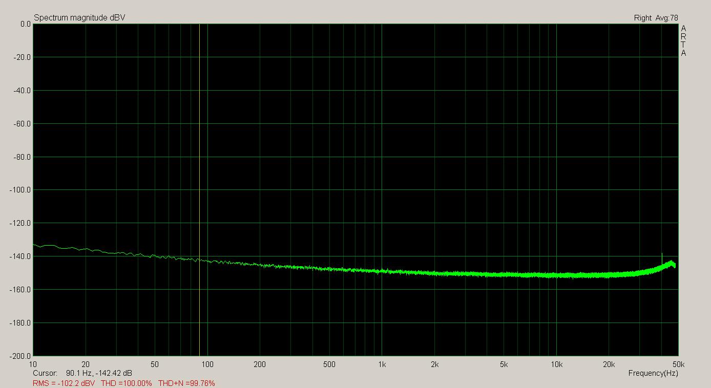

Oh. I can't do that with ARTA.
ARTA will only allow 1000mVrms max calibration so I have to attenuate higher levels to 1Vrms. This is how it's down in most analog Analyzers. The input is scaled to some FS value and maintained by a auto leveler. The EMU 0204 can't do more than what I show in my plots without rescaling the gain of the hardware.
Can you try normalizing yours this way and see what you get. I can't rap my head around what you've done.
This is the EMU0204 with input shorted and 0dB set to FS of the ADC.
Your plot is 10dB better than this.
Sure, the EMU seems to use 2Vrms as full scale? One other problem I have to work around is getting the full duplex to work at 24bits.
