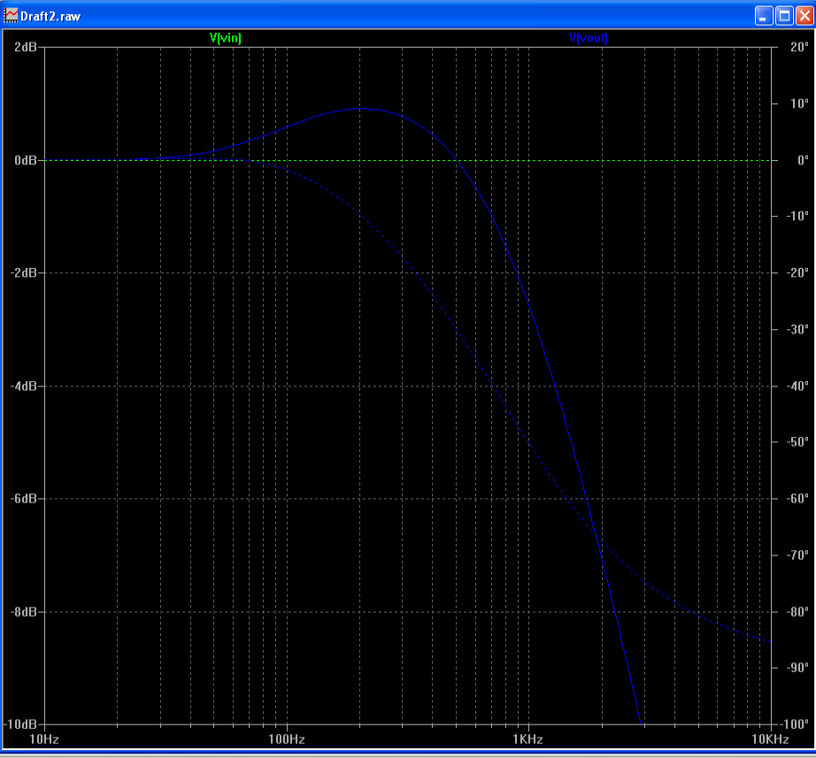

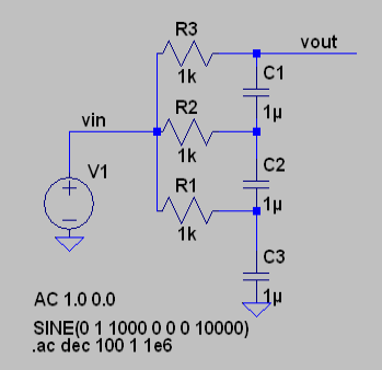

Thinking about that I remembered James G. Holbrook's textbook on
Laplace Transforms, where he presented a RC network that features
voltage _GAIN_ (just a few %) at 0 deg. phase shift, so it should
oscillate with a follower. He has US patent 2769088 on it. Definitely EOL.
I just entered it into LTspice and while it seems to work, the phase slope
at 0° is _very_ flat, so the phase noise is probably really bad. I have not
made up my mind if this hurts this application.
The positive gain region with the components given is about 50 to 500 Hz.
He also has a RC network with 21% gain, but today for me, it's late enough.
regards, Gerhard

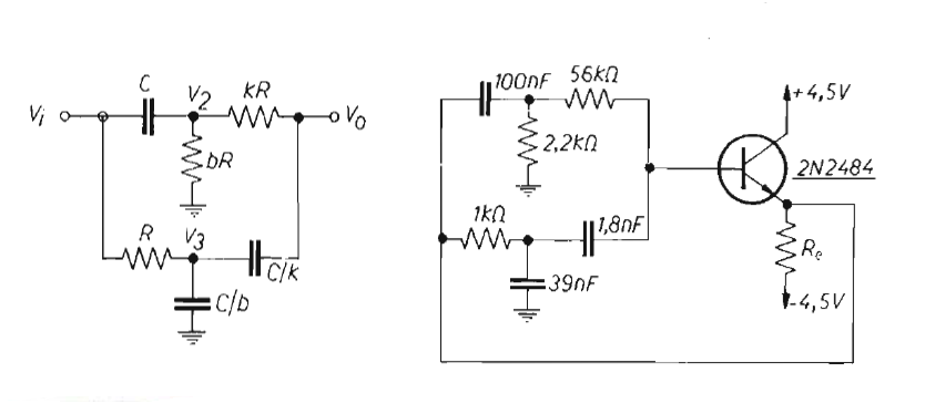

When I was very young I tried this one by Murphy (the picture is from an old italian magazine) - it worked
Spice says that with shown values voltage gain is about 1.55 dB @ ~1.6 kHz (and 0 deg phase shift).
Ciao,
L.

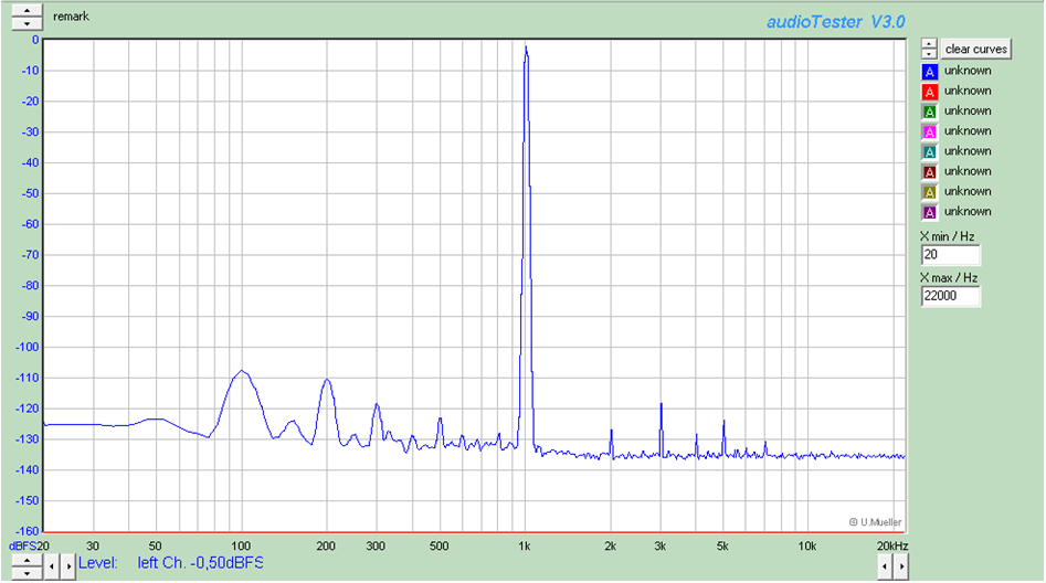

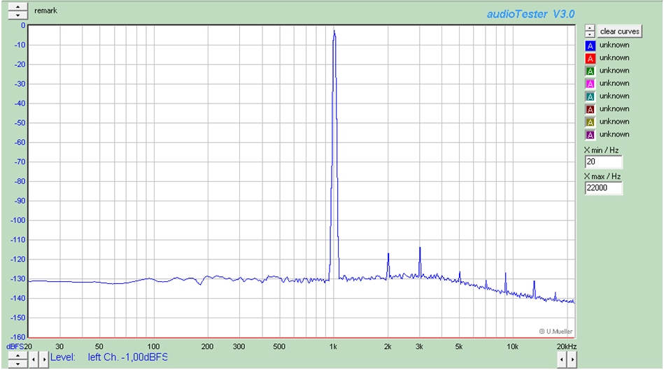

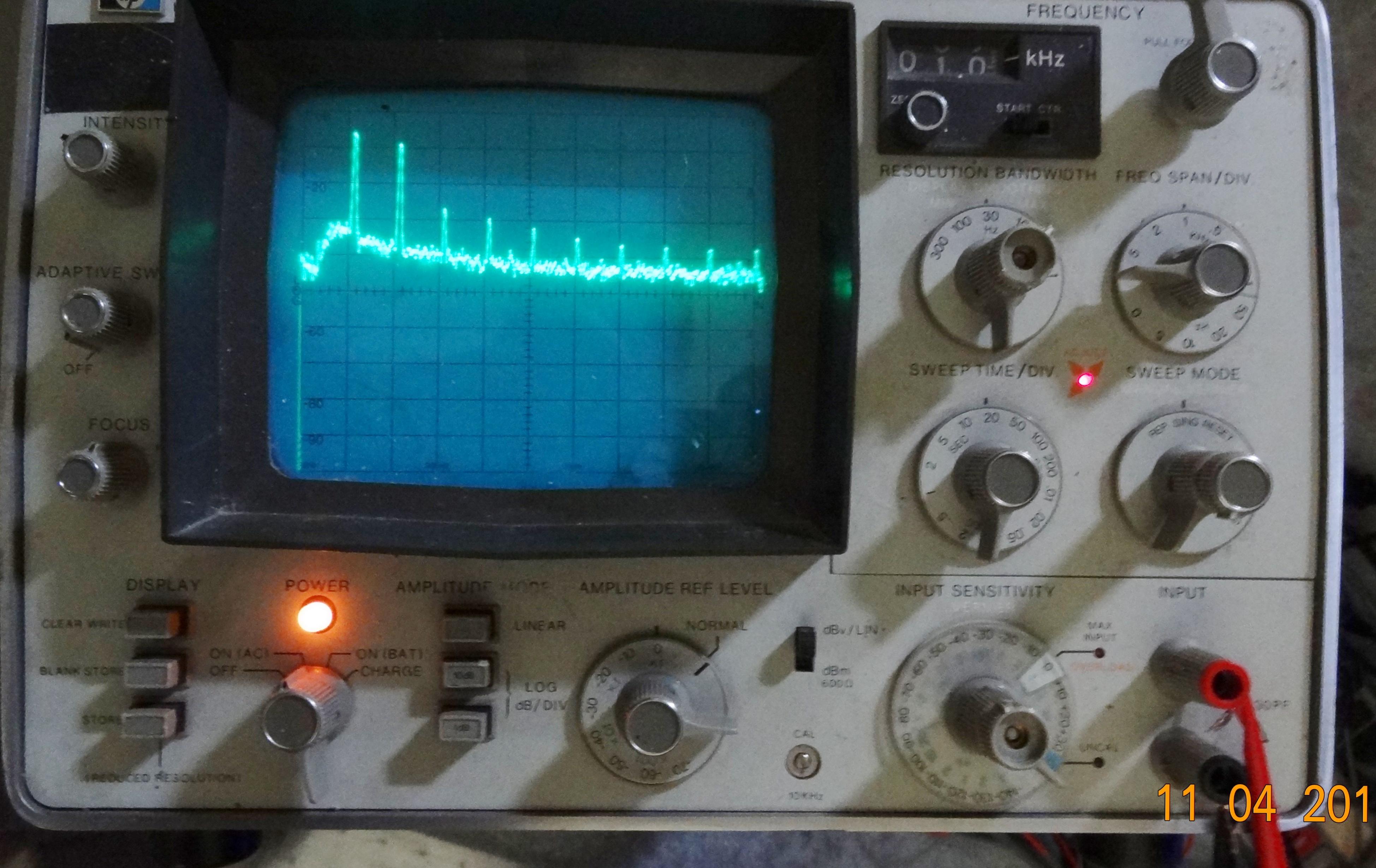

@RNMarsh
I promised you a measurement result made with my CS5381 based ADC. In this case I have used a Stanford Research DS360 as generator. The level was 1.83V balanced, which is around 1 dB below max.
The 50Hz hum and harmonics are due to the generator/mains noise. A similar test with my own DAC does not have this problem. See the second picture. The distortion level is higher though.

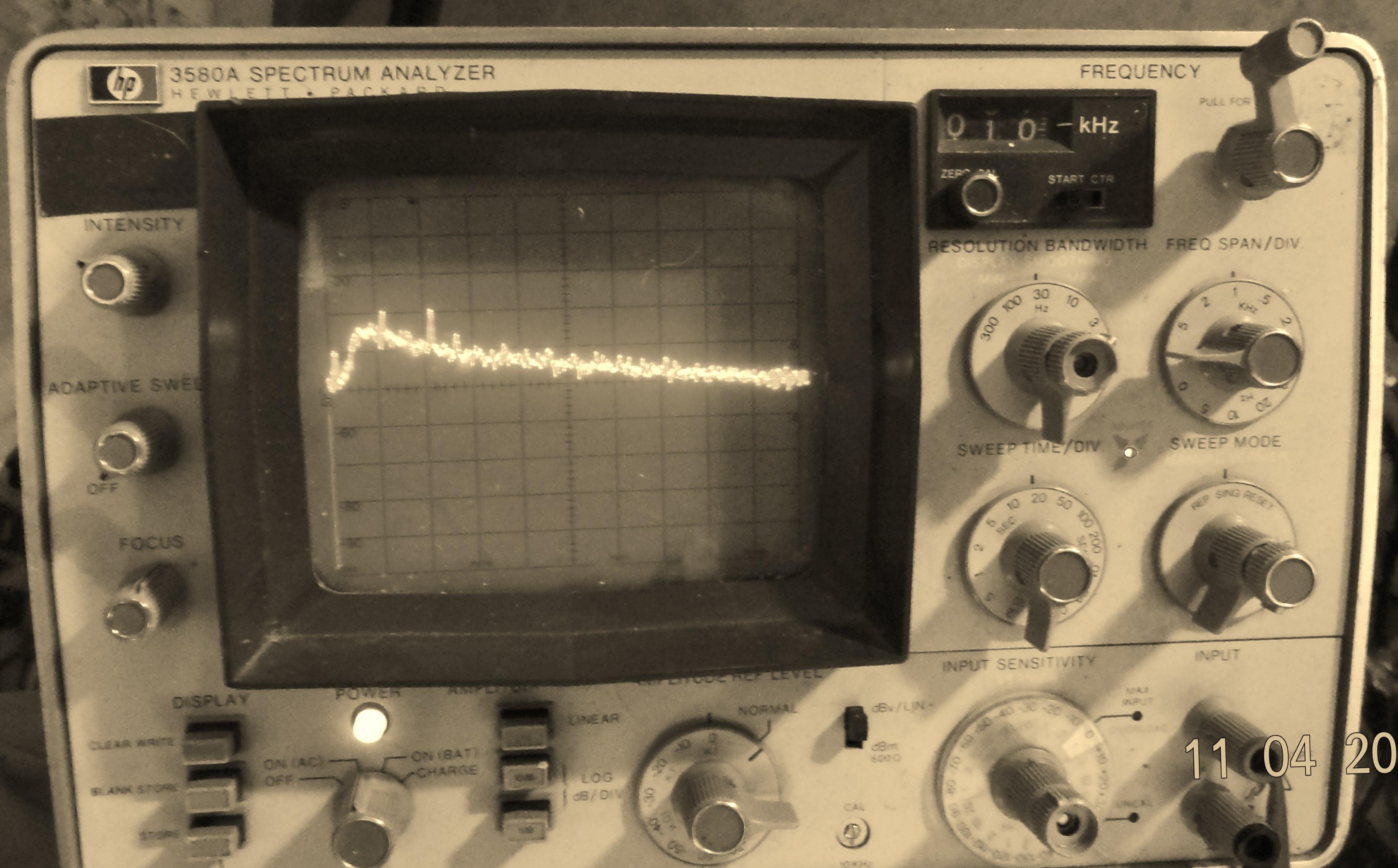

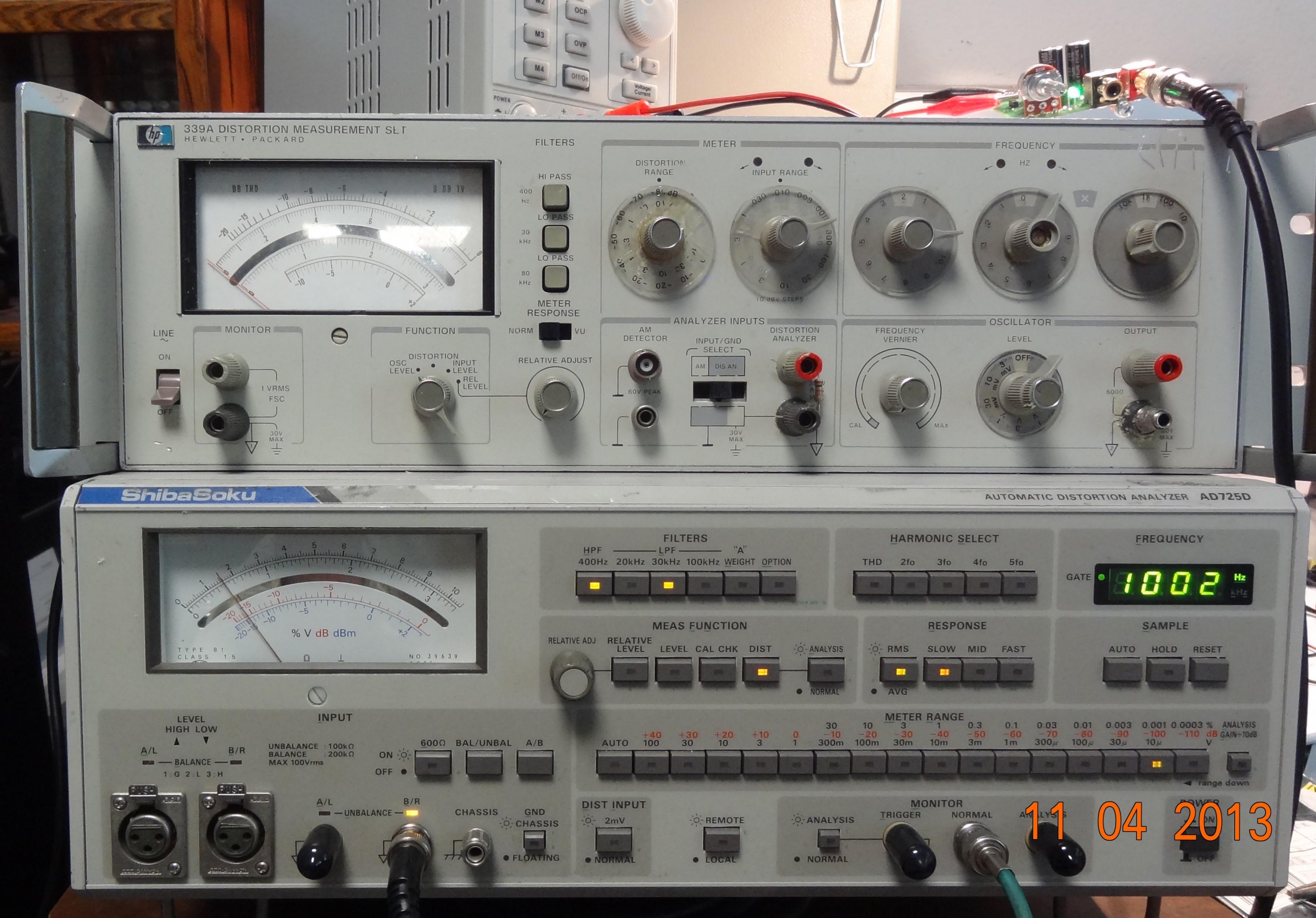

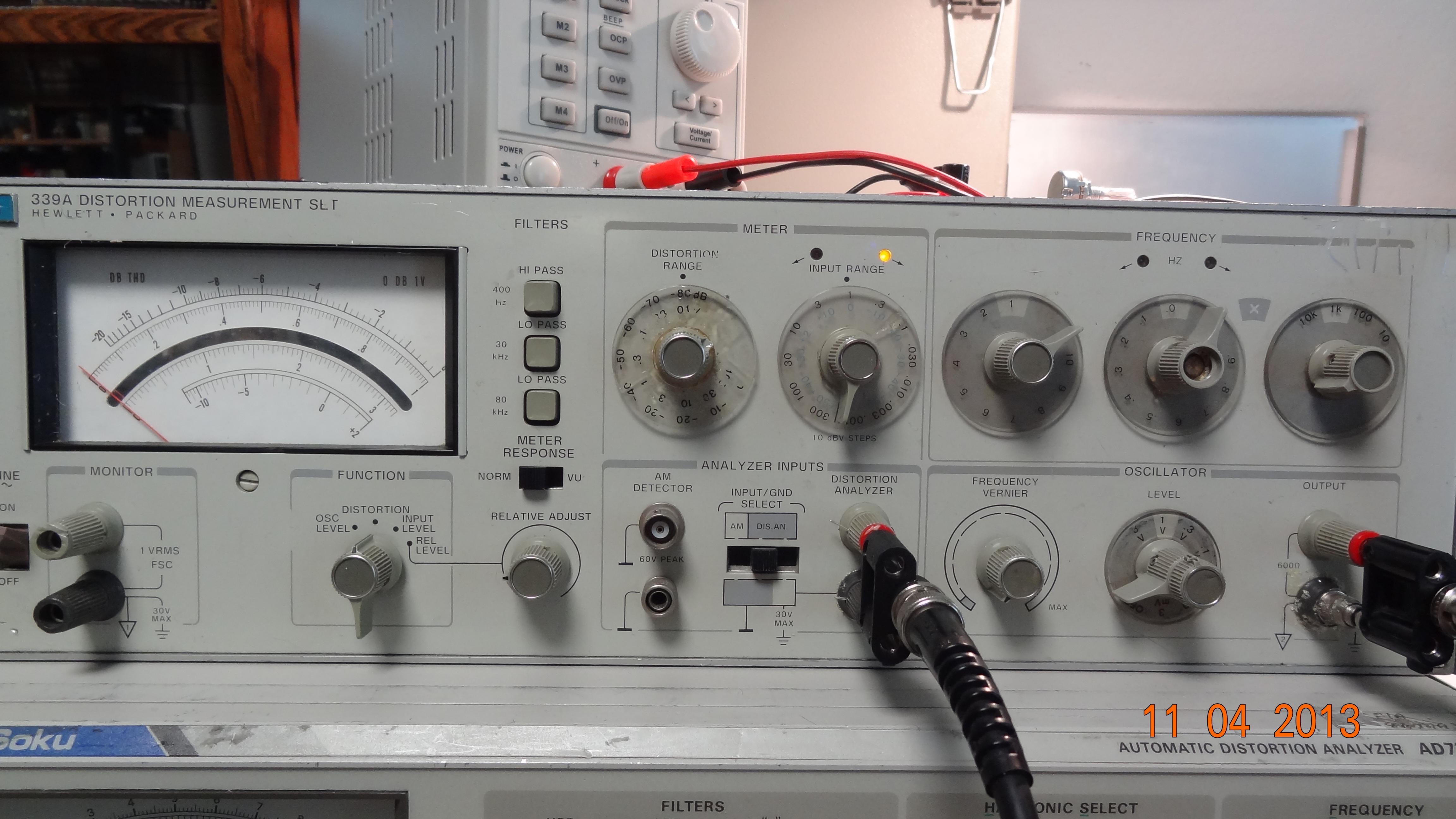

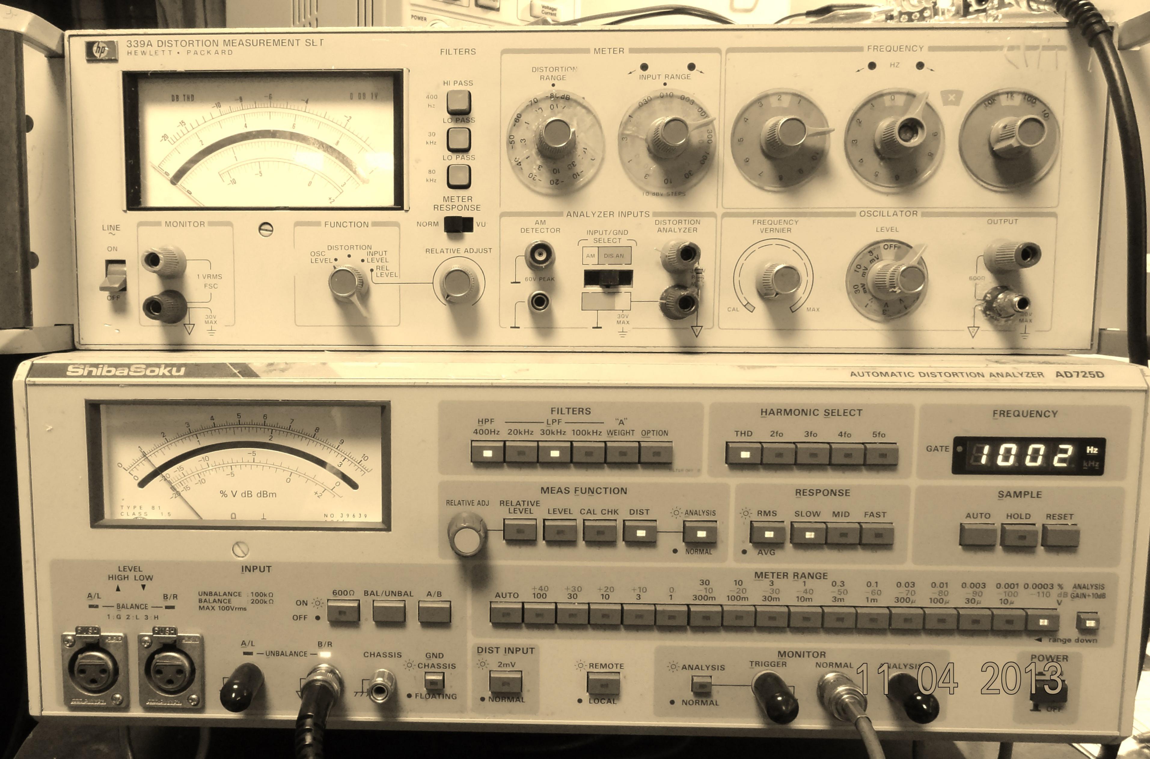

For those who dont like to read a lot --- we recap every so often:
The 339A is a thd+N meter. The osc and analyzer spec is .0018% or better. That is a tick below the 0.2 mark on the 0-1 scale (-80dB =1).
After opamp and parts changes and upgrades, the thd+n is near the 0 mark -- well below -100dB. This is THD+N.
Using the 339A monitor output shows the two dominant harmonics at -106db and -110dB for 3H. The top is -100dB and 10dB/div. and measured with shibasoku 725D analyzer ported to an HP 3580A Spectrum Analyzer to measure individual harmonic and noise levels. This is a compromise tuning for a wide range of freqs; For minimum thd+n at only one freq, it can be much lower:
At this point in time we started using an FFT (Davada's QA400) on the monitor port instead. Then I got the ShibaSoku analyzer which can do both what the 339A and an FFT does. But they are rare and expensive. I continued on with just various other oscillator upgrades and davada and others worked on the FFT. Notch filters exist and are shown in other forums. I built one of the notch filters and am working to get an FFT that works with my cpu system without problems. A clean source and portable test system is highly desirable over my bench equipment/system.
Thx-RNMarsh
Thx-RNMarsh
