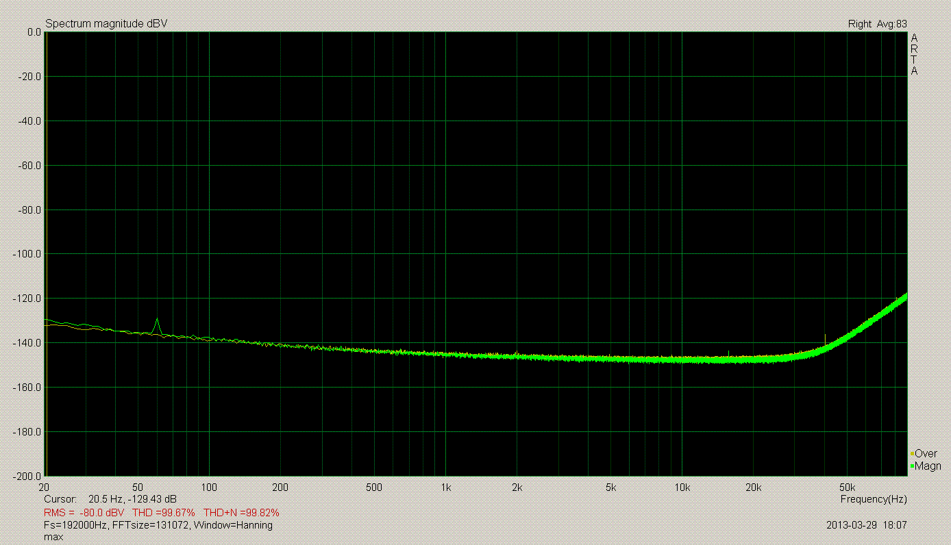

Lamp Multipler

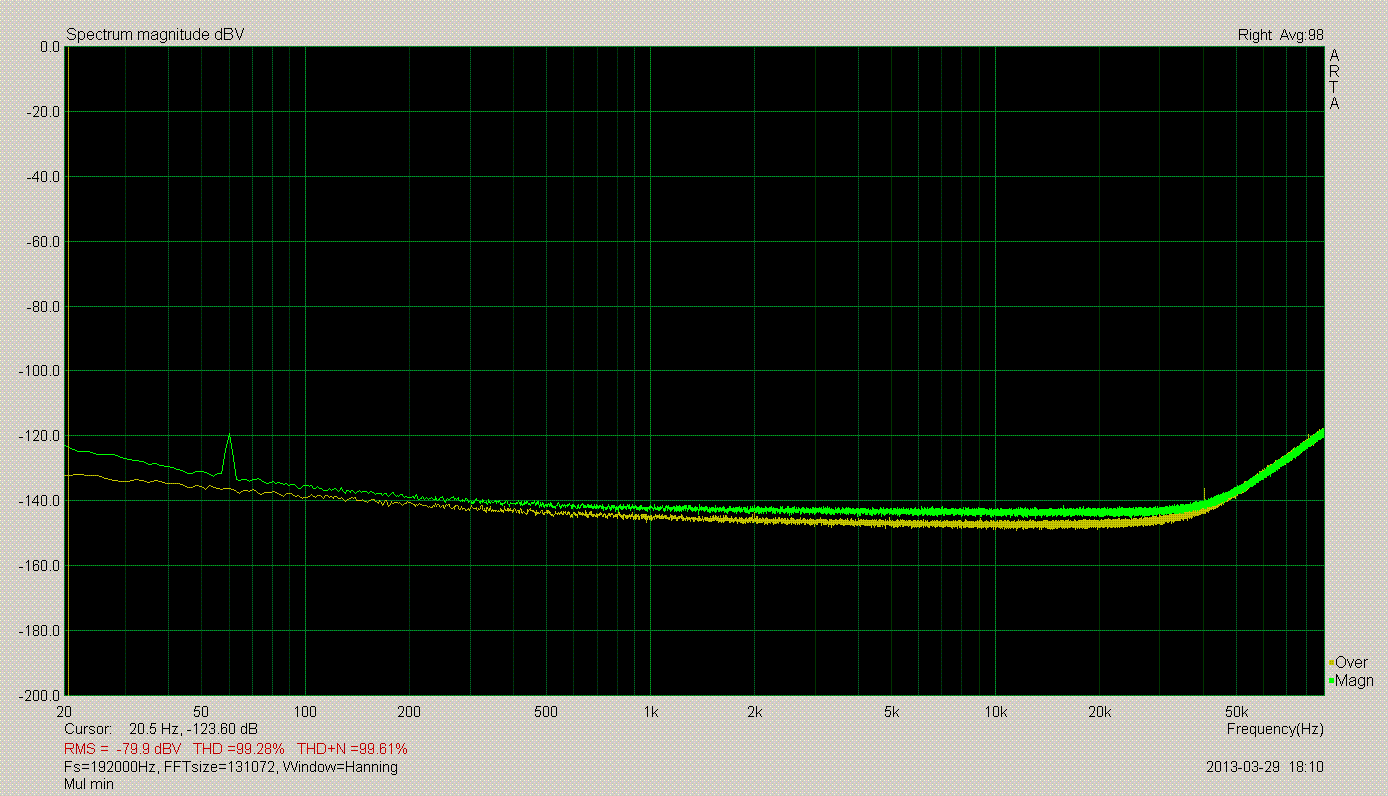

I have the lamp multiplier in isolation.
This is some noise spectra of the output with no input connected from the SVO and no notch.
The multiplier has a large Vc to multiplier zero offset.
The yellow overlay is the EMU0204 with input shorted.
All measurement is referenced to 0dB FS. 192ksps 131072 points and linear smoothing.
The second image is with no Vc input so the lamps are cold at minimum R. The noise gain of (6.8) of the multiplier is at maximum in the non inverting mode. The signal gain is maximum. This represents the minimum range frequency of the OSC.
The first image is with maximum input Vc. The lamps are brightly lit. The noise gain is at minimum and the multiplier is in inverting mode at maximum signal gain. This represents the maximum range frequency of the OSC.

with and without the multiplier lamp?
6db to 2-3 db upper freqs. Does not add much to the noise.
We can infer from this that most if not all oscillators do not have a great deal of noise from their multiplier?

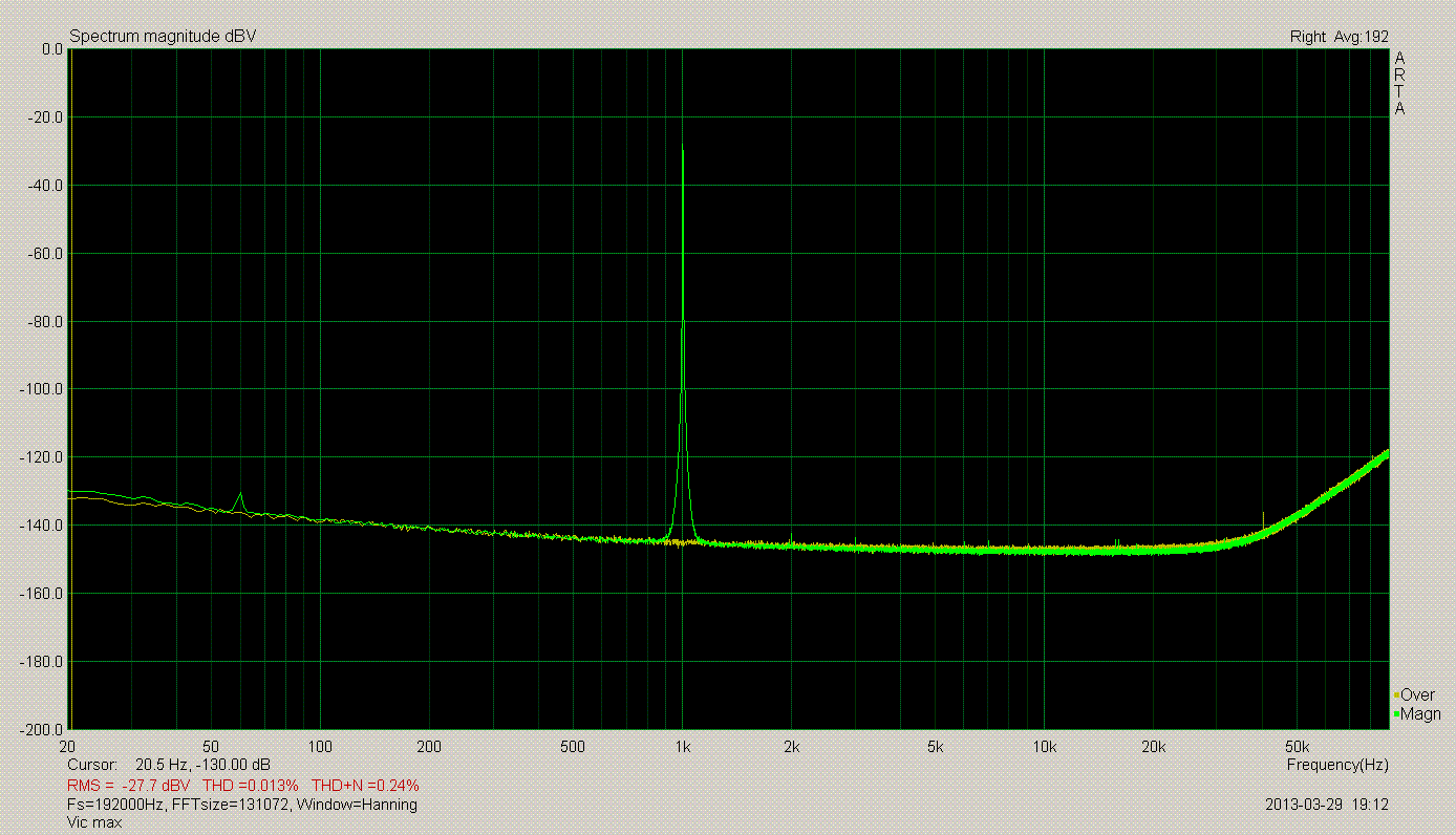

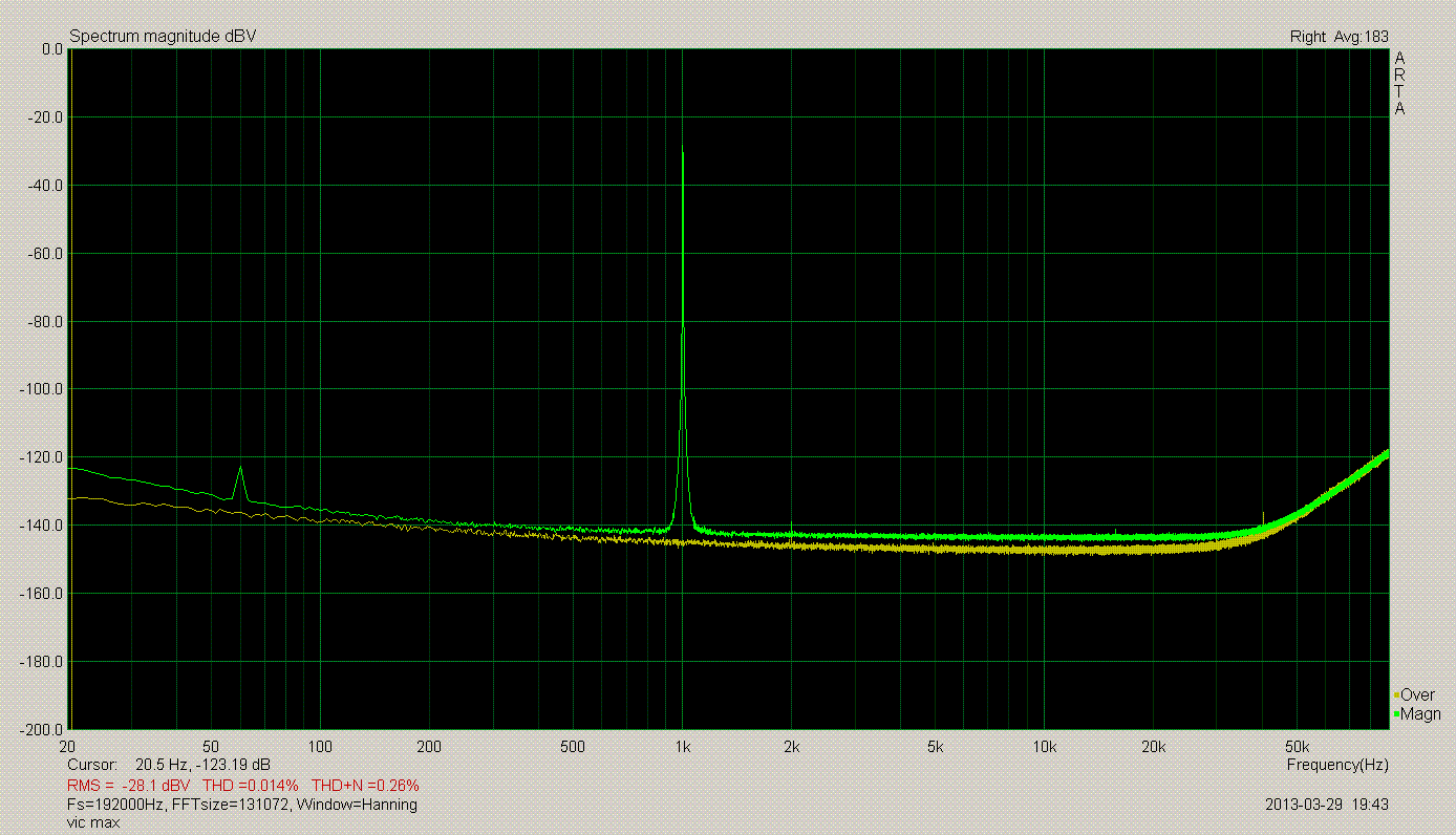

Lamp Multipler
Every thing here is the same as the above post but with the addition of Victor's 1kHz oscillator.
The osc output is 1Vrms into the multiplier input.
The pics show the natural attenuation of the multiplier at min and max Vc.
The last plot was from the monitor port using the fft. The first pair are FFT vs. swept on the distortion analyzer port. That port is just harmonics with the noise removed. The phase relationship of the harmonics is retained as well. you can reconstruct them using the trigger jack to trigger the scope which can help identify sources of distortion by their relationships.

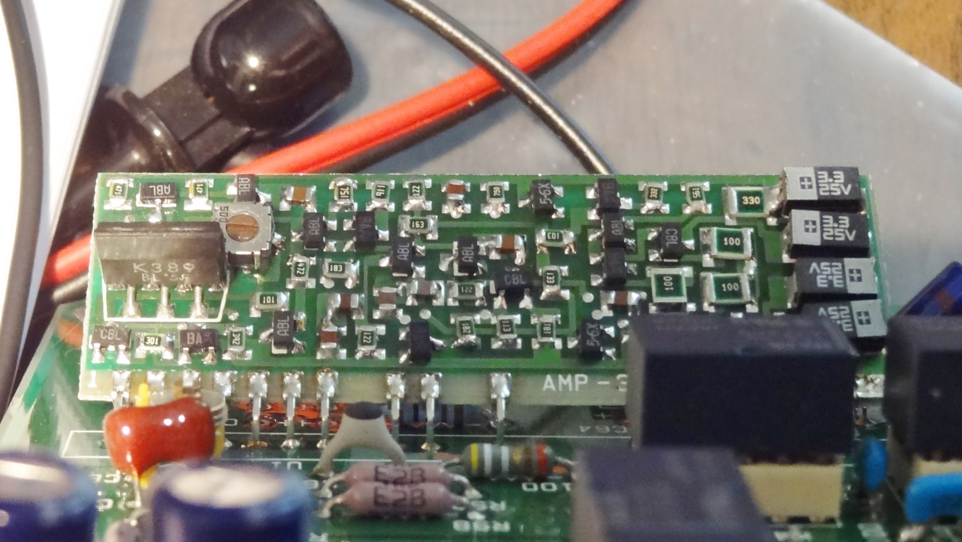

If the front end of the 725 isn't quiet enough you won't get there. That is the first place to quantify.A quick check on this one indicates that the input noise is -110 dBV in a 100 KHz bandwidth. That would be the equivalent of 5000 Ohms. (Useful tool for this- Thermal Noise Calculator ) And that translates into 8 nV/RT Hz or -160 dBV in a 1 Hz bandwidth.
Without the circuit diagrams we are limited in what we can do to improve this. My guess it that the input attenuator and protection circuits are the source of the limitation. The input transistors are probably significantly quieter than this.

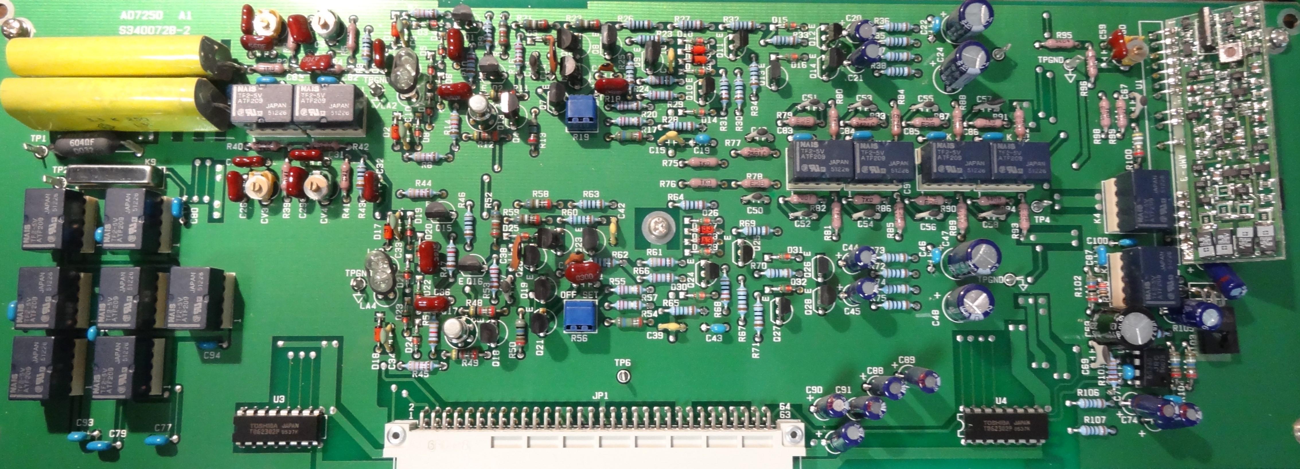

I am about to start looking at the analyzer some more. The input card looked like it was all discrete but a further look will reveill more when I remove it. The filters are always noisy for some reason... Will get into it more soon. Without schematic it i slow going but still doable for certain basic things - especially analog portions.
Have you disconnected the protection to see if noise drops? Shorted the input pot/attenuator to see if noise drops/changes as you think it might?
Thx-RNMarsh
Thx-RNMarsh
yep its all discrete analog design to get the performance they felt was needed. Only one opamp IC (5534 - maybe servo?) to replace. All the input switching is done with hermetically sealed relay contacts.... Will be looking at in more detail-- Notice the K389. Wonder what the topology is?
