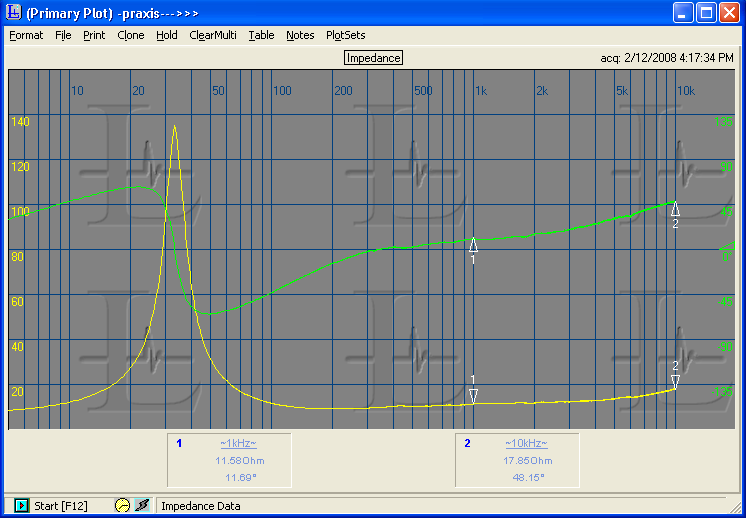

here is the impedance curve for the TD15M.
Here is an impedance curve from the TD12M which may be of great interest for this application:
I don't have a response curve for the TD12M on here, but it is extremely smooth as well.

Since there is no set standard, companies often denote things that can be a little confusing. With a top plate thickness of 8mm and an 18.5mm coil you have approximately 5.5mm overhang on either side. This gives a good indication of their Xlin, which would essentially be the point at which the Bl drops to 70%. Xlin doesn't make too much sense as the Bl isn't linear over that range, it still drops 30%. Xmag and Xsus are much more clear, Xmag being the magnetic Xmax to 70% of the rest BL, and Xsus as the suspension limits of the driver. Xmax is then the lesser of the two.
A driver with no shorting ring and high 1.8mH inductance isn't going to be too usable past 200-250hz IMO. Without a shorting ring, it's also going to have serious issues with flux modulation as you get the driver moving to higher excursions, which is a given in an OB where you need to apply boost at the low end. See our paper on Designing for Low Distortion: https://www.aespeakers.com/Lambda001-1.php
The Visaton is also only 92dB 1W. If you aren't needing much senstivity but want more Xmax, our TD12X, H, and S are all options with a full 14mm Xmax, much lower inductance, lower distortion, higher bandwidth, more efficiency, etc. The TD12S has the highest Q out of all of them so is probably the most suited for an open baffle: https://www.aespeakers.com/drivers.php?driver_id=11

There are quite a few reasons for this. If you look at an impedance curve you can get keys to what is going on. One of the biggest is due to inductive rise, and non-linear inductance with respect to excursion. As impedance begins to rise, distortion does as well. The driver is no longer electrically flat and relies on the cone breakup for the extra output. As the driver begins moving at higher excursions, the "core" of the VC changes from being iron core to air core. As this happens, the inductance of the driver decreases, and the impedance begins to flatten out, meaning more power is delivered in the upper frequencies. This is part of the reason a zobel on a tweeter can help eliminate harshness as it minimizes this effect.
In reality though the best way is to remove the driver's self inductance, not use a filter to compensate for it. The filter does nothing to help with flux modulation in the gap which is going to greatly increase distortion.
Other than that, you have many resonance/breakup issues to deal with. Again you can see this in an impedance curve as sharp blips and bumps. The more broad and well damped these bumps are, the less they contribute to the bad sound you are mentioning. Damping surround resonances is one big issue to deal with. Damping the cone resonances is another. Either of these if not taken into account can cause some serious harshness as you state. A paper cone is really the easiest materials to damp a resonance from. Materials like aluminum, magnesium, and some poly cones can be nearly impossible to do anything with. There is also much to be said about the profile of the cone in terms of how much it resonates or doesn't resonate. Then one of the biggest culprits to resonance is not the cone itself, but the dustcap. I recently experimented with the 6ND410 from 18sound. It had a horrible breakup at 4.5KHz of nearly 10dB. I had to add 6 grams of mass to the dustcap to damp it, but removing it totally removes the resonance. A phase plug greatly helps in this situation.
Our TD15M is quite flat up to 4KHz. The motor has a full copper sleeve on the pole which forces the coil to act essentially like an air core over it's entire travel. No large changes in inductance with excursion. No need for impedance compensation. This uses a curvilinear paper cone. We put a lot of attention into damping both the cone and surround. We use a large phaseplug which keeps the acoustic loading on the cone the same throughout the entire excursion range. In the end this is really one of the best midrange drivers we have. While you will be limited due to the directivity of a large 15" cone higher in frequency, the smooth flat response and flat impedance curve give you a lot of room to work with this driver.
