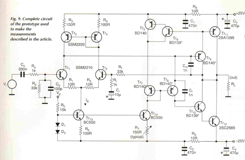

Non-Switching Class AB
The New Class AB design from Erik van der Veen and Ed van Tuyl (Electronics World, december 1999) was mentioned in Post #13, 22 +...
The original article can be found at https://andiha.no/audio/temp/newclassab.pdf

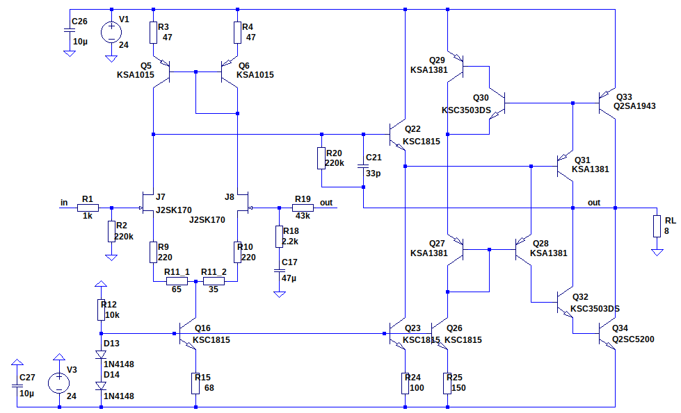

A closer look at the design made me think it would be possible to improve the design.
In spite of the high open loop gain, the distortion is rather high and both the open loop bandwidth and slew rate is rather low.
The original design schematic is shown here.

My proposal is shown. The main improvement is the added emitter follower. This both reduces the distortion significantly and makes it possible to increase the slew rate figure and the open loop bandwidth.
I am a fan of using JFET input transistors, eliminating the input coupling capacitor.
Simulation looks promising, so the question is:
Would someone try to build it?
I am to busy to do it myself, I am afraid...

Here is my LTSpice file. R11 is the offset adjustment and R25 is the bias adjustment.
The distortion is less than 0.01 % at 25 W into 8 ohms with a bias of 0.6 Ampere. Then the collector current for the output transistors is more than 40 mA minimum. However, if the bias current is lower, the distortion rises heavily and the output transistors is nearly switched off (and I don't know the reason why).
The open loop gain is about 56 dB with a bandwidth of about 20 kHz. The phase margin is more than 80 degrees.
