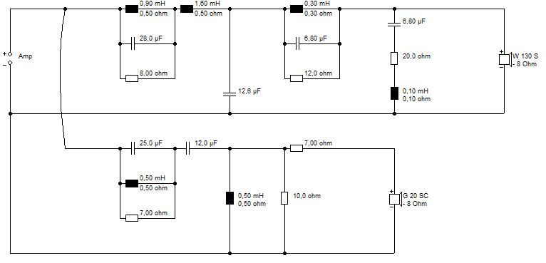

Great questions and you are not trolling at all. You are aware of my other Harsch XO thread so all I am doing is applying that to a tapered TL with damping applied to produce a gentle fall-off slope in the bass which translates to low group delay. The un-damped TL has a response similar to a vented bass reflex alignment with a double impedance peak. The TL has a lot more vent cross sectional area though so bass output flows a lot less impeded. It achieves low tuning via quarter wave TL vs a BR volume resonator. By adding damping strategically and monitoring frequency response and measuring resulting impedance peaks, one can adjust the bass fall off slope and trade off some extension for less group delay. You know you have the damping right when the impedance peaks get squashed into almost a single broad bump with two little "horns" where the peaks used to be. In this state, the bass extension is still very good and the group delay approaches that of a sealed box. I have measured a GD of 6.5ms at 50Hz. Some of that delay is from the XO filter.
The cabinet is a folded 48in long TL with a taper ratio of 5:4:3:1.5 - tapering produces a deeper tuning frequency than a straight TL. This one is tuned to about 55Hz.
On the XO, I implemented in minidsp active 2 way which lets me dial in time delay for Harsch XO time alignment. This requires the tweeter to be delayed by half the period of the cycle at the XO frequency to allow the Harsch XO to be quasi time aligned. I tried to implement this passively and it's my second passive XO design so a lot of work is needed still. I tried to remove bumps and wiggles which is why it's so complicated. With passives however, the only time to effect such a large millisecond range delay is to physically step the baffle and out tweeter back.
On the speaker you reference above, it does have similar 24/12 slopes - but by its nature of being passive and flat baffle - there is no way it is a time aligned quasi transient perfect speaker. So not technically a Harsch XO.
To do this passively - it makes more sense to spend a little more on a smoother mid bass driver to save on having to spend so much on all the coils and caps needed to flatten it. Not a problem with minidsp. I would use an AC130F1 if I were to redo this for a passive XO. That driver is flat and easy to make work in a 2 way.
Hope that helps.

OK, thanks for a very prompt answer.
This stuff is hard. Are you saying we can do this sort of asymettric Harsch 12dB/24dB slope with regular filters and a bit of time alignment like this "improved" Snell?
It's a weird thing, but sometimes you just hit on a filter that makes the music leap out live, if you follow. According to Lynn Olson, even cabinet geometry and rounding the corners, has a huge effect on time coherence:

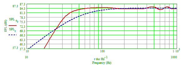

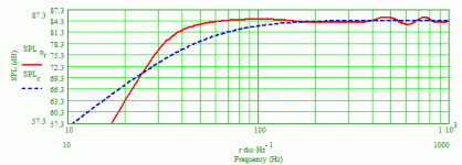

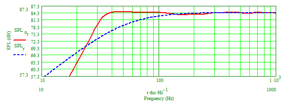

An ML-TL version for the ES140Ti
I modeled a 50-inch long mass-loaded TL essentially equivalent to the tapered TL I modeled. The ML-TL has a constant cross-section modeled at 6"W x 4.5"D. The ES140's center is, again, located 10" from the beginning of the line, while the mass-loading port's center is located 3.5" from the end of the line. The port has dimensions of 1.75"D x 3.75"L. The stuffing density is 0.75 lb/ft3 with the first 2/3 of the line stuffed, requiring ~6 ounces of polyester fiber. I've attached the predicted bass response (red line) for an input of 2.83v/1m and with 0.5 ohms added in series with the driver. The advantage of this ML-TL as compared to the tapered TL is a lower F3 in a smaller line volume and a generally smoother response. Also, it's easier to tweak the system tuning via the port's length (this ML-TL is tuned to ~35 Hz). The disadvantage of an ML-TL is that the port's air velocity is significantly higher than that in the terminus of the tapered TL, but there still should not be any audible port noise since the port will be on the back panel if this is built as a single-fold line similar to the tapered TL.
Paul
Paul

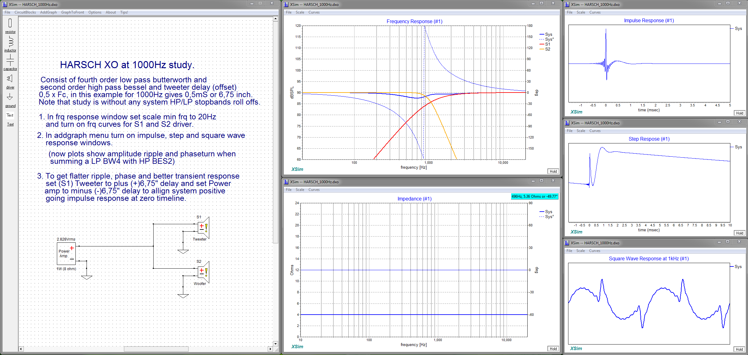

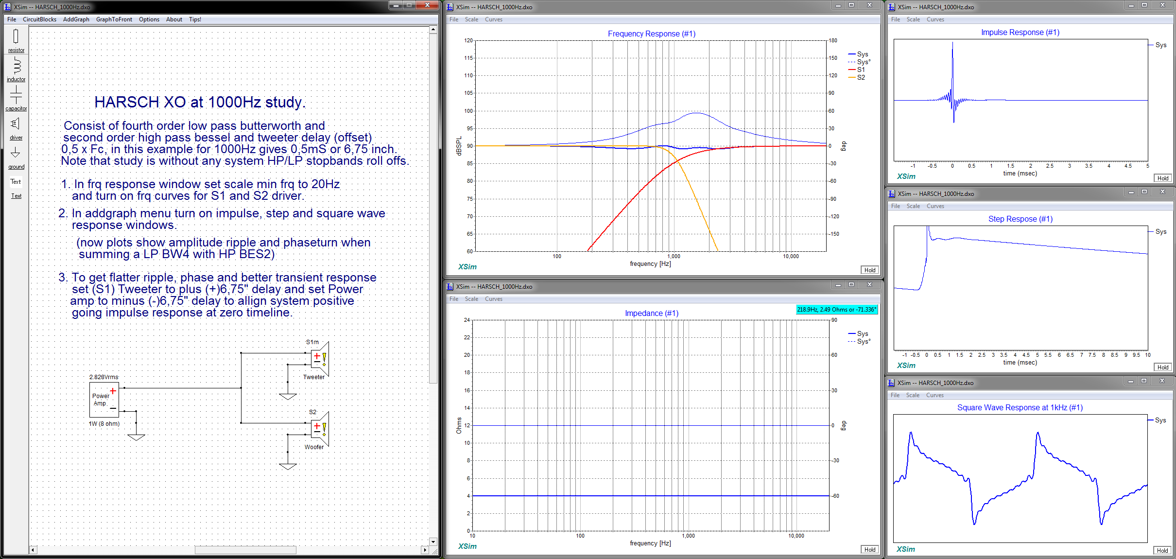

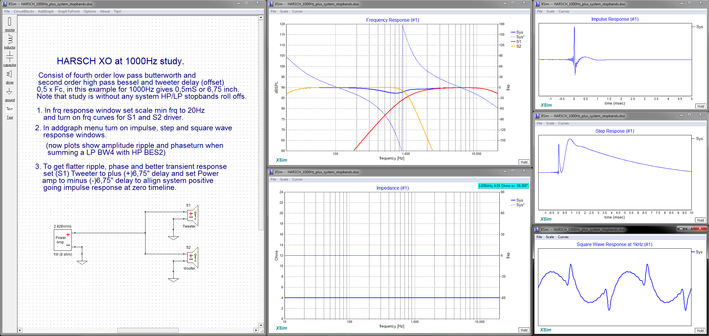

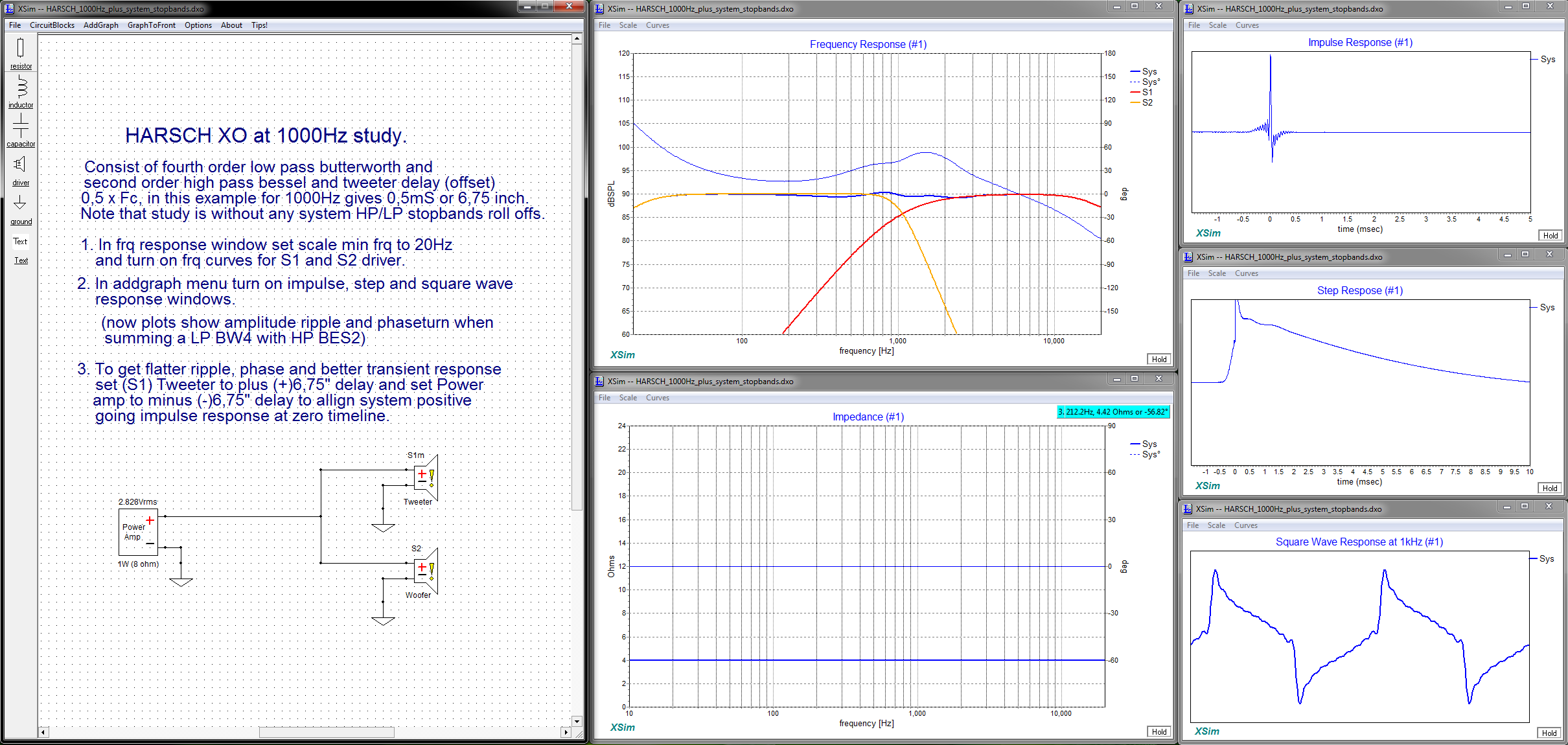

Here a fun HARSH study including two zipped attached files that can be opened in free XSim software (download here: http://www.diyaudio.com/forums/multi-way/259865-xsim-free-crossover-designer.html).
First two pictures with just XO point and infinite system bandwidth. Picture 1 raw LP BW4 and HP BES2 as they sum firing in sync without offset, picture 2 have 6,75 inch offset (0,5mS) for tweeter.
Last two pictures with XO point and system bandwidth limit in stop-bands at BW2 20Hz and BW2 20kHz. Picture 3 raw LP BW4 and HP BES2 as they sum firing in sync without offset, picture 4 have 6,75 inch offset (0,5mS) for tweeter.
Study was made by linking a frd-file with right slopes to each of the drivers.
Slopes was created in Rephase as IR wav-file imported to REW then exported as frd-file to link to drivers in XSim.
Have fun tweaking offset and on the fly see traces in plot windows change.
