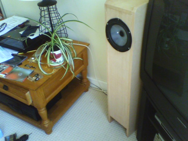

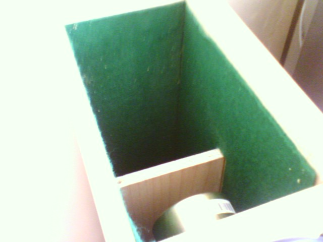

Im just in the process of building another pair of tqwt enclosures (old habits die hard), one is up and running for tuning and sounds superb.
The drive units are kef uni-q, a co-axial design. I have been playing with lots of damping material, and have found the best solution is a thin (1.5mm) felt or beize you know the pool/snooker table stuff, glued on the back and side walls best.
Anything in the line just killed the ambience factor for me. Original BR enclosure yielded 90db, side by side comparison indicates the new enclosure subjectively more efficient, with a much lower and deeper bottom end.
Will post some pics soon, incidentally, I am bi-amping with two stock SI t-amps.
Hope this is useful.
Both up and running, just a bit of subjective tuning (playing with ceramic tiles ie sinternal sound reflection), then varnish them up add grilles etc.
