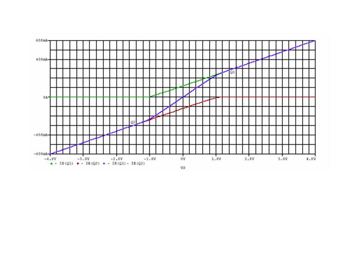

Is it really gm doubling or currrent halfing?
In a Class B amp, let's say that you apply a voltage such that the top device outputs just 1amp and the bottom is shut off. so the load gets about 1amp current.
In a Class AB amp (overbiased Class B amp), the samem voltage generates 1amp of output current. However, since the bottom device is conducting, it is (let's assume) sucking away 0.4amp. In this case, the load gets 1-0.4=0.6amp.
In this particular example, "gm doubling" takes away the output current from the load, and reducing the "gain" so to speak.

tlf9999,
I don't think that is the reason. In all the graphs you see on Gm doubling, it is a pair of curves giving the output vs input of each device and their sum. What is shown is that at the overlap, where both conduct, the sum curve gets double steepness > double Gm.
In your example, what would happen is that the top device would conduct 1.4 amp and the bottom .4 for a 1 amp output current. If it was as you say you would have very gross xover deadband, which I think is not the case in your bias example.
Jan Didden
Edit: added a typical 'Gm doubling' pic.

I think I know why. The absolute current in the crossover region is reduced: in your chart, Jan, the blue line (which represents the output current) is below (lower than) the green line which is the output of just the top device.
What happened is that gm is a dynamic idea: change in current divided by change in voltage. in the cross over region, the change in current for the same change in voltage is the sum of the change in current for the top device and the change in current for the bottom device. Thus, gm doubling.

No, not exactly. gm doubling is too simplified. gm changing is better. It also depends on the bias. It looks more like a wave or the overshoot of a step response.

Yes, the Gm doubling will be there. But Self sad, that Gm doubling results changes in the open loop gain, which can means distortion, or oscillation (increased feedback ratio). In my amplifier there is 5% of changes in the open loop gain if the load varies from open output to 4ohm. And this resulted by the VAS resistors.
Do You know any other effect of the Gm doubling?
