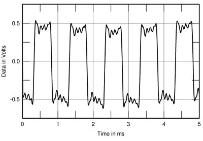

I believe Danley has stated that his Synergy horns can do square waves quite well. I've never investigated this claim in any depth but at this point I see no reason to doubt it. (These horns use moving coil drivers in a clever way to make them a truly point source integrated design.)
Have a look at this third party measurement of the Quad ESL 63 by stereophile.com for a square wave.
The image is also attached.
In my experience in the right position a good ESL will amaze anyone who has never heard them before, without exception, then they will say how they sound amazingly lifelike, and how the stereo imaging is unlike anything they have ever heard before from speakers, and the next comment will be how they are so BIG! Typical first next comment is could live with such big speakers? Can they have smaller electrostatics?

There seems to be something wrong with that software package or how it is being used. EG: the red and blue traces in the first two plots seem identical. Perhaps they use a single FRD shot and the offset is simulated? If so where does the listening position change during this? If it were a simple and symmetrical distance calculation where would the response variations be coming from.
(P.S the charts seem to have changed since I started posting but I can't see what has changed anymore)
