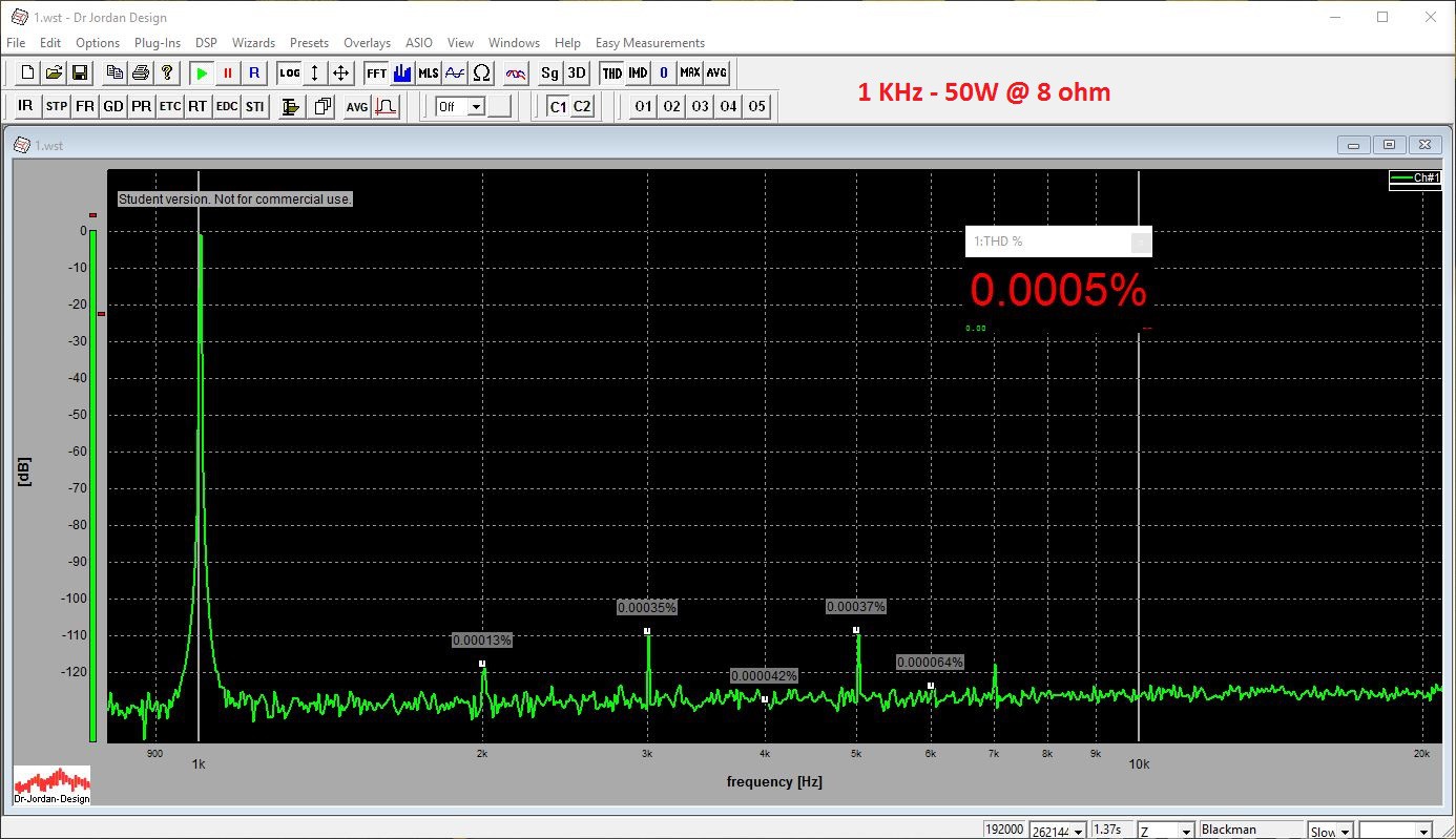

Just 2 cents from me - a very practical exercise (I was actually measuring an amplifier's distortion, but anyway...). Vertical CFA + NS-OPS prototype in my lab.
Attached is the spectrum, taken at 20V RMS, 8 ohm resistive load (50W RMS), behind the mechanical speaker relay.
If the relay adds some distortion at this kind of order - I'm fine with that :)

Hello,

Interesting, what charts do you get with bridged relais?

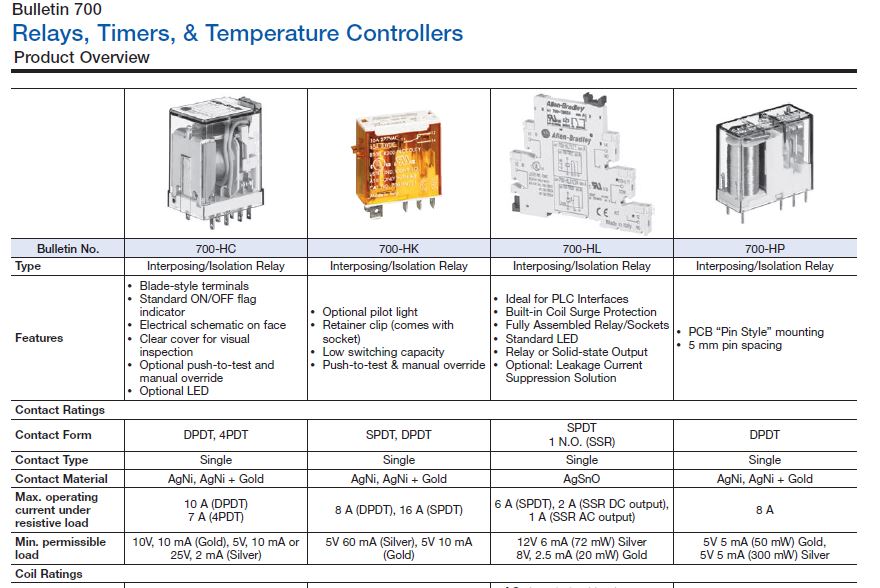

Once upon a time we used AgCdO contacts in power relays. They were very good for high power stuff bad for small signals such in a speaker. I chose to use silver for those applications. Nowadays Cd is forbidden so hardsilver is the replacement which works good I think. Hardsilver is a AgNi alloy.
