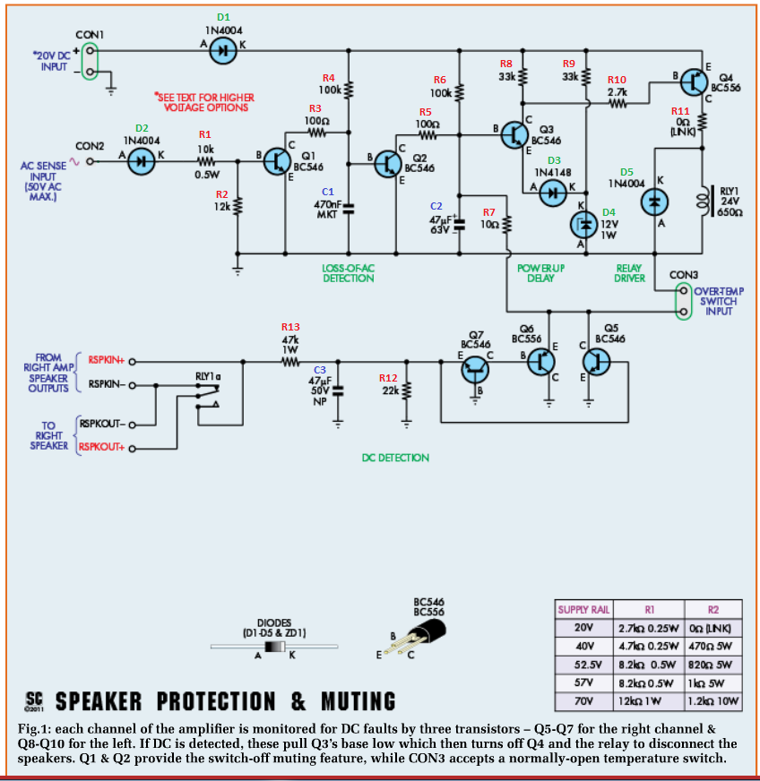

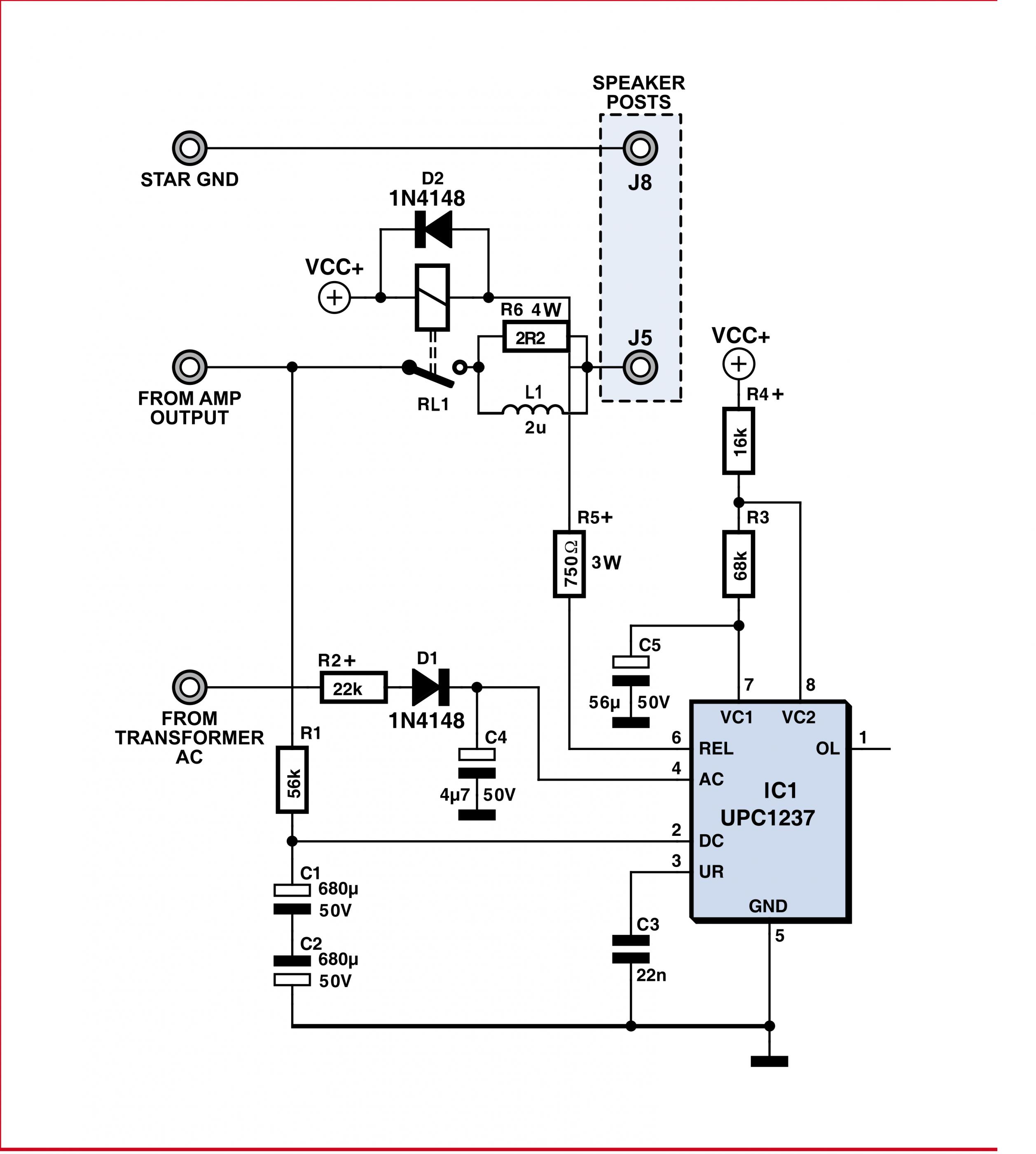

This diagram shows R5 and R11 [R11 being an unequal value to R5 makes it a Rc on the NEC diagram]
Note Cap is down to 220uF and polarised electro. Seems inappropriate to use polarised there.
Another diagram uses same resistors [referred to as Ra, Rb, Rc, not to be confused with designation on NEC diagram] Cap down to 22uF.
And another on this site [post#14] with both resistors in circuit and 2x inverse series polarised caps.
the easy question to answer is the polarity or not of the filter capacitor.
The input from the speaker is AC and during fault condition can have prolonged +ve or prolonged -ve coming in through the resistors to audio ground.
This fault condition will charge the capacitor to full fault voltage which could be as high as the supply rail.
On this basis the capacitor needs to be Bi-Polar of a rated voltage that exceeds the maximum supply rail voltage.
I use 3u3F MKT for this duty and adjust the resistor values to get the filtering where I want it.

You suggest MKT [non-polar] Andrew, whats the idea using 2x inverse series polarised caps as shown in post #43 ? Wishful thinking?
470uF+470uF + 56k gives an F-3dB @ ~ 0.012Hz
Are we supposed to copy that nonsense?
How long will it take for the 2Vdc fault to charge that capacitor and trigger the detection?
What if the polar capacitors leak a bit? Will the detection ever trigger?
Who draws these contraptions?
Who reads them without thinking about the consequences?

All good questions... I'm trying to make sense of.
Here is another...
Has anyone simulated or actual loaded fault tested the eBay offerings that have a standard electro 100uF / 50V there to see if they have any DC protection merit?
Might be ok for a while on an Amp that doesn't load above 50V DC under clip or short circuited devices...... but the DC load break capacity of relay is still dubious.
And, whats the reasoning in the NEC application notes that advise similar configurations?
Surely they couldn't have made such a basic error and haven't corrected it for so long, and still another manufacturer has a direct copy of the NEC data sheet.
Here is another...

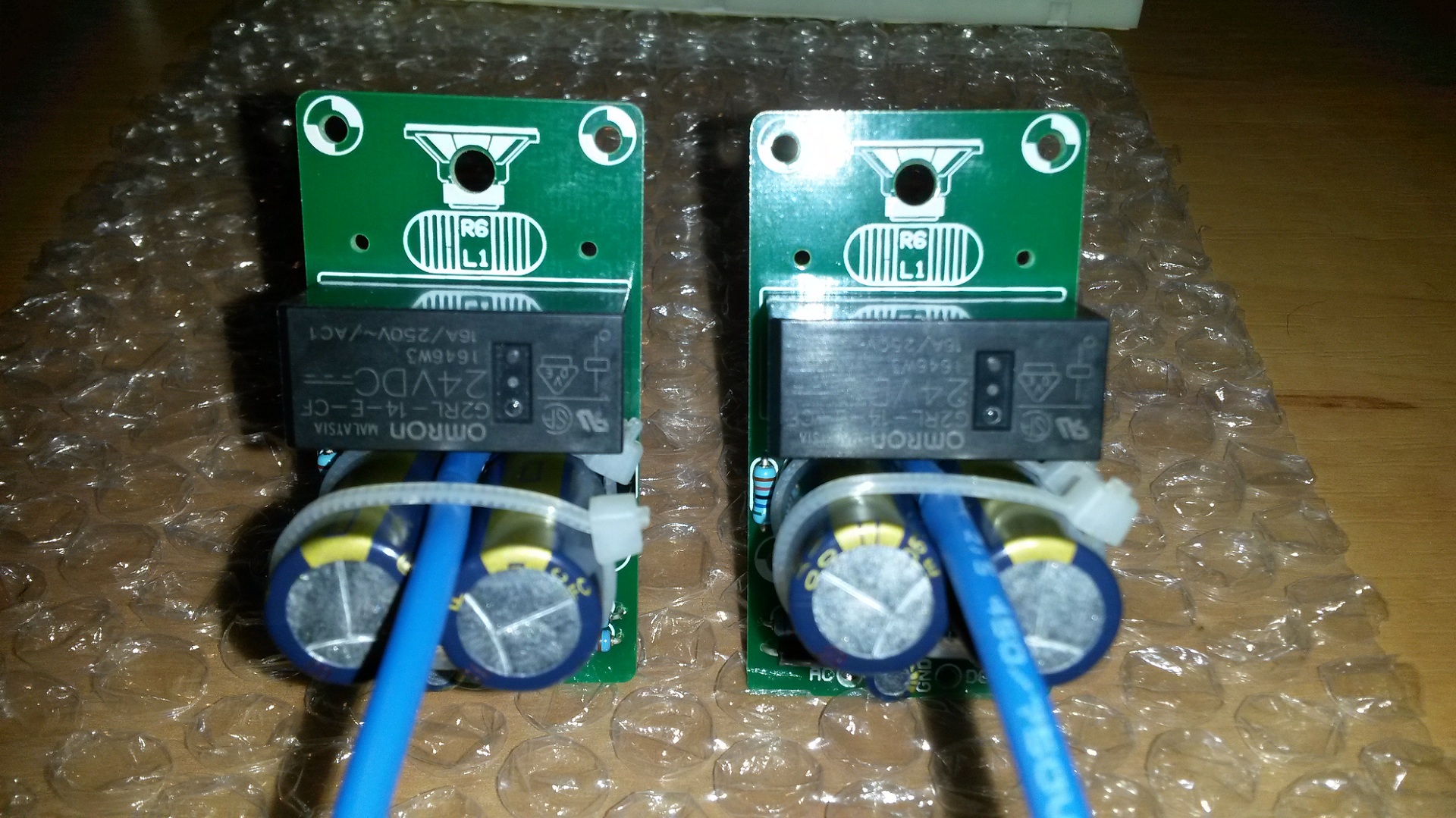

So, I have a quantity of modern metal/poly non sealed type caps that can be easily opened to find a bare foil cap with discharge resistor ready for removal.
I thought non potted off might be a bit 'ordinary', but these are approved for use in mains powered lamp fittings and I can't recall finding any over the years in a failed /burned condition... so seal seems not that important.
I'll post an image this weekend.
Question is... have these type caps been used in an audio application rather than their intended application? If not why not?

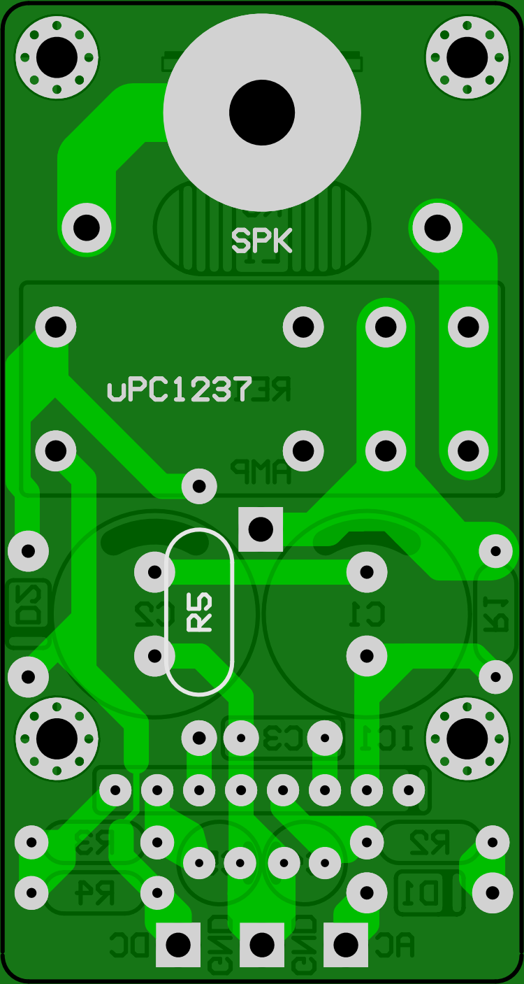

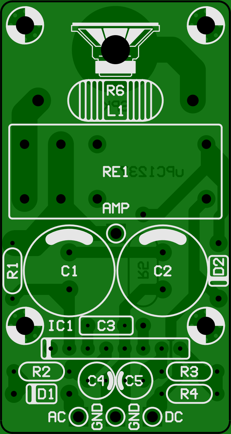

I know that this is a "old" thread but i im posting PCB files from SC if someone would like to build it.
Thanks robydream for sharing. Do you by chance have any updated version and would this work with a high powered class-A amplifier as well? What have you used for the temperature switch? Cheers
