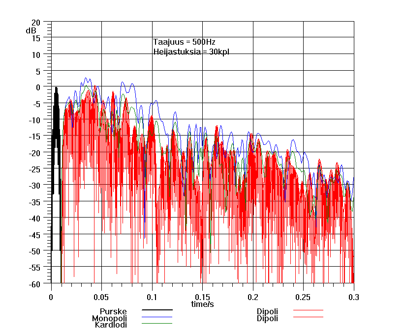

Let me present some results from time domain room simulation.
The room in question is 7m*4m*2.5m (length*width*hight) in size. The 4m wall is the front wall. Loudspeaker is place 1m from the front wall and 0.5m from side wall. Listener is placed on the longitudal mid axis 3m from back wall.
Reflection coefficients of walls, ceiling and floor are between 0.8-0.98 (wood and concrete).
This simulation contains >220000 image sources.
Loudspeakers included in this simulation are monopole, dipole and cardioid (placed at the same position). The loudspeaker model contains only the directivity pattern without other features. Main axis of dipole and cardioid is pointing to the listener.
The input signal is 5 cycles of raised cosine envelope sinudoid at simulation frequency.
First simulation is at 400Hz, so input signal duration is 12.5ms (black in colour).
The direct sound will arrive to the listener at about 10ms. Directly after this monopole (blue) response will expand heavily as more reflections arrive to the listening position. Cardioid (green) is somewhere between monopole and dipole.
- Elias

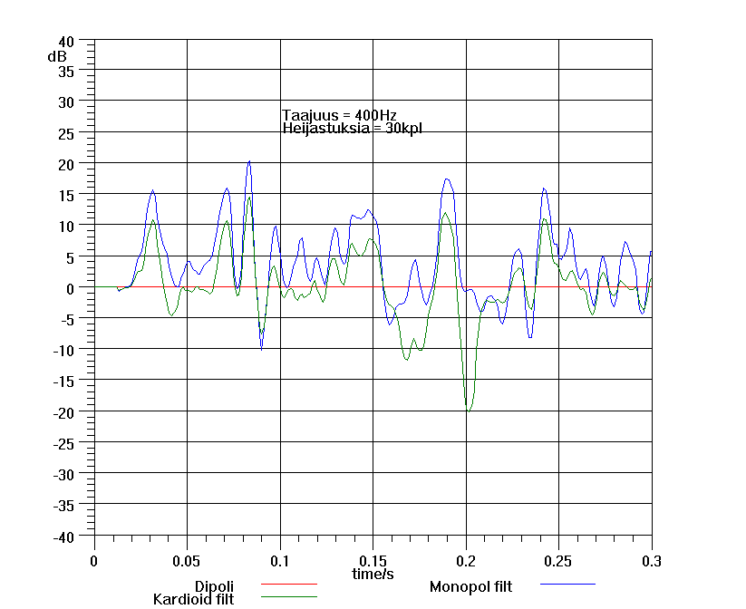

This is the same 400Hz simulation but now the envelope of monopole and cardioid room response is compared to that of the dipole which is referenced to zero dB. This will tell how much higher monopole and cardioid reflections are compared to dipole.
Even the direct sound 10ms-20ms is at the same level for all the sources, monopole room reflections are much more higher level than those of the dipole. Monopole reflection are constantly 5-10dB higher. Cardioid is little bit better than monopole but not much.
- Elias

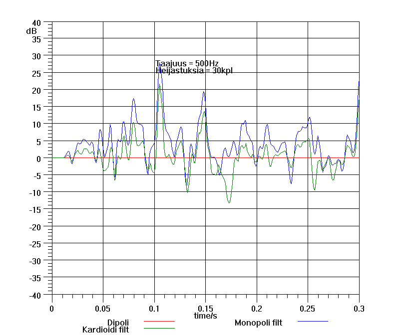

And here is the comparison of envelopes.
The small bumb at 10ms-20ms is the direct sound.
Pay attention how much higher monopole room reflection levels (blue) are than dipole (red).
Cardioid (green) is not much better than monopole but slightly better it is.
High level of monopole room reflections will mask the fine detail the poor listener is trying to resolve from the recording at the listening position!
- Elias
Elias,
thanks for your interesting presentation. But I need some further information to get really useful results from it.
You say: "The loudspeaker model contains only the directivity pattern without other features. Main axis of dipole and cardioid is pointing to the listener."
So am I right that you are operating with point sources? If the sources would be real world drivers and speakers you might have needed a main axis for the monopole driver too?
From a very subjective first look I thought that your choice of source positions would penalize monopoles because of the immediate first sidewall reflections. Don´t you need to provide a "monopole-friendly" alternative, maybe with 1 m side distance and 0.7 m to the back, to give the full picture?
Referencing your preferred response to zero dB to show the deviations of the others is a real sleight of hand. Sorry I have to say that. At least I need it the other way round too (monopole as zero) to see more than what I am forced to see.
Your diagrams could be a good start to discuss the pros and cons - if first we could get rid of the obviously inherent bias.
Rudolf

Hello Rudolf,
The monopole in this simulation is an isotropic radiator. If a monopole would have some directivity then it would not be a monopole but a cardioide.
About the 'monopole friendly' position, if you think you'll understand that the first sidewall reflection arrives to the listening position _during_ the exitation of the input signal. Remember the input signal for 400Hz was 12.5ms and during that time sound travels more than 4m. So in this regard the result will not change by repositioning the monopole since the monopole response will sky rocket after 20ms because of multiple reflections summing up. You cannot avoid these multiple reflections by positioning monopole differently in this size of a room.
Dipole response instead does not expand because it has directivity and amplitude of the reflections are much smaller.
Referencing dipole response to zero dB is a natural thing to do since it will show the correct direction of things, dipole response will not expand above direct sound but monopole and also cardioid do so the picture shows the correct relations since the direct sound will be close to zero dB as well.
- Elias
