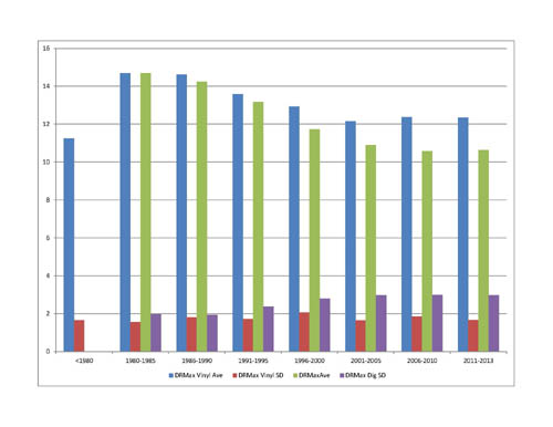

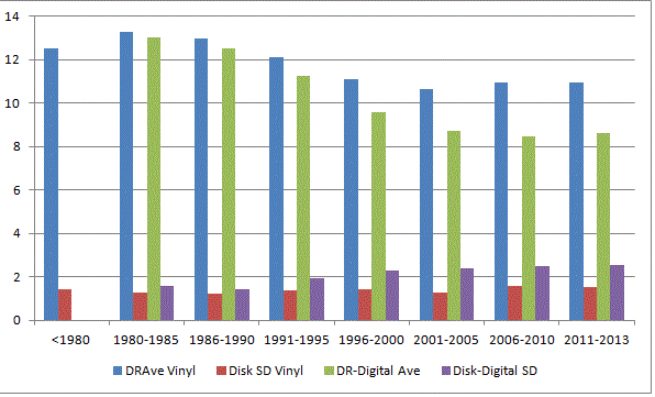

The first area investigated was album vinyl vs. digital DR average values spread by year of release.
![DRDB_Vinyl_vs_digital_timeline.gif DRDB_Vinyl_vs_digital_timeline.gif](https://www.diyaudio.com/community/data/attachments/357/357532-b7fe1cbb027393af5e0cde889e85e3d5.jpg)
The blue bars coincide with the average of ripped vinyl albums, and the green bars indicate population means for digital media (CDs, SACDs, DVD-As, mp3s, etc.). The short bars are the standard deviation of each population. Note that even the CD format has at least 30 dB more signal-to-noise ratio (SNR) capability than does vinyl, but as can be seen here, no attempt to use this added capability by most record companies, with some notable exceptions from small recording firms such as Sheffield Labs, DMP, etc..
Next a plot was generated using only reported maximums for each album/CD/digital track, by year of release. The following plot also indicates that even the "uncompressed" tracks relative to vinyl are compressed or recorded in the far field relative to live performance dynamic levels:
![DR_Max_Vinyl_Digital_timeline_cor1.jpg DR_Max_Vinyl_Digital_timeline_cor1.jpg](https://www.diyaudio.com/community/data/attachments/357/357310-1a02eab8dbe942cdc4f5afa1b772e0ec.jpg)
[comment]Note: It was noted by one former recording engineer that about the time that CDs came out in late 1984, the large studios studios began to use near-field monitors for recording and mixing. These speakers have a sensitivity of around 86 dB or so, so therefore they can't reproduce the dynamic range of the soffit mounted monitors that they replaced. This seems to coincide with a general reduction of DR on all consumer formats as studio use of near-field monitors became prevalent.[/comment]

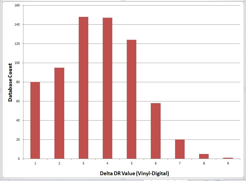

Another slice was performed on the data to find the differences in DR ratings between vinyl and digital copies of the same album/CD in those instances where both vinyl and digital DR ratings were found in the DR Database. All of these data values were then filtered for only those released in 1992 or later, which by inspection is about the starting year of serious Loudness War compression for many pop and rock artists. The resultant data showed that 86% of the time, the vinyl version had higher average and maximum DR values.
Since the standard deviation of the differences in DR ratings between vinyl and the best digital values for this example was fairly large, a plot of the DR rating differences vinyl-digital was made and found the following:
![post-26262.jpg post-26262.jpg](https://www.diyaudio.com/community/data/attachments/357/357535-53e30cb8dd35ed3bdcf9a6590c0ba76b.jpg)
The bottom line on the above plot is: if you have a choice between vinyl and digital for a new release album, 86% of the time, the vinyl record will have a significantly higher DR rating. How much higher? By the plot, this translates into 2-3 dB extra dynamic range on average--which is actually a large difference if the music is compressed as on typical digital releases nowadays.

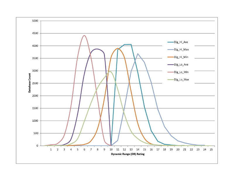

Another cut on the data, this time plotting the histograms for digital disks only, but split into two populations: one population below an album DR rating of 10, and the other population with DR ratings of 10 and higher (plot below). The idea is to see the relative count and value of these "two types of CDs". What was found was that for the data listed in the DR database, there are approximately equal numbers of "loud" and "quiet" CDs. Why did I pick a DR value of 10? Because the shape of the average curves for the two populations started to look like normal distributions instead of double hump/bi-modal curves.
![post-28404-1381985367116.jpg post-28404-1381985367116.jpg](https://www.diyaudio.com/community/data/attachments/357/357381-cfe7b372016f78aab8d09f8758e2be73.jpg)
The notion that "all CDs are loud" doesn't exactly hold water since there seems to be a bit more CDs/digital disks with average album DR ratings of 10 or higher as there are below 10. DR ratings of 10 correspond roughly to average-to-max dB ratios on each track of -13 dB. This means that the average dB level on each track has to be -13 dBFS or lower in order to reproduce at a DR rating of 10. If you are looking for an average DR rating of, say, 20, you would have to have an average dBFS level on your disc of -25 dBFS or less. That's a dramatic difference from the loudest CDs, which might have average dBFS values of -8 dB or even louder, such as -6 dB. (Remember that Red Book CDs can have average dBFS levels of -35 dBFS or lower and still not audibly affect low levels, or "quantization effects" at the low end of the scale. This means that the dynamic range of CDs is barely being used, even for discs with average DR ratings of 20 or higher.
It's been mentioned that certain types of music just don't have a great dynamic range. But note that even acoustic guitar DR ratings typically have very high DR ratings. In an example of a men's A Capella choir ("Cantus") with no apparent compression used during recording/mixing/mastering, maximum DR ratings of 17 are typical.
