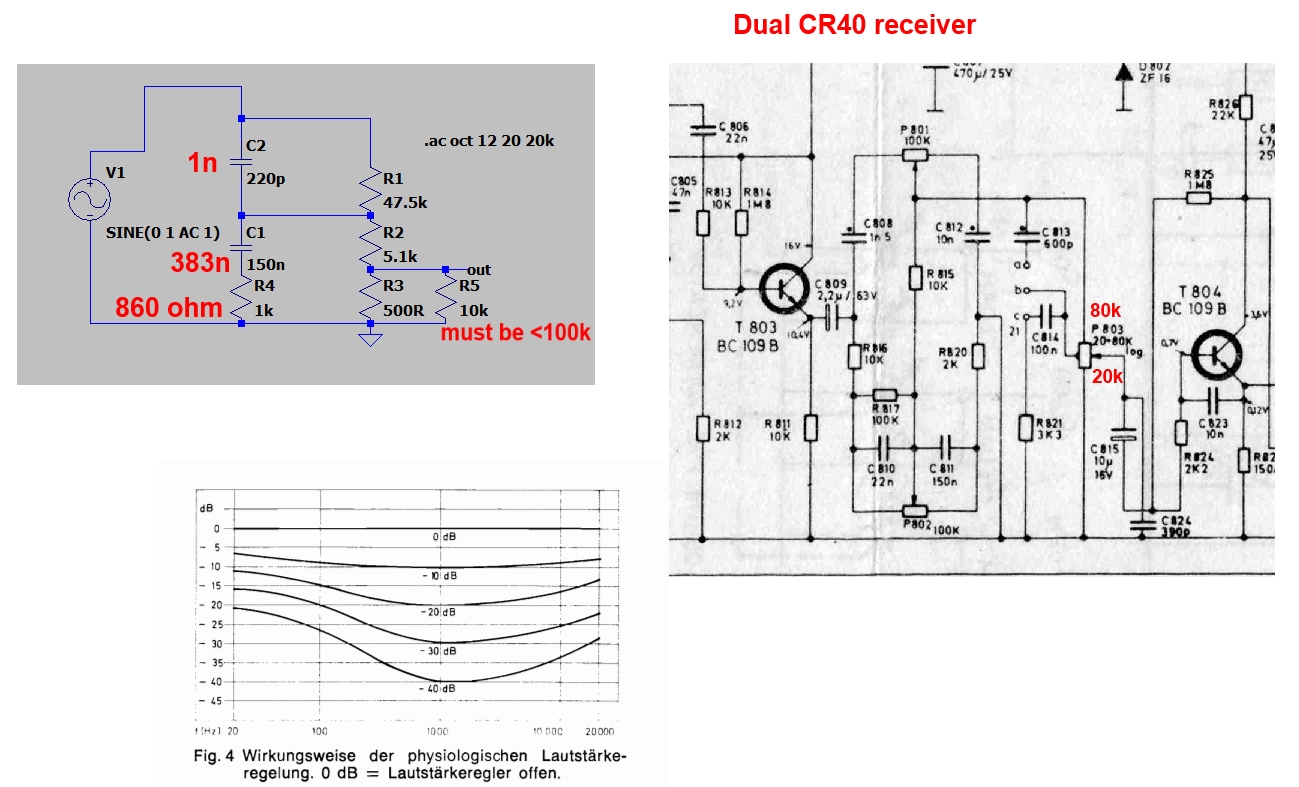

ubergeeknz you could be right, I am not sure that R1 must be 10% of total resistance, I follow someone else post about loudness here on forum.
Best will be to measure some volume pot with loudness tap.
On the net I found one circuit where upper part (R1) have proportions like in your schematics:
Avian’s Blog: Dynamic Bass Boost
And one schematic of some Dual receiver (Ei Niš licence, model HiFi 70), but it is unknown which part is 20k and which 80k.
Interesting. I'll try those values in the sim and see what the results are like. I did play around with them for best effect, but I didn't try going that low on R5.

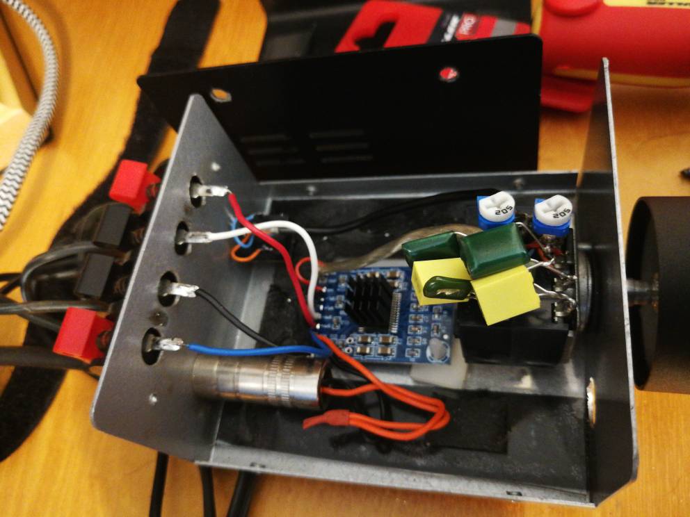

The amplifier itself (TPA3116d2) seems to have a fairly low input impedance, hence the 10k load in my sim. Real world measurements will confirm. I don't really want to go to the effort of adding a buffer stage for what is a very simple, compact setup for listening to a Chromecast audio at my desk while I work. Indeed I'll probably dead bug the loudness circuit right onto the pot.

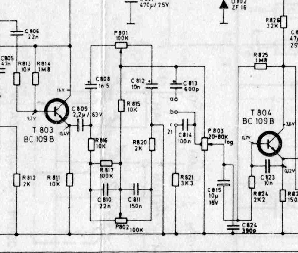

according the schematic underThis is 5 pin volume pot in Grundig SV 2000 amplifier.
Many Grundig models use that double loudness.
GRUNDIG SV-2000 GB U Service Manual download, schematics, eeprom, repair info for electronics experts
this is a two stage loudness control, i. e. two different attenuations anywhere in the midrange area, unfortunately dependent of the wanted SPL (adjusted by volume control 5-pin pot).
Bad in cases, when very low level and very high level sources listen.
How get I an appropriate circuit with same loudness character, if I want to replace this potentiometer R312/313 which have two taps (5-pin) against a normal three PIN potentiometer without taps and two additional potentiometers for adjust the two different attenuations in the midrange independent of the individual resp. wanted level attenuation ?
Thanks for advices.
