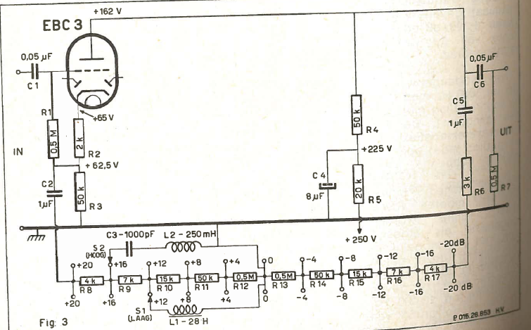

You could make a loudness-derived tone control, that is, a tone control of which the curves resemble the differences between the latest equal-loudness contours (ISO 226:2003).
If you have no objections against large inductors, you could try (or simulate) the attached circuit with the 28 H inductor reduced to 20 H and the 1 uF capacitors increased a couple of times. C3 and L2 are for treble and won't be needed.
The picture is the Viddeleer tone control that was rather well-known in the Netherlands in the 1950's, but I don't think anyone outside the Netherlands ever heard of it. I did some calculations on a simplified version of it, with R3 and R4 increased to infinity and the switched resistors resized, and at least that could match ISO 226:2003 rather well.

Was this another creation from Philips in Eindhoven, perhaps? It's incredible how many fantastic advances in audio were created by that one company....Viddeleer tone control...Netherlands in the 1950's
I don't understand the schematic you posted, yet. Feedback from anode to cathode? That should be positive feedback!
-Gnobuddy
No, L. V. Viddeleer worked for the PTT, the former Dutch postal, telephone and telegraph service. I have the impression that high-fidelity audio was a hobby for him. He designed and published a rather unusual, but very well-designed amplifier with this tone control.
The centre of the resistor chain is grounded, so the left part simply provides local series feedback at the cathode, while the right part loads the anode. It looks a bit like the dual of the Baxandall tone control, but not exactly.
The Baxandall tone control essentially has an impedance that converts the input voltage into a current and then an amplifier with shunt feedback that converts the current back into a voltage. The Viddeleer tone control has an amplifier with series feedback that converts the input voltage into a current and then an impedance to convert it back into a voltage. Baxandall uses capacitors, Viddeleer inductors.
The most important difference is that with inductors, the time constants tend to increase rather than decrease when you only want a small correction - although the bias resistors R3 and R4 disturb this to some extent. The cathode resistor R3 could easily be replaced with a current source, though.

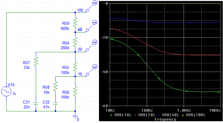

This is how Philips did it .... I'm too lazy to work out what at frequencies and volumes it's doing the shaping...
I threw it to the Idiot Assistant and got these shapes.
Slope approaches 7.5dB/octave on the lowest tap near 100Hz-200Hz.

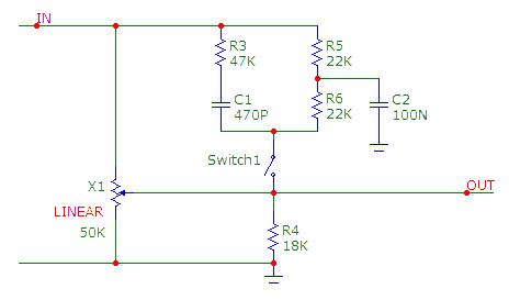

Has anybody tried this passive loudness circuit? I guess it has been mentioned before in Diyaudio. It uses a linear pot with a log-faking resistor. When the switch is on, lows and highs are boosted up to 0-6db depending on volume setting. Center frequency is around 1kHz.
I use a variation of this circuit in my main amp. Mine is a transistor amp, but component values may easily be adapted to fit for tubes.
It works OK, the sound stage brightens up, but you clearly notice the phase change when you push the button. Up to plus and minus 20deg shift at the lower levels for highs and lows respectively. If you insert a resistor before/after the filter its effect will be reduced.
