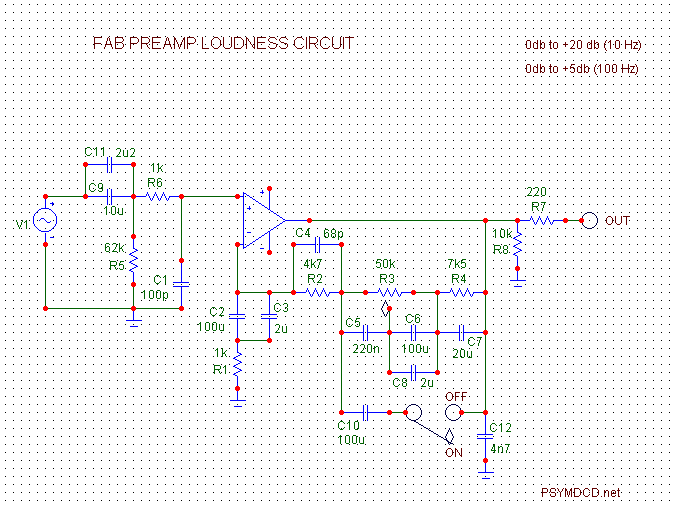

Loudness
This variable loudness is not a traditional loudness since the Loudness effect does not vary with volume setting control.
The pre-amp circuit includes a gain 5.7 without the loudness. When the switch is in OFF position, the pre-amp still give low sub-audio frequency a pre-emphasis allowing the phase shift at 10 Hz to be lower than 0.5 deg, thus the 10 Hz square wave is almost perfect.
I am very pleased with the result. If anyone has tried something similar or would like to comment...

fab
Joined 2004
if you want something w/o adding any active circuit in series in your existing system, use the circuit in post #7 where the loudness is included in your actual pre-amp (in the feedback path of your pre-amp, provided that is is a non-inverting one). You simply have to modify your pre-amp but ensure to put the potentiometer close to the pre-amo circuit to prevent capturing too much noise, thus locate the pre-amp circuit close to your pre-amp front panel where the pot is located...

Activ filter for loudness (50Hz and 15kHz)
Hi fab!
Is can offer circuit or schematics with an active filter that will be able to make the 15...16kHz gain of about 10dB at about 50...60Hz as reinforcements for about 10 dB, 1 kHz at a gain of 0dB.
Thank you and cheers!:cheers:

Hi picowallspeaker!
I need electronic circuit for loudness in the pre-amp with the above characteristics.:mad:
thank you!
