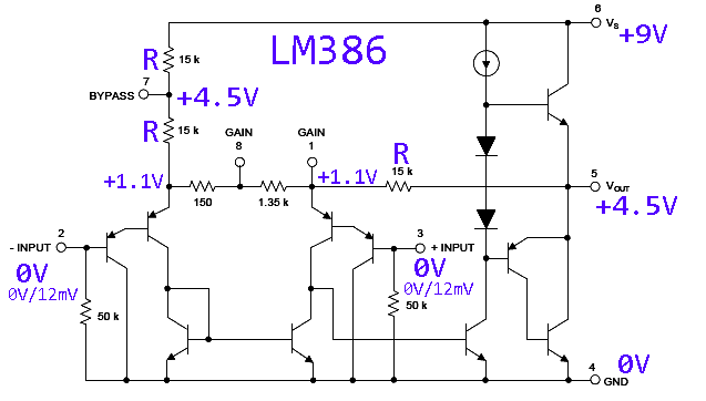

I'm more a LM380 man. But they share an interesting topology, worth knowing if you hang in this section. Been around since 1983 and has been a benchmark of low-cost audio for over three decades.
The inputs are PNP Darlingtons, which leaves headroom (boot room?) even with the inputs at Zero. An internal resistor zero-references the inputs if you do nothing else (or cap-couple). In this mode the bases actually float-up to 12.5mV, which works just the same.
The output is set to half-supply by the 2R-R network. There does seem to be a part-Volt error here. There's also part-Volt asymmetry in the output stage and these may complement each other; or the "15K" may be trimmed, or they maybe don't care (it is a pocket radio amp, not a precision lab/saloon amp).
The several "grades" of '386 are new since 1983, and are just voltage ratings. Being a VERY low-cost part, it was specced for the lowest voltage commonly fabbed (then). With the growth of fabbing, there is sometimes spare space in a higher-voltage process, and those are sold as "18V". However the device area, and dissipation ability, are the same for all the DIP parts: a half-Amp is all you get. This makes it pointless to go much over 9V for 8 Ohms loads (0.5A*8r= 4V peak, 8V peak-peak). FWIW, the original intent was 16r load on 9V battery, for good battery life with an economical voice-coil.
The app-notes always wanted a supply bypass cap "close" to the '386. Recently I am seeing reports of builds that work fine with older '386 but not with this-year's production, until an at-chip bypass cap was added (in addition to the explicit "bypass" at pin 7 to set gain correctly and reject supply crap). They maybe can't get the old/slow process any more, and new batches are too fast to be stable with old bypass habits.

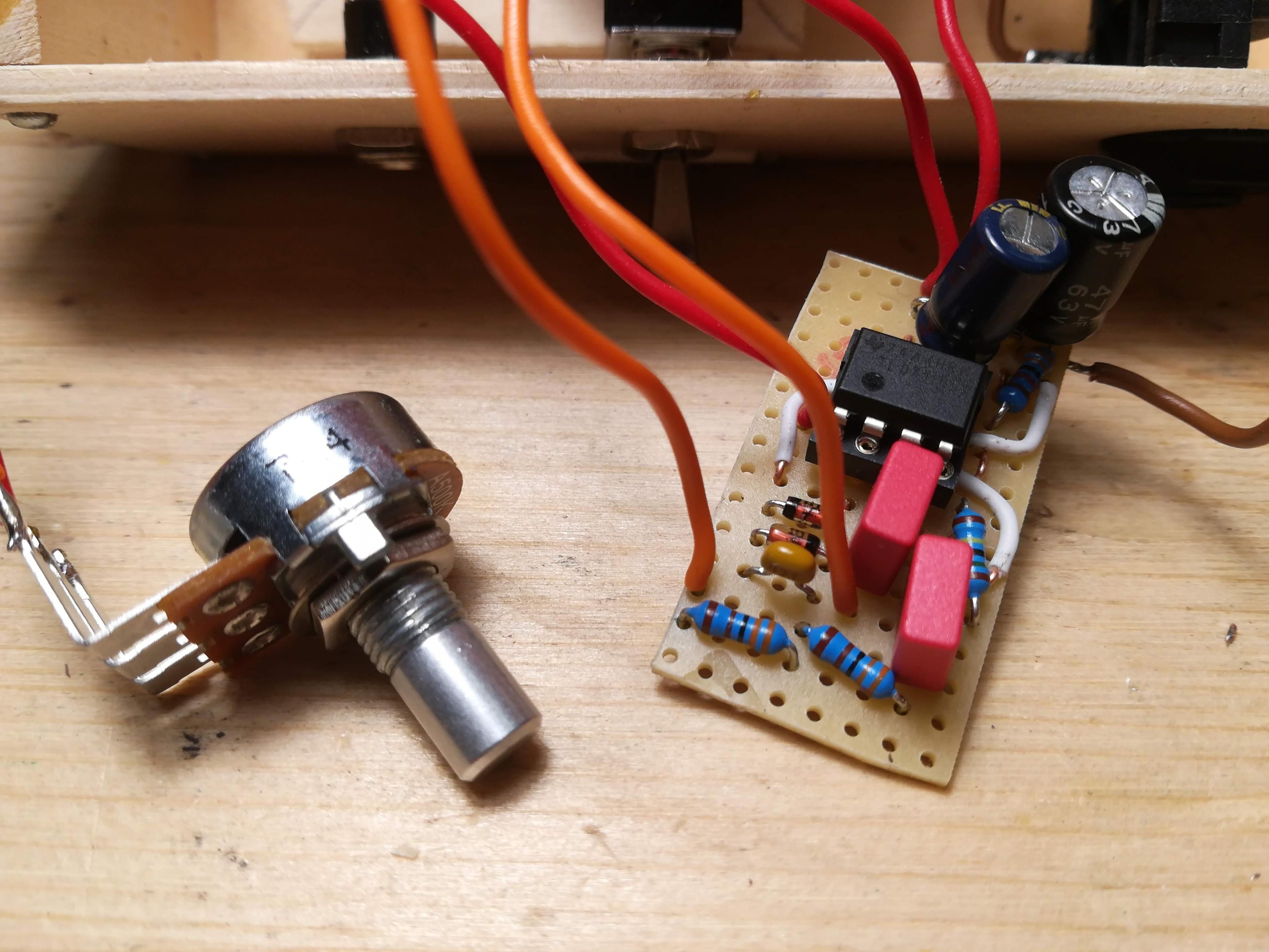

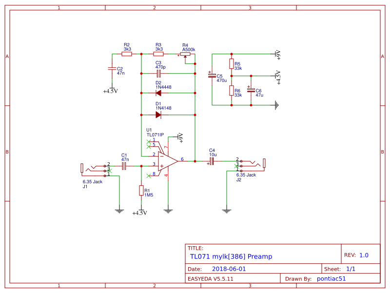

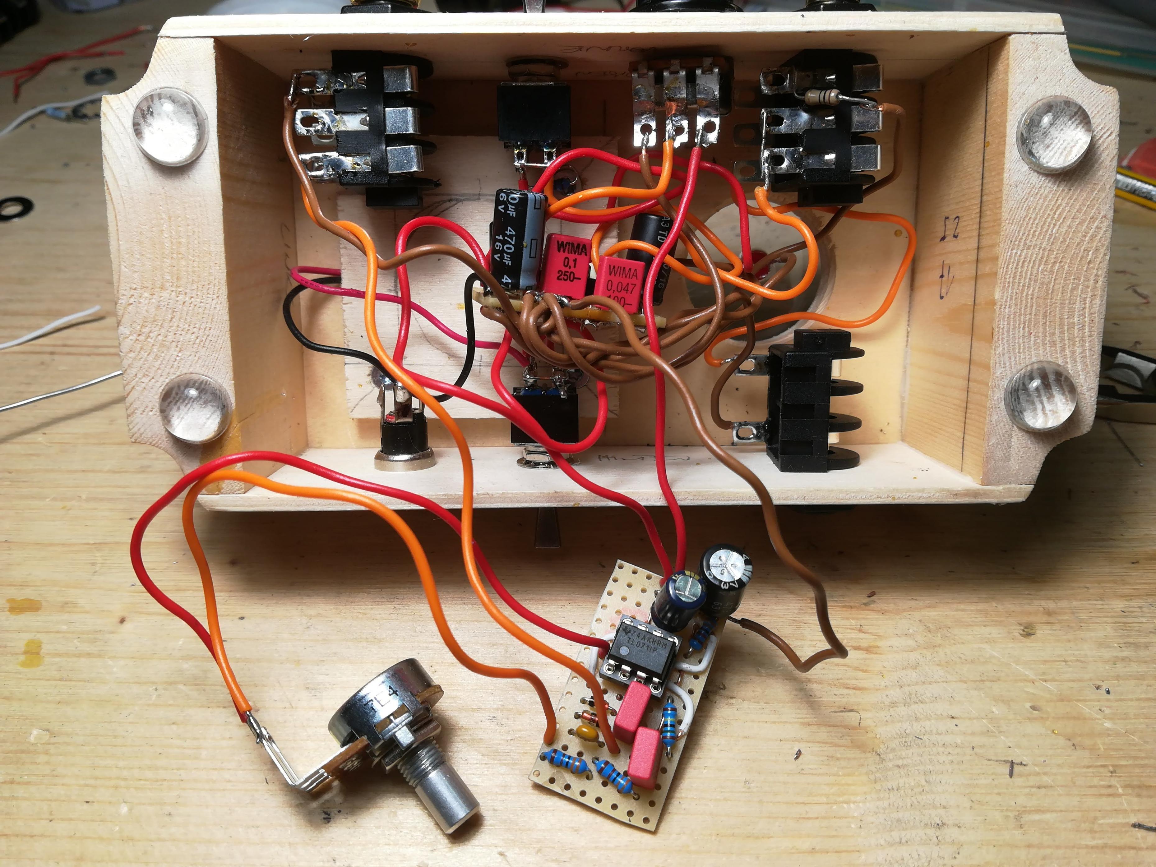

I did the preamp yesterday. It is a TL071 with Diode Distortion. I hooked it up with its own power supply at first, but will integrate it fully later.
I had troubles with some loose contacts and a faulty pot, but apart from that it sounds great.
And the crackles are gone. HOORAY! Simple reason being that the preamp now does the Distortion and I don't have to drive the Poweramp as hard.
I'll post a schematic later on, but it is de facto the preamp from the mylk386 amp. I just changed the cap on the OUT for a 10uF which sounded better to me.

:up: you really are after adding distortion to the mix and that's a classic type of circuit to do that.
Nice classic distortion circuit.
Small resistors in series with the diodes will "soften" the distortion. You can only try.

@ALL and especially Mooly: Thx for helping me out on this, I nearly gave up on this. But you solved it quickly for me. I have learned so much thanks to you.
Tomorrow I'll try to get me a nice box for this plus some proper batteries.
