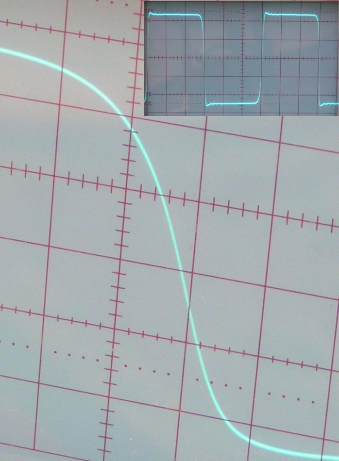

Toslink (SPDIF) always contains jitter, jitter amplitude isn't the biggest problem, it's jitter frequency spectrum. Using Toslink you have at least 2 jitter sources, source jitter spectrum and PLL jitter spectrum. When (synchronous) reclocking is used, the master clock jitter spectrum is added to the mix. This is basically a no-win situation that always includes making compromises.
Sure improvements can be made by using better Toslink cables (real glass fibre interlinks), and faster optical transmitters / receivers. But performance will always be less than optimal.
Here is a photograph of the recovered master clock from a dual SPDIF receiver (each receiver has different loop filter), both run in slave-clock mode. They are followed by a micro controller-based FFL VCXO. The scope is put on highest time resolution, and the oscillogram shows one of the pulses that follows the trigger pulse. The signal is measured directly at the DAC chip bit clock input. The electron-beam trace is blurred (photo camera). The actual trace thickness is less than a tenth of a millimeter.
This is the (worst case) starting point, this master clock still has way too high jitter, it's barely visible on the oscilloscope, set at maximum time resolution, yet it already has big audible effect on sound quality. I already use a NOS DAC that's least sensitive to timing jitter.
In order to maintain low (bit) clock jitter levels at the DAC chip internal circuits, I attenuate the master clock amplitude to approx. 400mV, and create a low load impedance (approx. 33 Ohm), this is possible with both TDA1543 / TDA1541A as these have TTL-compatible current steering inputs.
Still this doesn't solve the jitter spectrum "issue". Using a single master clock for both source and DAC, that are placed close together, and are connected through I2S is a good starting point.

In order to maximize 44.1/16 performance, we used 32 bits / frame (only sending the 32 bits that contain data for both L and R channels). As a result of this the bit clock could be lowered to 1.4112 MHz, providing even lower ground-bounce.
Both SD-card player and DAC chip share the same low-jitter master clock, introducing only intrinsic master clock -no source clock- jitter. The latest dynamic jitter attenuation circuits, placed in all I2S signals, can further reduce output sample timing jitter into the femto-second range.
In order to maximize performance (increase resolution), I also decided to skip (pre) amplifier and conventional volume control.
The balanced output DAC runs on the SD-card player, it drives HVIV converters, these generate up to 40Vpp output signal without using amplifiers. The voltage is generated by the DAC output current, running through a variable passive I/V resistor (volume control). The voltage across these I/V resistors then directly drives the unity gain bridge power buffers. These buffers then drive the speaker. This concept eliminates the amplifiers and related distortion. The circuit can be fully DC-coupled (balanced operation) so best possible transparency can be had.
The SD-card player, DAC, and unity gain bridge power buffers can all be placed in the same housing, also eliminating analogue interlink issues. This provides a one-box digital audio playback solution.
