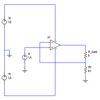

...and are we saying that "current amplification" is going to be different than putting a resistor in series with my big *** voltage amplifier? (big *** to assure sufficient swing to reach the same SPLs...)
...and does my "current amplifier" sit at a fixed output voltage and vary current with respect to the input signal? Curious about that point...
... do we have a schematic of a proposed pure "current" amplifier for audio? (there are some damn fast current op amps...)

I've attached a rough schematic of a pure current amplifier. Feedback is taken in series with the output via a resistor instead of in parallel like a voltage amp. It is possible to mix current and voltage feedback to acheive specific output impedances.

This is a point which causes much confusion. Current feedback as used in relation to op-amps means that the feedback node is low impedance, so the feedback signal is injected as a current with the feedback node sitting at a constant voltage. Current feedback as everyone else uses it means that the feedback signal is proportional to the output current, otherwise known as series derived feedback.
