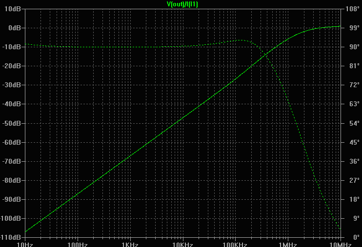

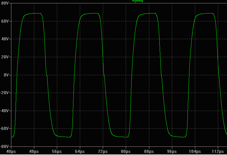

I'm not so sure it is unstable. Here's the latest closed loop plot I generated using a bit more compensation, 2.2pF instead of 1pF. From my limited recall, it appears that this plot has at least 45 degrees of phase margin.
I've also included the output impedance as well.
I don't really see any reason to drive 200KHz square waves with 10ns rise times. This amp is slew limited to somewhere between 40 and 50V/us. And with the input LPF, there's really no time it would ever see such rapid rise times. Even so, I went ahead and set time step to 10ns as well as the rise and fall times of the 50KHz square wave.
Output AC response phase at 1db gain may be different from OLG response especially at 10MHz and with phase lead compensation (1pF cap).
It looks like your circuit really is stable with this configuration, if you could manage parasitics. Changing the feedback network from 10k/300k to 1k/30k and the 1p cap to 10pF would help.

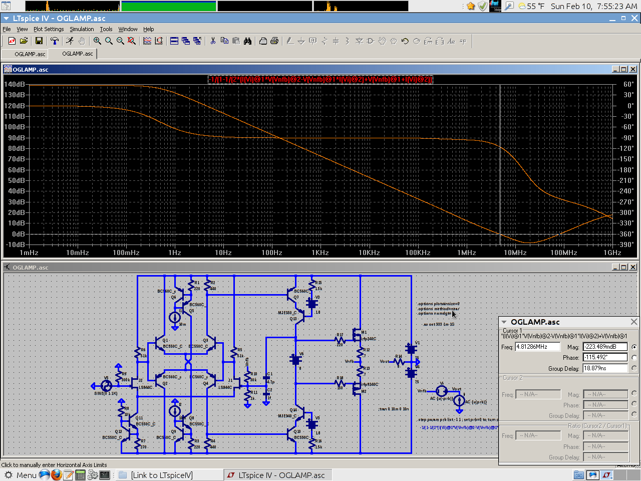

OLG@0db is -270 degrees which is actually +90 degrees. I need to review information on stability. At least it will be a learning experience.
Okay pete. I knew I was forgetting something. You can't measure actual in-circuit OLG your way because in practice, the total OLG is divided by the closed loop gain and this changes everything. That's why you MUST use the method in /examples/educational/loopgain2.asc from your LTSpice directory (comes default with the program).
So, the circuit IS theoretically stable. The loopgain analysis checks out.
The reason the 1.5k resistors are MANDATORY is that they eliminate the cascoding effect at RF so that the miller capacitance of the VAS causes stability. It is not obvious, but it works.
To generate loop gain, I put a 1F capacitor at the (-) input to ground to basically short it out without removing the DC portion.
I'll check out their suggested method and see if it does anything different.
Although Keantoken has given you the answer, the suggested method can go unappreciated, may I suggest you sneak up on it.
The 1F capacitor you used essentially also removed the miller compensation of the 1pF cap, as it too is now shunted to ground.
If you split R5 into 2 series resistors say 50K from the output, then place your 1F cap to ground and continue with 250K to the - input (to join the 10K and 1p miller cap) you will still have the miller capacitor in place. The resulting "open loop" should be a lot closer to Keantokens plot.
The next progression may be to insert an ac voltage source in series between the "out" and the right side of the R5 (301K) feedback resistor. Use this ac source to excite (set the input source to 0) and plot the ratio of the voltages on each side of the ac voltage source. This should get you even closer to Keantokens.
-Antonio

Ding ding ding!!! I can't believe I missed that. But you are exactly right. Adding the extra resistor in the feedback path before shunting the net with the 1F cap did match up with Keantoken's sim. The open loop picture I was looking at was wrong, wrong, wrong, at least with the FB compensation in place.
At least we know it's not the simulator not oscillating even though it supposedly should have.
Much thanks guys. Mystery solved.

I seriously don't understand the analysis method that Kean and most are using.
Still throwing a huge simulated inductor at my feedback path, to break the loop
for AC, without permitting DC to swerve into lala-land. From there, its easy to
compare input to output, and Bode plot the open loop gain and phase shift.
Between these methods, not really sure whats supposed to be the difference?
Kenpeter, the difference is the reason Peter's OLG plots were wrong at the beginning of the thread. The feedback loop modifies OLG; that is the whole reason opamps are either unity stable or not. When you close the feedback loop you subtract CLG from OLG. Poles in the CLG response affect OLG phase and so phase lead compensation is one way to stabilize an amplifier. Middlebrook et al developed the loopgain2.asc method to account for the affect of CLG on OLG.

I see the optimization of square wave plots as somewhat superficial because a subjectively pleasant square wave does not guarantee phase linearity. But I do think if you can make a circuit phase linear in simulation with known good models then the results should transfer to real life. It's often argued that ultrasonic and RF step response is not important but if we worry about it anyways I think it's phase linearity we should be looking at above all else.
