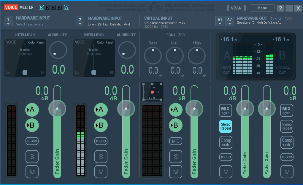

I tried a few things and i found that installing windows on my second (older) pc is the best option. on windows i have removed having to login and i have installed VoiceMeeter. i enabled 5.1 surround sound in windows (the most this motherboard can do) and selected the VoiceMeeter hardware input to be the line in(this is now a physical audio cable running from one pc to the other). on the hardware output i enabled stereo repeat so that the two channel input gets echoed to all 5.1 surround channels.
(current VoiceMeeter configuration)
i also installed equalizer apo since it can be used for every channel separately and has most basic effects and the ones that i am missing i can just download a vst for.
the only problem i could have in the future is if i ever want to setup an actual surround sound system. this could be solved very easily i can imagine, but i just don't know yet what software to use for this.
