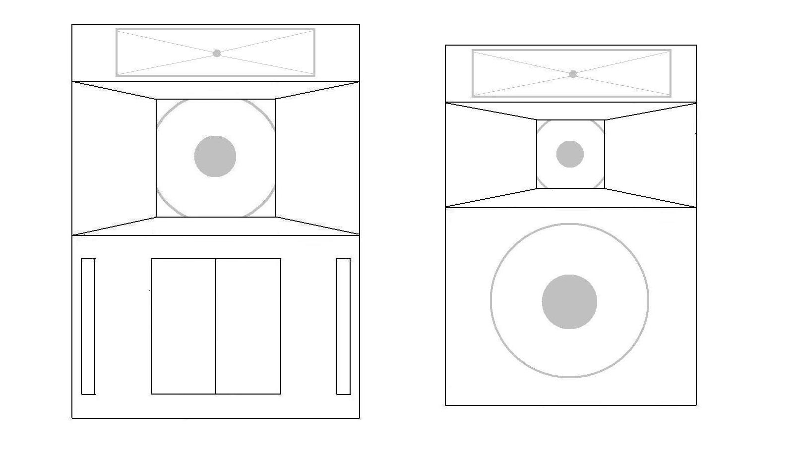

if you want it that loud, I made the plans for this, a while back
I dont know how it will work
but it will be loud allright

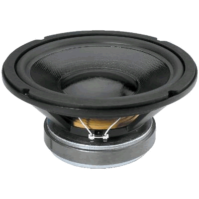

A nice keflar for closed loudspeaker Hivi/swans d10g.
images
The same from monacor sph-250ke
