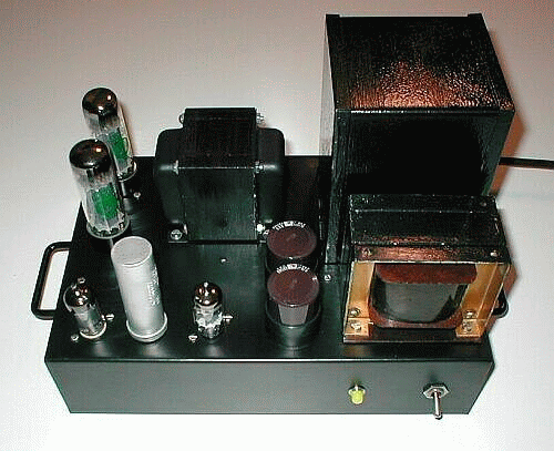

looking for ultralinear push-pull project
