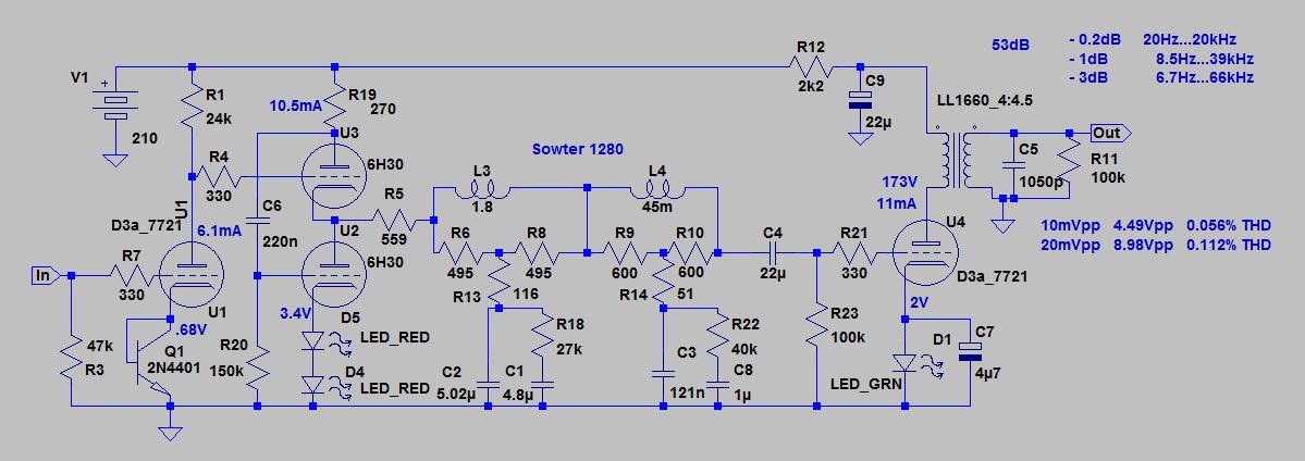

If I remember correctly, this schematic original was in Dave Slagle's forum:
:: View Forum - Phono
D3a as VAS, DC coupled 6N30P (russian 6H30) as CF (the another 6N30 half as active cathode load).
The output impedance only 41R!
Correct 600R loaded LCR, another AC coupled VAS stage with OPT.
If you don't like OPTs, try Aikidio.

What brand names and sound quality for tubes, for example: D3a Valvo and E810F Phillips SQ?
Same tube "sound quality" mostly depends of operating point and signal level.
I prefer D3a, E280F as large level VAS (100..180Vpp). Mainly use Siemens E280F (more detail), sometimes Siemens or Telefunken D3a (more dynamic).
Triode mode E810F is a good tube for small signal amplifiers .... but large signal operation distortion a bit high, in many case twice than the D3a or E280F distortion.
I have four Philips SQ, and two Valvo E810F pairs, best of them Valvo -green print Philips Herleen made :) -.

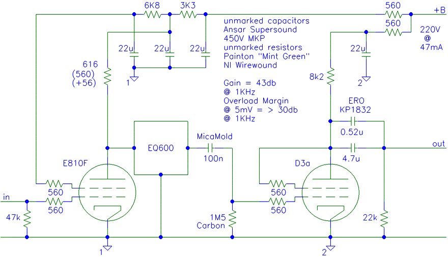

Same tube "sound quality" mostly depends of operating point and signal level. For Thorsten schematic
