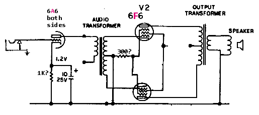

The physical layout is in the text you quote. The electronic design is simple. 6A6 drives an interstage which flogs a 6F6 team.
Key questions: are the field coil speaker and the interstage transformer in good working order? They can be replaced but not with original parts.
The 6A6 probably has a 900r-1K cathode resistor and little else. The 6F6es share a 320r cathode resistor, and may have a 2K screen resistor (or may eat full B+).
Input sensitivity may be over 0.5V, which will be "hard work" for modern guitarists accustomed to 0.020V sensitivity. (Distortion was still considered rude.)

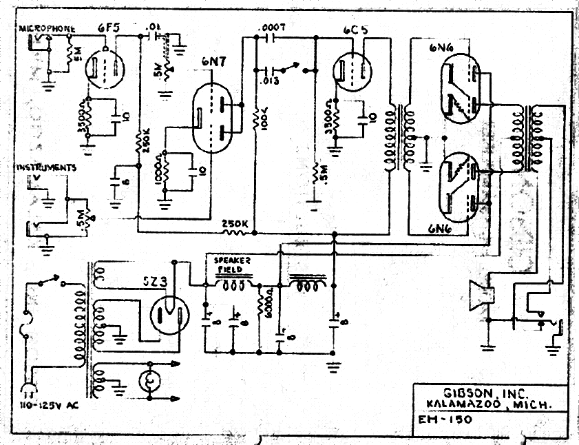

The schematic says 6N6 for outputs.
6N6G - Triode, Amplifier | Antique Electronic Supply
By coincidence, I'm working on a Silvertone 4590 which also uses 6N6 tubes. According to the 1946 Sylvania tube manual, the 6N6 is a dual triode with direct coupling from one section to the other, and is the octal equivalent of the 6B5. It is designed to run without any bias, so a 6V6 or 6K6 would probably work if you lifted the cathode from ground and used the correct cathode resistor and a 20 mfd bypass capacitor. Use a 270 ohm 1 watt for the 6V6, and a 470 ohm 1 watt for the 6K6. The 6N6 should still be available from AES, Radio Daze

So I am missing something? Is the schematic representative of the amp or is there another we are following? 6F6 is not a 6N6. I have nothing against 6F6's as I have two pair I want to use eventually. I am just confused.
I am confused too.
The OP says he has the interstage which would indicate the first schematic and 6N6's. But goes on to say he has the second iteration of the amp which has a paraphase splitter AC coupled to 6L6's:Popworm:

First: at Gibson, "EH150" meant as much as Ford's "Mustang" or Buick's "Special": badges that got applied to MANY different products.
Second: e-guitar was JUST starting; so were LOUDspeaker radios (from which g-amps got their parts). There was a fad for Hawaiian guitar, which was OK on a quiet beach but not in a drinking house. The amplifier brought the tiny-body sound up to near the level that an acoustic big-body band guitar could do. That was a start but soon players wanted much more gain. Also the fashionable/cheap power tubes changed every other year. So there's at least three quite different "EH150" in the 1930s. The plan in post #2 above is apparently not David's.
Please re-read post #3, which David says appears to be what he has.
"...either a glass 80 or metal 5Z4 rectifier. Twin 6F6s for the power were mounted catty-corner to the right of the speaker with a shielded 6A6 preamp in the front right corner. This triode (actually twin triodes in parallel for Class A operation, as specified in the RCA tube manual) was fed directly by the parallel inputs and was all she wrote in the preamp tube gain department.... The paralleled plates in turn directly fed the phase inverter, .... performed by a transformer of the center-tapped secondary type, which stepped up the voltage negligibly while providing equal but opposite signal to the power tubes."
That's my hack-up showing 6F6 finals. I'll include a couple later "EH-150"s that added another gain stage for instruments, but two different final tubes. (6N6 is indeed an oddity.)

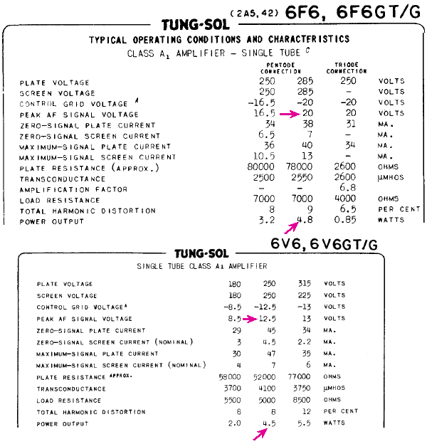

....Type 6F6 is a general-purpose audio output pentode..... roughly similar to ...6V6 but it was considerably more sensitive and could be driven directly from the detector output, thus saving one stage of audio amplification.
You don't cite a source but this tidbit is just wrong. 42/6F6 needs ~~1.5X the drive, is noticeably less sensitive than 6V6.
There were European power tubes of high sensitivity to avoid one stage of audio gain. In the US this practice was nearly unknown, unless you got down to 3-tube reflex radios only good for very local stations. In Europe the stations are crowded together and you don't need a lot of gain to make a mess of interference. In the US it was common to pull stations from 900 miles, gain was useful, audio gain is cheap.
