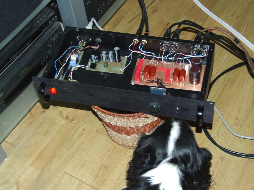

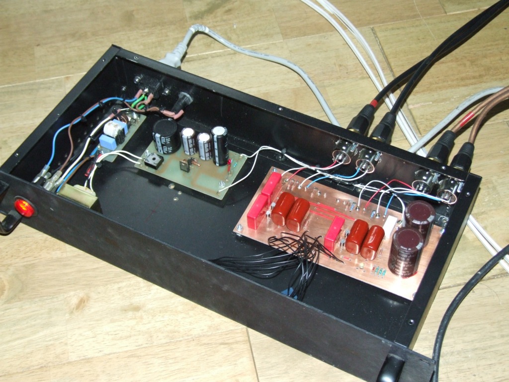

If I plug CD player directly into Aleph 4 it is just ALIVE there is no other way to descibe it.
The dynamics are fabulous and it is a pleasure to listen to.
With a passive volume control it lost some of its magic so I tried the B1.
Much better than the Pumpkin in terms of ease of use - SILENT in operation. BUT the Pumkpin has an electric edge that just brings everything to life.
DSIR9277.JPG I built my own B1. Its ever so easy.
