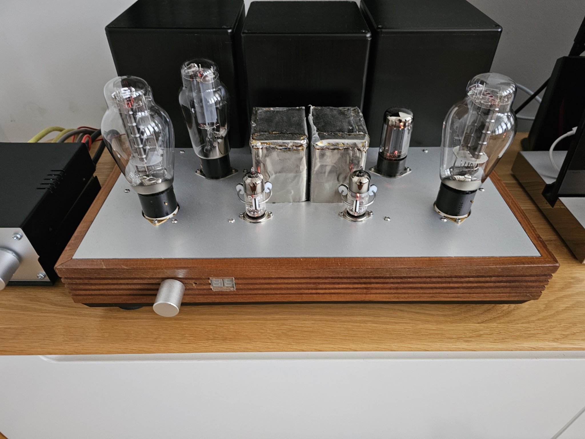

I am thinking to convert my 3 stages amp ( D3a 45 300B ) in to 2 stage D3a-300B Interestage Transformer Lundall LL1671 ( 1:2 configuration ). I would like to have less background noise and I think by avoiding the 45 it could happen. Would I have enough gain with the D3a 1:2 IT 300B coming out of a 2v Dac?
I know there is some D3a 300B amps , but someone tell that is not enough the D3a swing.
Using a D3A in combination with 300B and it is working perfectly.
Want to try Siemens E280F with the 300B, don;t know if anybody is using this combination.
Is it a drop in?
