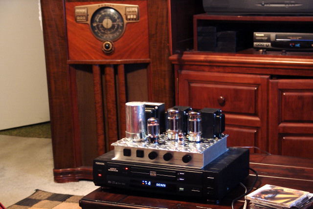

I have a pair of Yamaha NS-10M studio monitor speakers (86db) which work well with this amp as near field monitors. They are sufficiently loud in my lab, but the sound is not loud in the next room.
On the other hand, I built a pair of speakers by puting some modern Silver Iris 15 inch drivers into a pair of 65 year old Zenith console radios. These drivers are designed for open baffle mounting. They are about 96db efficient, the bass does literally shake the walls. With my KT88 amp in triode mode they sound really nice for anything from Norah Jones to Metallica. When I run it in UL mode with CFB (14 watts), It can be plainly heard in the living room of the house across the street!
The amp is shown in the foreground, with one of the speaker cabinets behind it.
To triode wire a KT88, yes put a 100 ohm resistor (1 watt or more) from the plate to the screen grid (G2). I have had 1/2 watt resistors fail.
