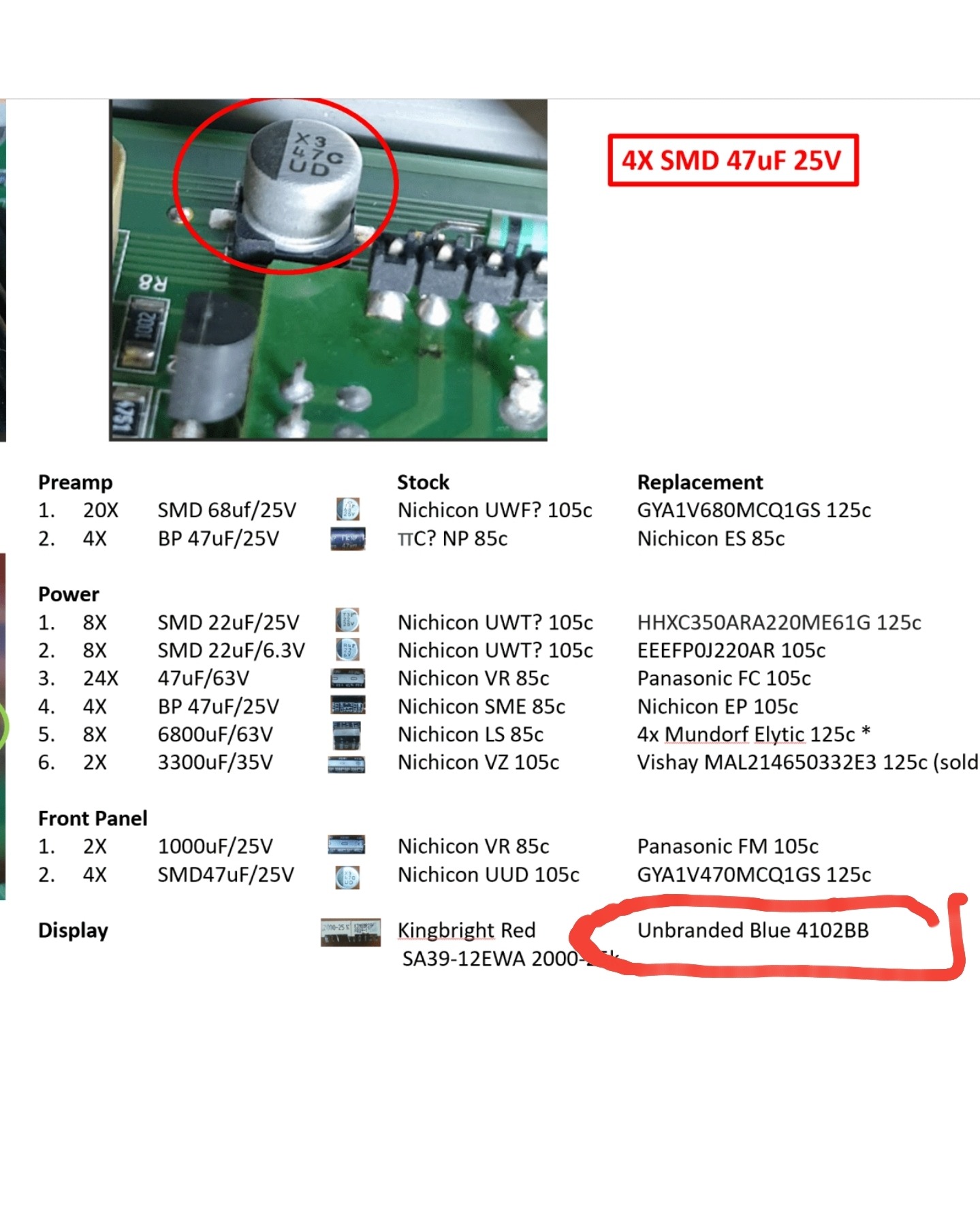

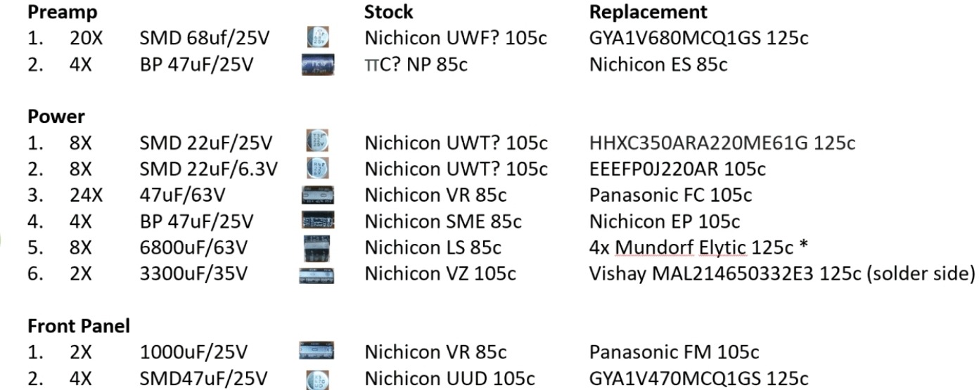

Hey Dan, how is your journey so far ? As you dun even have to spend on outside repair shop to recap, I strongly recommend you to do so and do consider same high temp hybrid polymer ones and upsized mundorf caps.
Cheers.
Change ALL capacitors !
In my 400xi, ALL were measured moderately to severely bad.
It was a timebomb. Now it is as new.
No signs of overheating in the past.
Clean the PCB professionally.
Long story short: do the total refresh if you want to use it for another 20 or so years.
It's worth it !
At least it is to me.
Cheers!

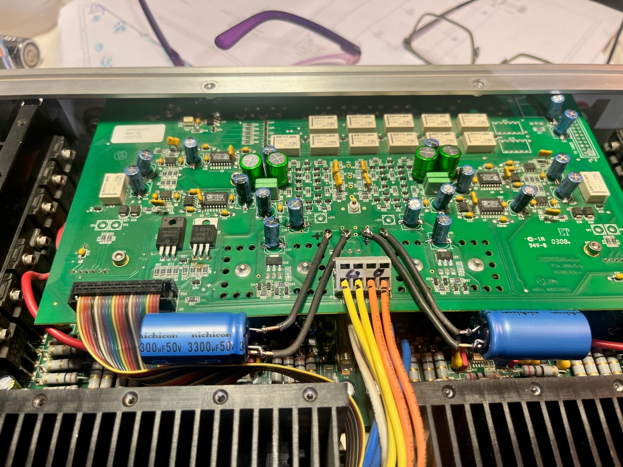

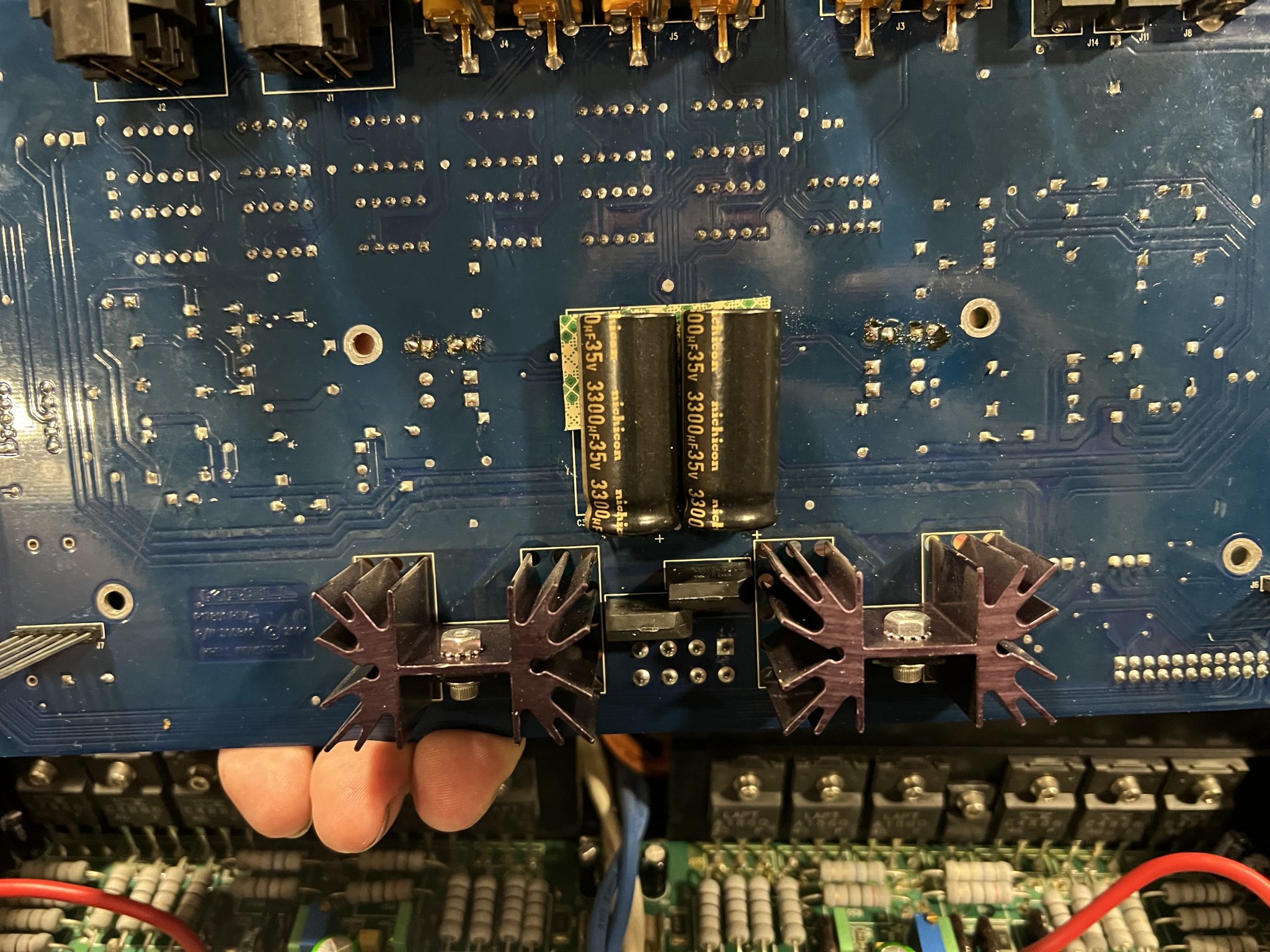

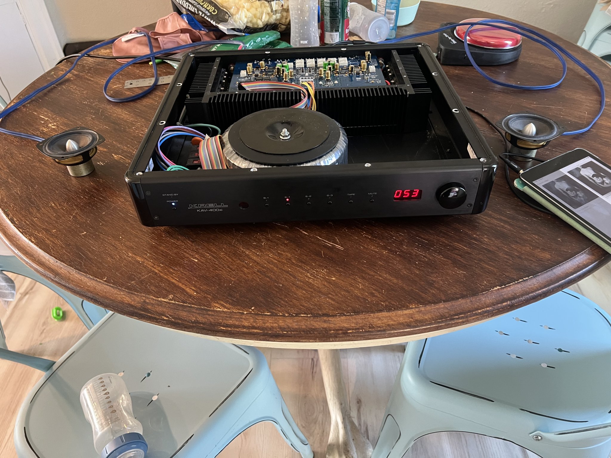

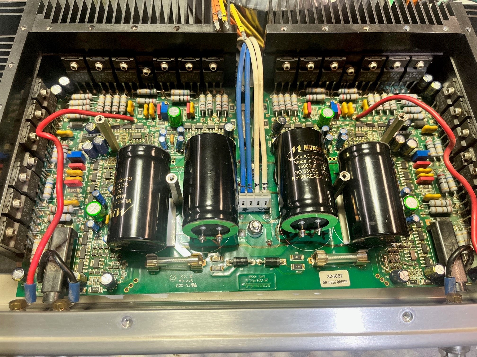

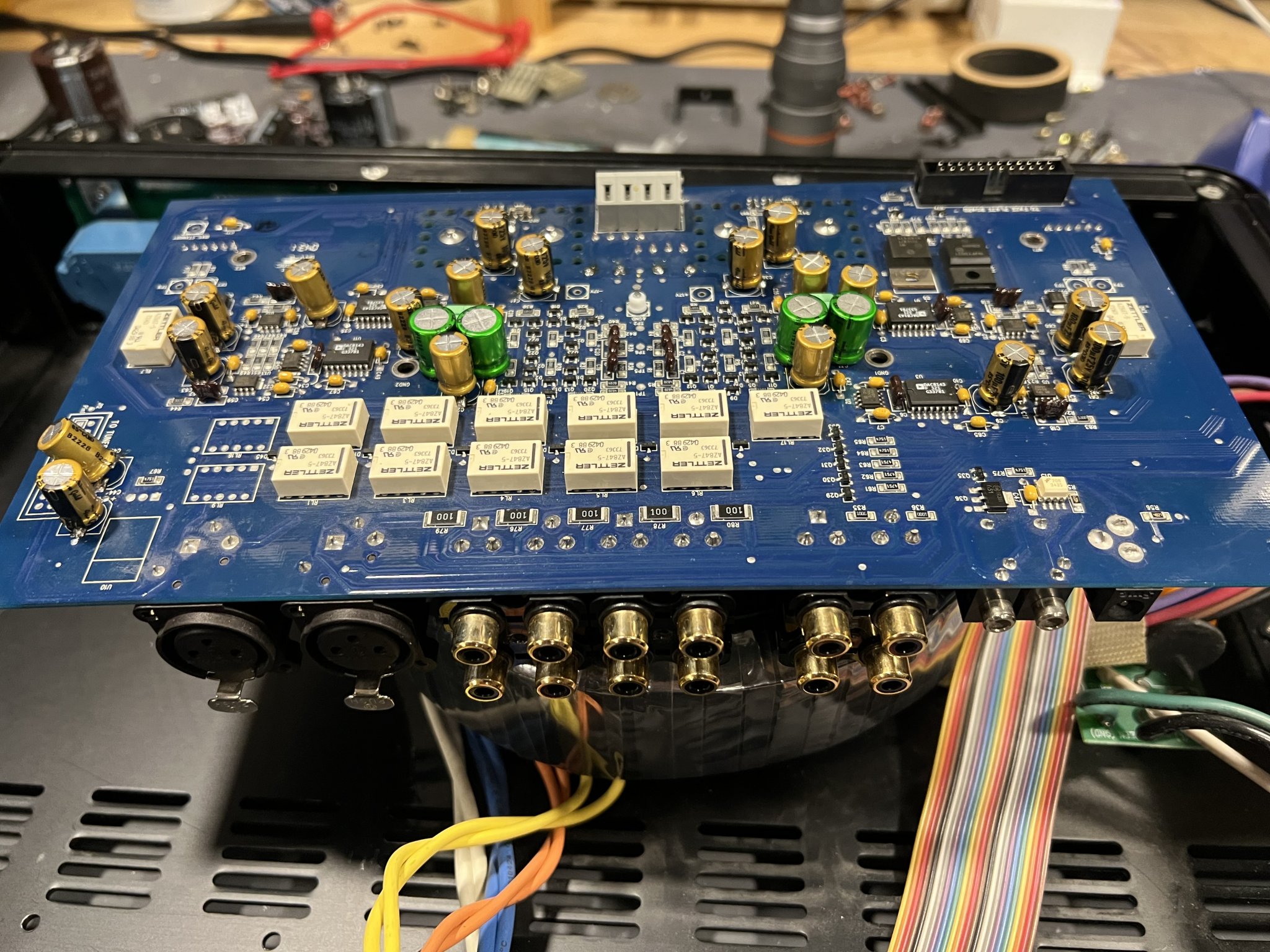

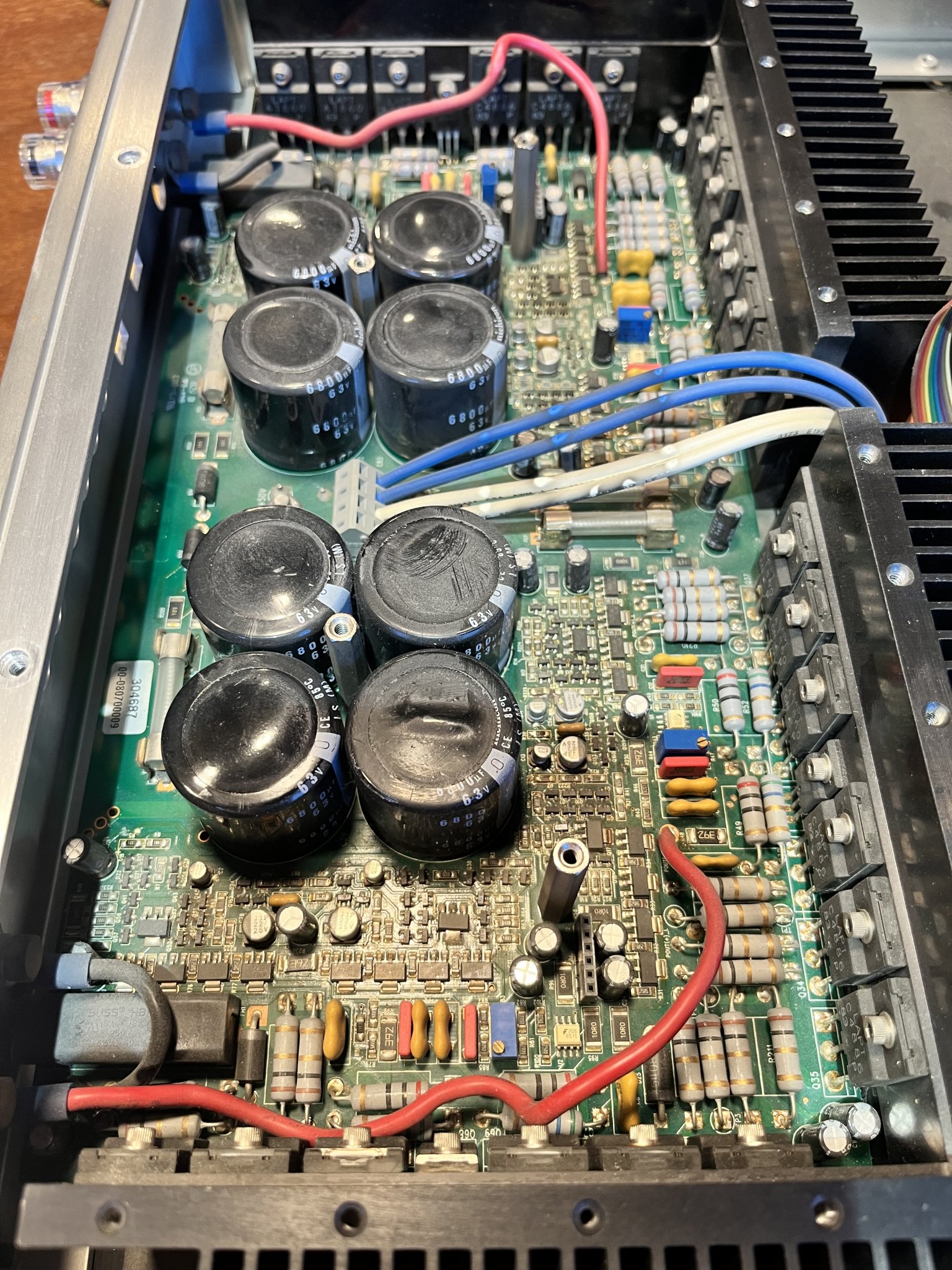

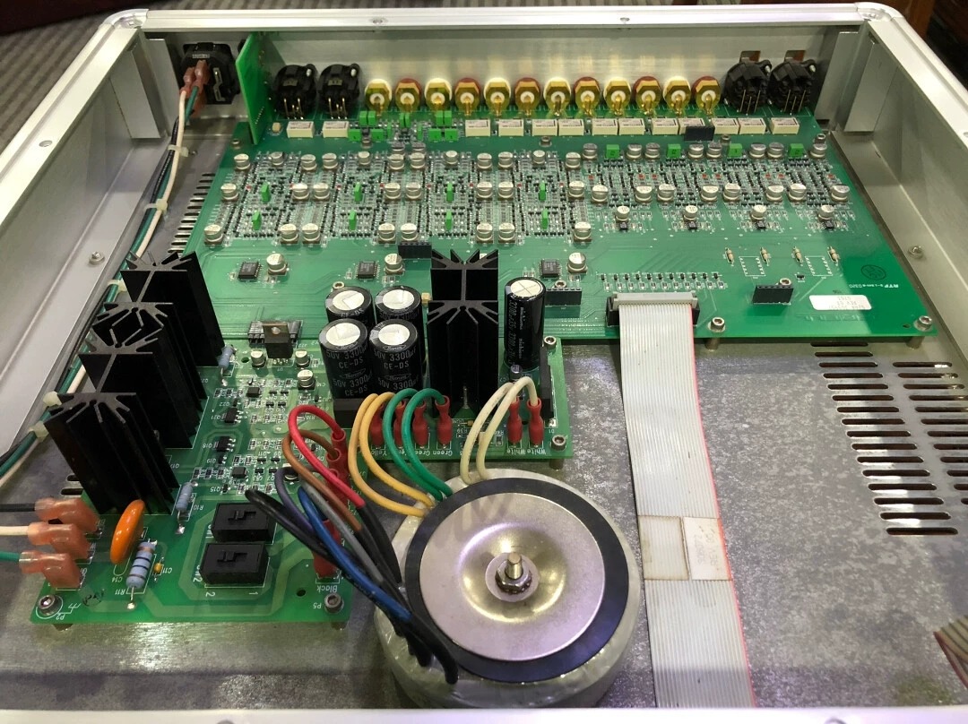

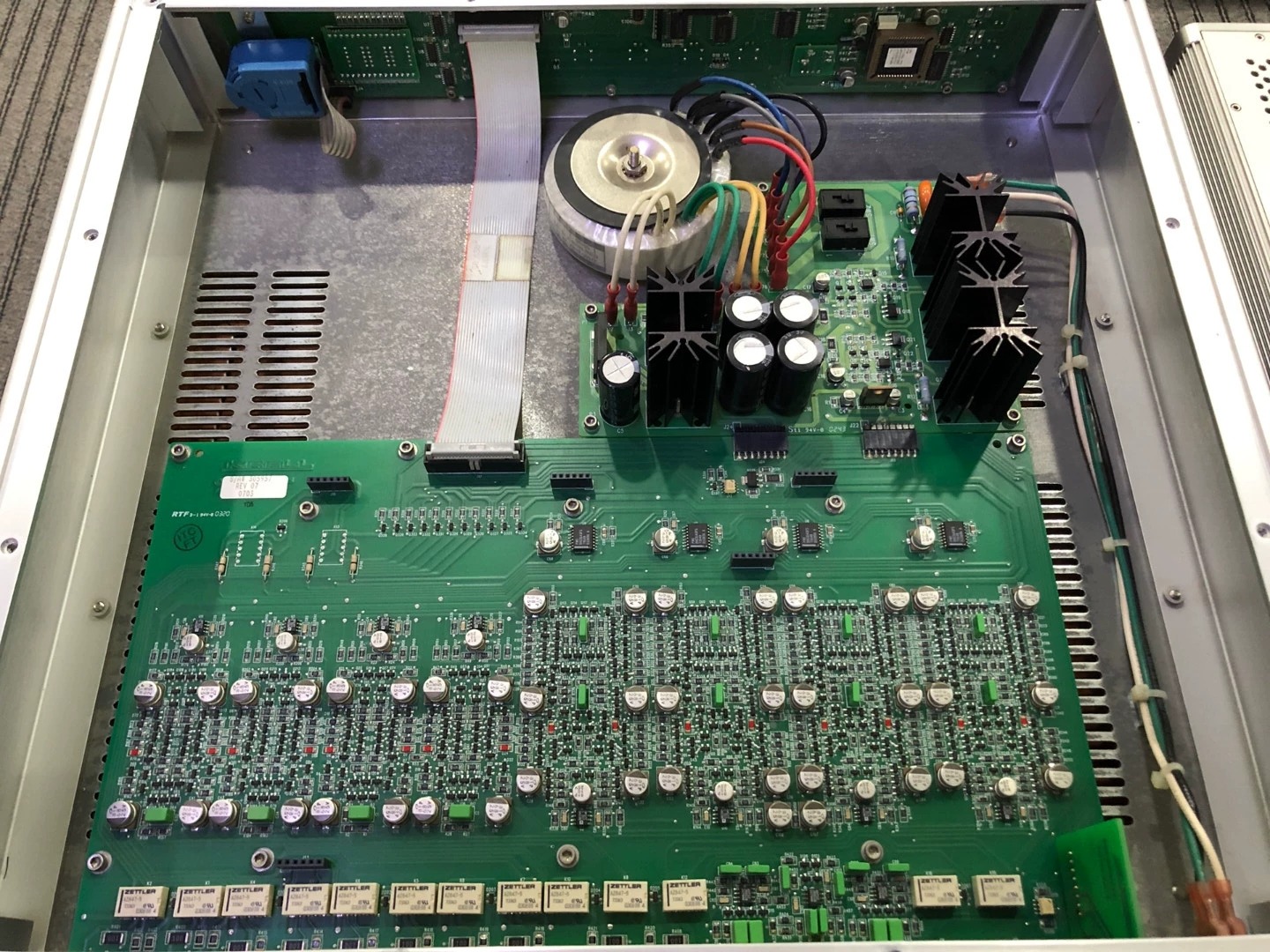

So finally did it, removed the 72 caps and replaced them all. No more SMD, Nichicon all the way and 4x15000µF Mundorf in the power section. The 2x3300 for the preamp are a bit bigger than the originals (35V -> 50V), they didn't fit under the board anymore, I had to move them to the side. Result: no more distortion, even at higher levels, improved dynamics and placement. Took me around 8 to 10 hours, very happy with the results!
Reactions: 1 users
Cannot think of any better input coupling caps than Nichicon ES bipolar that we are both using .. refined, clear and yet organic as well as available cheaply. Only issue is that it is 85c rated and not 105c that I wish for to be used for all new cap replacement in this rather hot amp ... but changing in another 5-10 yrs will not be too difficult since on top preamp pcba 🥳🥳
