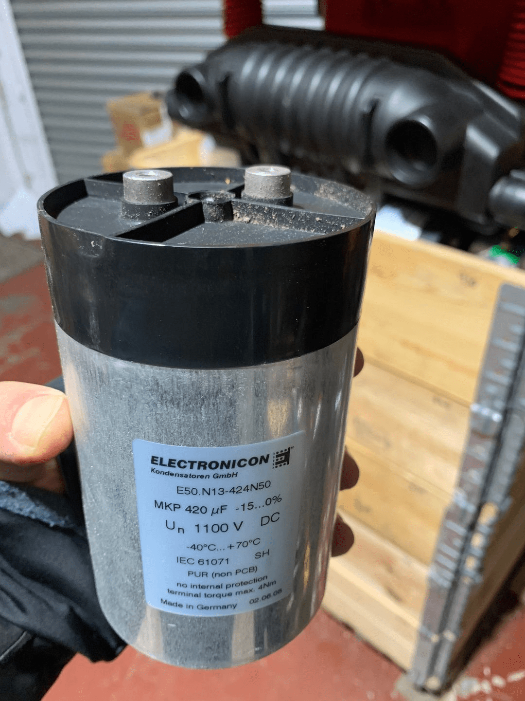

(When you use capacitors at high voltages they can store a lethal charge. If you short the capacitor you get a nice spark. However left open circuit many capacitors will have a high voltage grow back. So folks who do this stuff leave the capacitors always shorted when not used. This when not shorted they really are cazapatators!)
There's a fella selling hundreds of these on FB markets:
Reactions: 1 user
