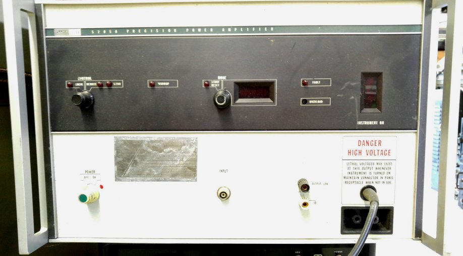

Recently saw this amp for sale, the Fluke 5205A. May not be what you want but is a good example of a complete DC-100KHz high voltage power amp. FLUKE-5205.jpg
It's one of those pieces of gear I want to play with but can't justify.
Some specs:
DC output of +/-1500V, up to 200mA.
AC output of 1100V RMS, up to 200mA.
800V/us slew rate with 200 mA resistive load.
500V/us slew rate with 200pF capacitive load.
- slew rates deternined by capacitive load, frequency, and protection circuit -see manual.
There's one at fair radio for reasonable amount:
https://fairradio.com/product/fluke-5205a/
and the full manual is here:
https://assets.fluke.com/manuals/5205A___imeng0000.pdf
Manual's worth a good reading anyway.
