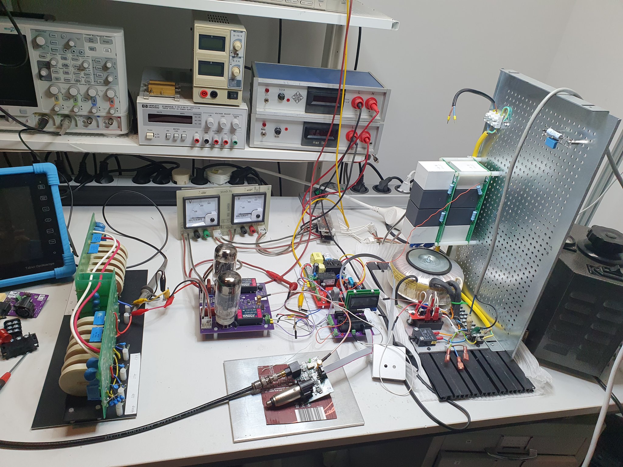

I have build dual mono amps with balanced inputs (symetrical source was mendatory). But have not found it to be an advantage after all . Too complex to troubleshoot in case something went bad. Also hum can be an issue as the power supply was not stabilized in my case and the amps wander off…
I use a balanced input for each channel, and each phase of the input drives a single-ended output stage.
So I can test each stage with a single ended signal if need be.
I understand the need for simple and quick troubleshooting of these animals - I maintain a prototype amp with power supply on my bench just in case.
On a demo evening at an audio club two weeks ago one amp slid off the chair and crashed on the floor.
One broken tube was all. Trouble shooting, replace tube and retest all in less than half an hour.

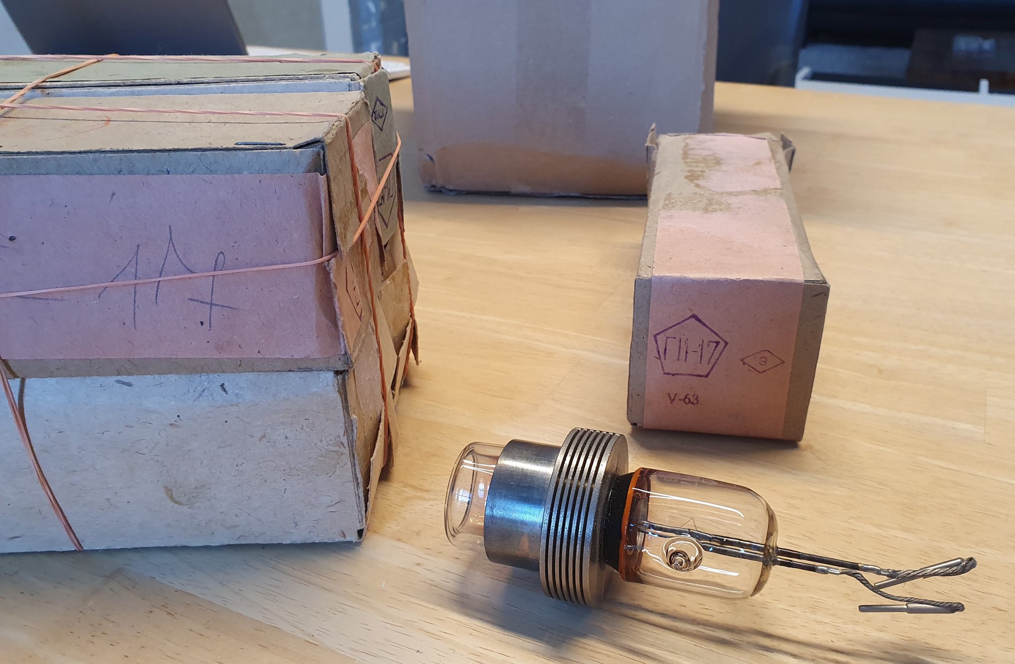

Pulled the trigger and ordered a handful of GI-17 tubes from retrostore.eu, at a very good price.
They are equivalent to CV-1256 family.
Interesting (for me) that the C and heater are interconnected but the heater is indirect.
When they arrive, I will set up a test circuit and report back here.
I will also have to find a way to mount them.

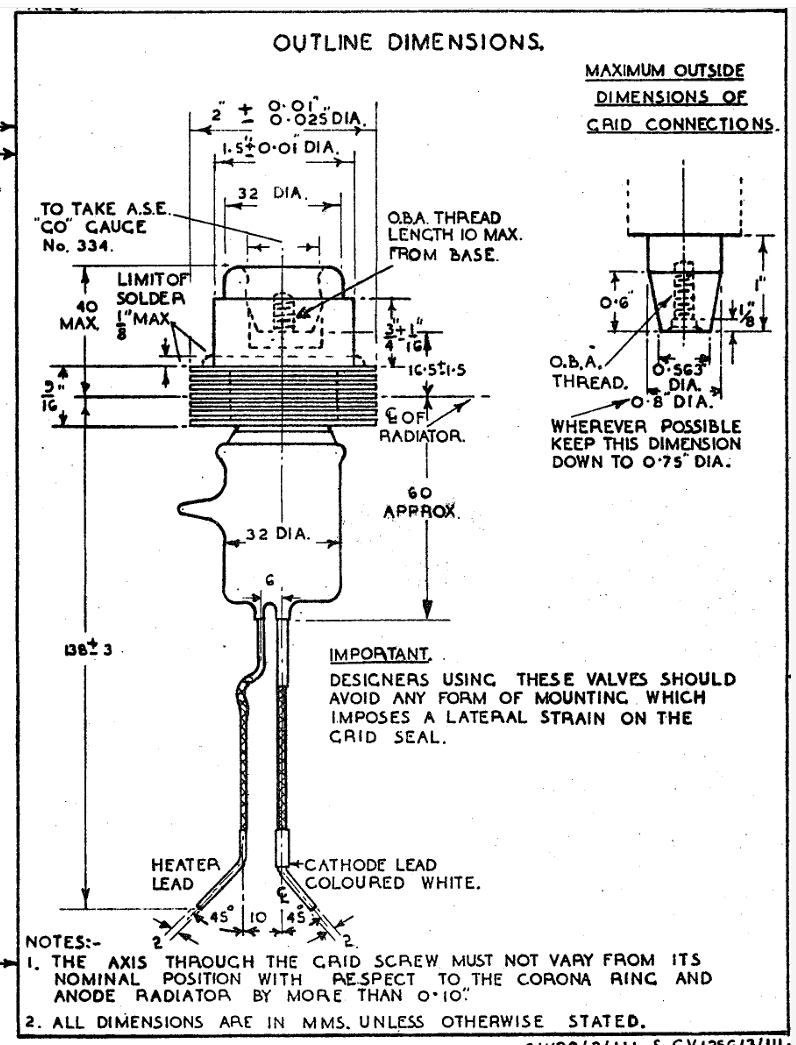

Here is info about mounting of these micropups:
http://www.r-type.org/exhib/acf0117.htm
Looks a bit challenging.
Yes needs some thought. The grid thread is #0BA which is like metric M6 but with wider pitch of 1mm, but material is available if you look.
I have a vague idea about some sort of plug-in module with the heater smps and and a small whisper fan.
Sould be interesting, I love such a challenge!
Keep the ideas coming!

In the data sheet they specify air flow on the anode as well as on the grid seal.
But that's 'just' mechanics.
I also wonder how much the requirements can be relaxed when Pa is 40W instread of 150W.
Heater power is almost as much.
The thermal camera will be broken out. 140deg C is max.

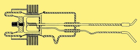

Friends, any Russian speaker can translate the main data from the attached? For instance, is Gm 12mA/V (line 3)?
I take it that Vf should be between 5.7 and 6.9V, but what's If?
(Also found a nice clear drawing of the internal construction).
Jan
Jan
That's it, cetka is grid,
so Uc is Vg
I think you already guessed that
B stands for V(olt)
kB fo kV
BT for Watt.
Obviously main application was generation of RF pulses, radar maybe ...
The table gives only 2 characteristic points:
Va = Vg = 1050 Volt ---> at least 70 Amps
Va = 4 kVolt / Vg = - 900 Volt ---> no more than 5 mA (cutoff)
The next line seems to contain a typo, Va should read Vg, and the 2 uA max
is the max grid current at Vg = -250 Volt / Ia = 0.2 A.
