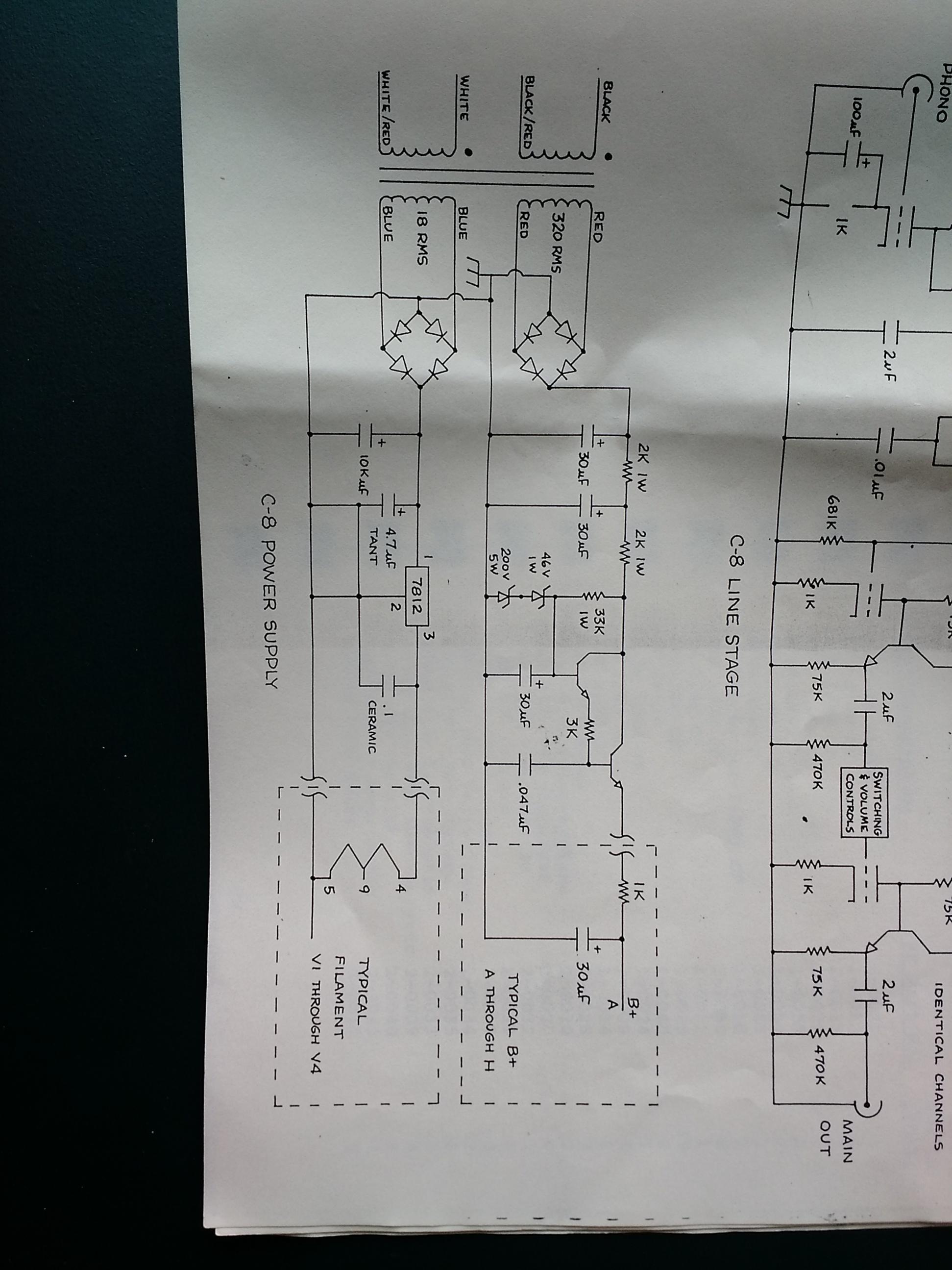

Looking for circuit improvement advice(Precision Fidelity C8)
Better quality power supply schematic attached this time
I just don't see the timer and relay
