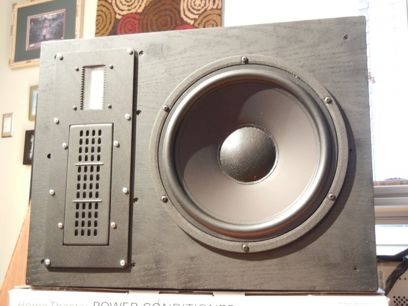

Here's my current setup. Originally active DSP with GroundSound, recently upgraded to DEQX HDP-4. You can see the three 3-way NHT M80 monitors and two S80 subwoofers. There are two other S80s for LFE in the room. There's another bass trap to the right out of the picture. All of other panels also have OC 703 in them. Currently I'm sitting 10ft from the left/right speakers. So closer than average. In 2014 I'll be switching to a projection screen and will then move the chairs back about 2ft.

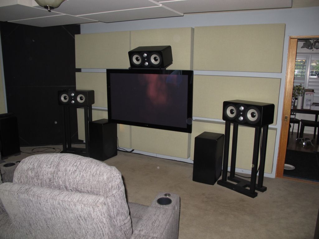

Nice setup. I immediately had 4 responses to your room:
1. You need a projector - which I was glad to read is next on your agenda.
2. Darken the walls (ceiling too if you can) around the projection screen to minimize reflected light. So many people neglect this step but it's effective. Dark drapes and/or cloth might be your best bet for that.
3. For HT, get yourself the full 7 channel surround setup if you don't already have it. Maybe even the 9 channel setup tho I haven't heard how well those extra front channels work personally. But with such a well treated room, full encirclement with surround is wonderful. If you can stomach the actual movies, Star Wars 1, 2 and 3 are amazing.
4. I can't see your whole room, but I think there's a chance you have used a little too much absorption or not enough diffusion. I'm thinking that your room could really benefit from 4 to 6 diffusion panels (see different eg's below), maybe 24"x24" or a little bigger, set up on the side and back walls at about ear height. They keep the room a little bit more 'lively' but keep the HF reflections randomly diffuse. Lots of room for creativity in their implementation. Just a thought.

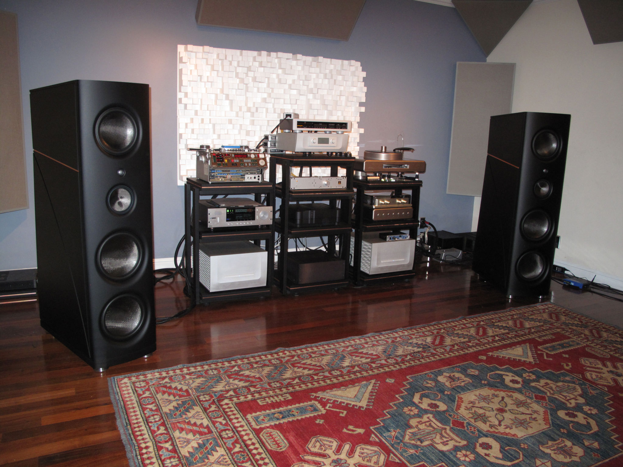

As for driver recommendations, I figured that my dream system would always be anchored at the top and bottom by a Raal tweeter and a Rythmik sub (or 2). You've got the Raal already, so here's some info on the Rythmik if you've never heard of it, Servo subwoofers •Rythmik Audio Direct Servo subwoofers.
I also ran across these reviews recently which I thought also might prove useful to you in terms of your driver selection:
Estelon X Diamond Loudspeaker | The Absolute Sound
Talon Phoenix Loudspeaker | The Absolute Sound

Overnight I've reconsidered my requirement that I will only consider a 3-way solution. My current setup is a 4-way with two deqx hdp-4s. Its working very well (besides the soundstage issue). I could add a hdp express-II for a lot less money than the hdp-4 to control the subwoofers.

It is perfectly okay for a dedicated HT to be a little dead because let's face it - where we mix soundtracks is a little dead as well. It helps us hear everything in the mix without all of the reflections.
I agree with this. I probably prefer a room a little more dead than the average person, especially for HT but I have found it also very insightful for music too.
For the OP, I thought his room looked perhaps just a little excessively on the dead side. I didn't know about the glass tho. I'm thinking now that there might be something of a strange imbalance of direct HF reflections in the room. Perhaps some heavy drapes across the glass and a scattering of HF diffusion panels will help. But I'd certainly wait 'till after I got the new speakers built and set up in the room before starting to tweek it.

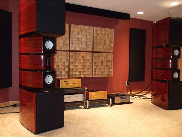

I also think that some good diffusion is in order. Well placed diffusion can actually add to the sense of soundstage width for most recordings, however the more anechoic thing you've got going on is great for delicate acoustic recordings like those from Chesky Records back when Bob Katz was their recording engineer. When the recording itself has all of the spatial cues you need for immersion, sometimes more absorptive of good too. In either case, I think you are heading in the right direction.
The Raal is tops of anything I've ever heard for HF with possibly the exception of plasma, but the one I heard ran out of headroom quickly, whereas the 140-15 gets pretty loud and is very dynamic sounding, but always smooth. What about the 12M Scan Speak mid, and a nice 8-10" in the top box to be followed up with a pair of Rythmik? This gets you into the ballgame for a lot less than the Accutons and arguably, the Scan mid relieve of anything under say 300Hz is world class. Plus it is not fragile like the Accuton which scare me if you are gonna be throwing some ref level HT stuff at them too. Or in that case, use the BG Neo8-S version with a 8-10" woofer. Basically what I just made as a prototype studio monitor, but with the larger Raal in place of the OEM.
No need to be careful with words. The room is more than just a 'little' excessively on the dead side. And because of that I'm getting fantastic bass. But what makes the dead room even worse is that I'm using very directional speakers meant for a professional mixing room. But there is a benefit. The soundstage is very accurate. Instruments and vocals don't wander around as they change frequency. The phantom center is dead straight ahead.
For two years I enjoyed the monitors and was always impressed with the accurate soundstage. When the dealer I purchased the deqx from came to my house he listened to them. He thought they sounded great, but the soundstage was 'between the speakers' and 'not enveloping enough'. I listened to his setup. He uses speakers with waveguide tweeters. Completely different soundstage. But too big for my taste. For orchestral music perfect, but for a jazz vocal it sounded like the singer had a five foot head! So I'm looking for a solution between those two extremes. We discussed other options such as AMT and ribbon. We also talked about not extending cone drivers too high where they will beam. I'd like to try the RAAL ribbon based on its reputation for good horizontal dispersion at a relatively low crossover point for a tweeter. Then match it with a midrange that is not beaming at the crossover.
