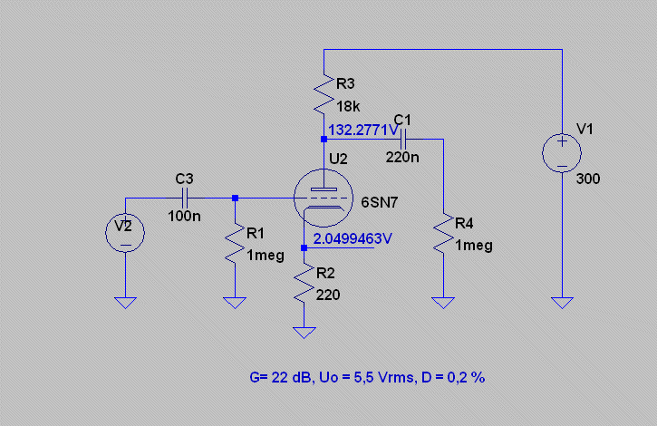

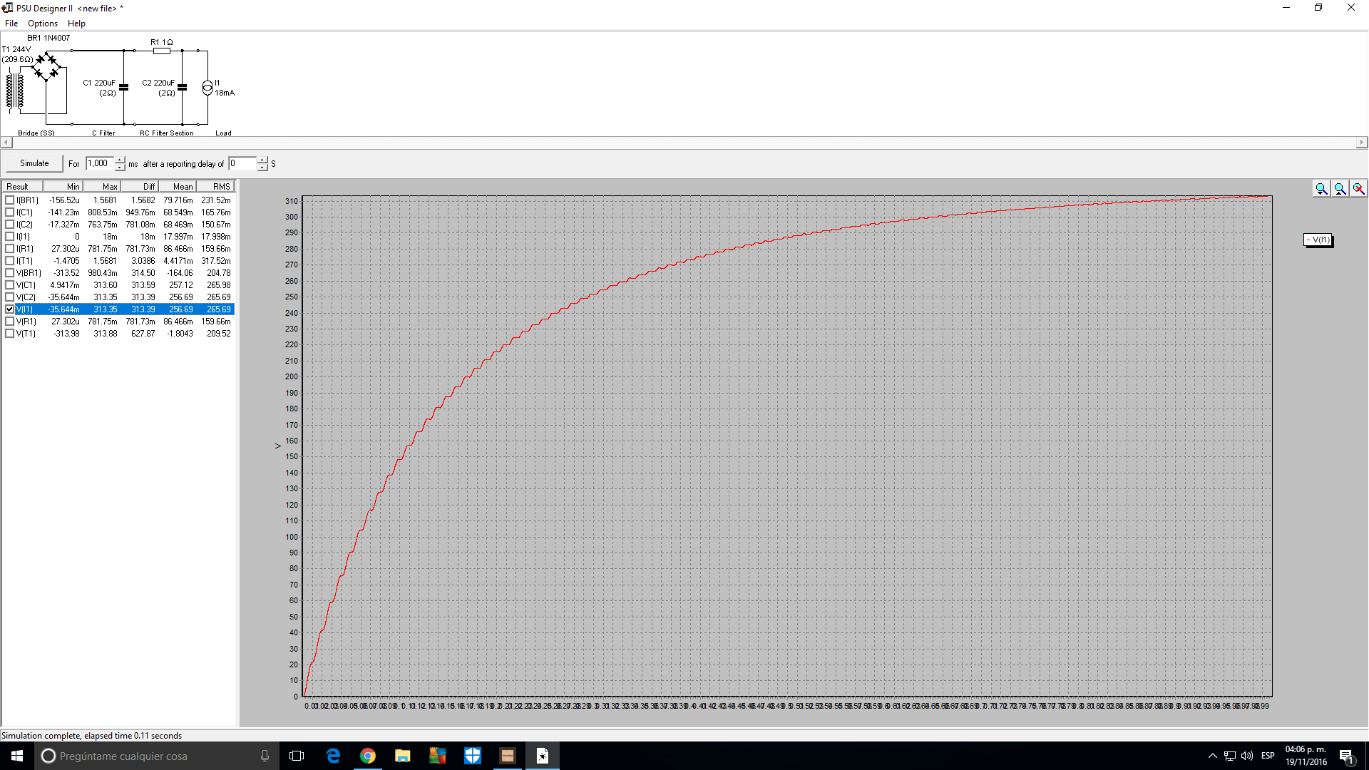

How much supply voltage do you have available ?
Here is one example:
It's suitable I have 240VAC tx

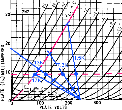

> the cathode resistor (5600 Ω)
I *think* you meant to grab 333 Ohms (from step 7). You seem to have grabbed the plate load.
> cathode bypass capacitor ...low frequency cutoff. I like 5 Hz.
> Using "Z = 1/(2π FC)" set Z equal to the cathode resistor (5600 Ω), F = 5 Hz
> 5600 = ½ π 5 C
Strictly, you want to bypass Re||(1/Gm), the tube's internal cathode impedance.
merlin has picked a current right off the datasheet. Gm also depends on plate voltage, so we have a choice of 3,000uMho or 2,600uMho. 333 Ohms or 385 Ohms.
Take the lower value (bigger cap).
So far we have 333||333 or like (sliderule) 160 Ohms. At 5Hz this is 193uFd.
Caps vary 20%. Tubes vary 20%. If we MUST hit -3dB @ 5Hz, we better allow another 40%. 270uFd.
Strictly we should factor-in the plate load 5,600 divided by Mu. 5600/20 is 280 more Ohms which appears in series with internal cathode impedance 1/Gm.
333||(333+280)= 215 Ohms. Compare to 160 Ohms neglecting Rl/Mu.
Rules-O-Thumb:
1/Gm will be very similar to Rk in most practical designs. (Small triode at 9mA is pushing the limits and should be checked.) So it is expedient to compute on HALF of Rk to pick Ck.
Rl/Mu is generally a small correction, and is "conservative" (results will be better than computed) so this is often neglected.
I actually plotted the picture. Agree that ~~5K Rl makes more sense than my extreme bad-examples. 1.5K has low gain. 17K has no swing. ~~7K is a split-difference. I have used larger swings than 50V up, but that works fine also.

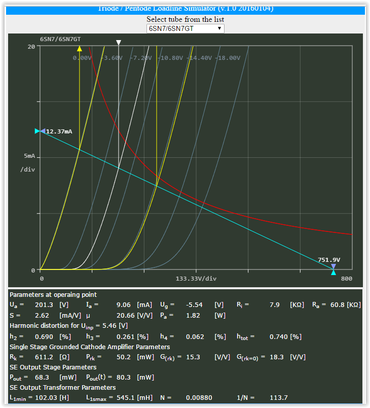

As was previously stated, the Loctal 7N7 is electrically equivalent to the Octal 6SN7. With its μ of 20, using that triode wired common cathode may yield too much gain. The hybrid setup I've uploaded has a stage gain of about 8X. Even that may be too much. The non-inverting LTP based setup provided can be easily altered to add loop NFB, which allows gain to be customized.

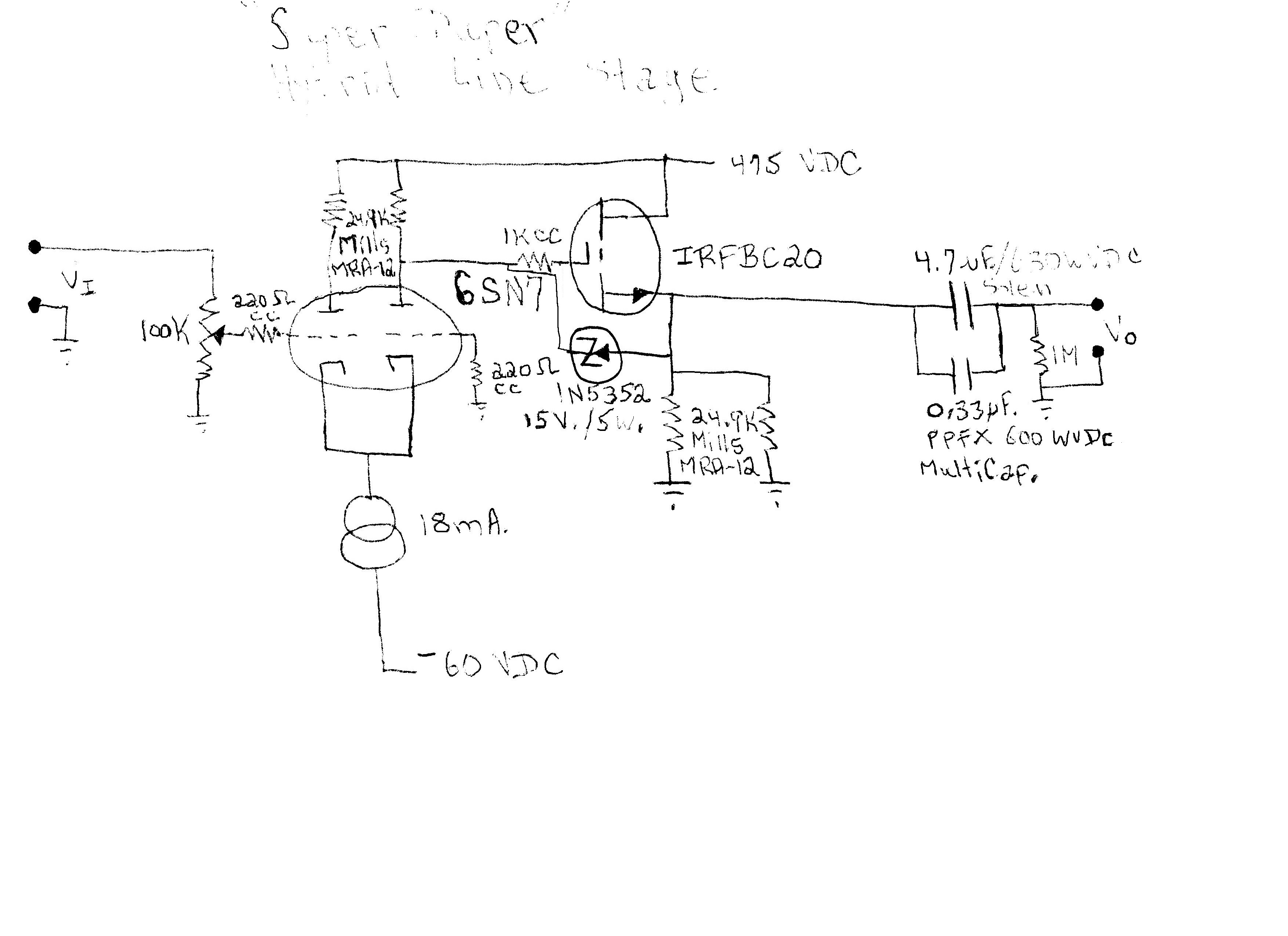

Are necessary C3 (all my sources have output cap) & R1 (I use 100K ladder attenuator)?
I'ts necessary elevate the heater?
TIA
