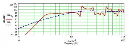

so, after trying a few different folds (the TL did have to be below 2ft in height, not too deep, golden ration baffle, and have to have space for the plate amp as well) in the sections sheet, the long thin did not do as well as the simpler driver-offset model made me expect.
I added some definitions to the sheet so that I would enter some dimensions of the box and the lengths, widhts etc of the sections would be calculated from that. not a single number was entered into the transmission line definition part, only variables
so back to the fat short, line length 1.68m, area from 1.8Sd - 0.66Sd (well, not that fat anymore, it's been on a diet) with some 100g stuffing in the beginning of the closed end. this gave a nice response, only small -5dB ripple @~130Hz.
so, let's buy & saw MDF....
