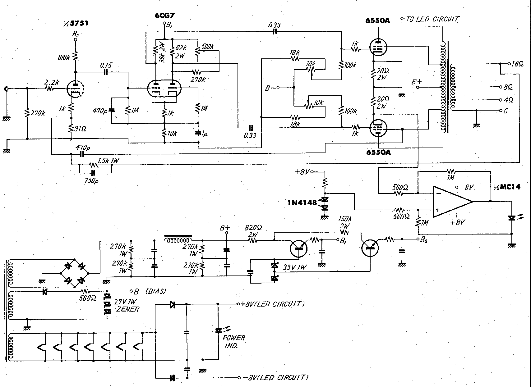

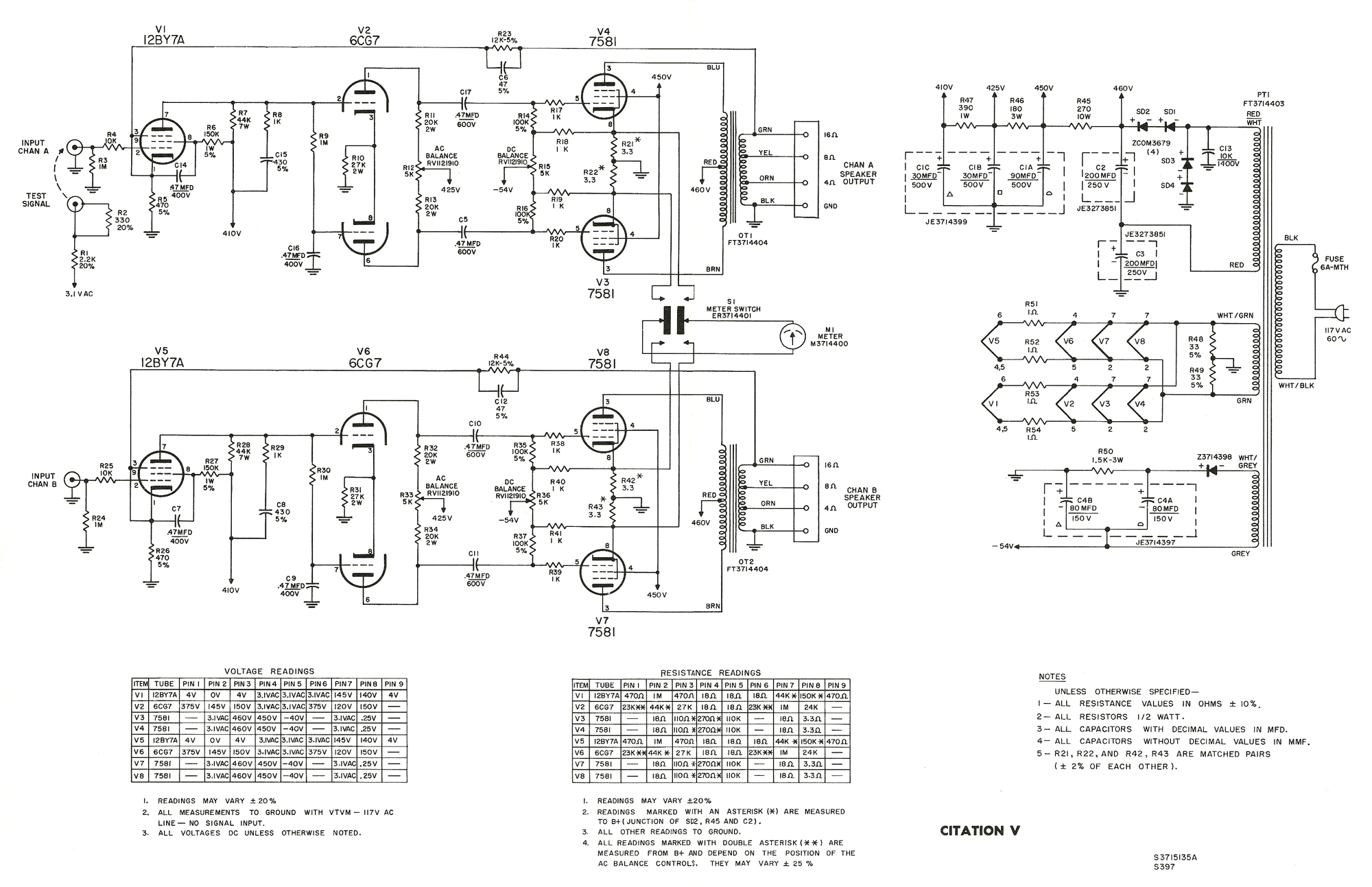

The problem with types like the 6SL7 and 12AX7, in the LTP role, is a combination of high RP and low gm. That makes them poor candidates for driving anything other than full pentode mode "finals". If you insist on a high μ type in the LTP role, look towards the 12AT7/ECC81.
The "best" "Golden Age" implementation of Mullard style topology I'm aware of is the Harman-Kardon Citation V. Attention is called to Stu Hegeman's choice of high gm small signal types.
The Citation V circuit has been on my radar for a while.
1. What pentode do you suggest to sub in for the 12BY7?
2. What simple CCS system for underneath the 6CG7? I haven't done one yet.
3. 6SN7 fine to sub in for the 6CG7?
I have some Toroidy's that might fit the bill for the outputs.
@ontariomaximus
6SN7 and 6CG7 are electrically equivalent.
10M45S is adequate for a Mullard circuit LTP tail CCS.
The 6CL6 is a potential substitute for the 12BY7. Unfortunately, neither of the 2 is in production. An in production solution to the problem is a 6922, with its sections in cascode.
1. 11hm7, 12gn7, 12hg7, D3a, 6jh52,
2. depletion mosfets, dn2540, etc
3. yes
