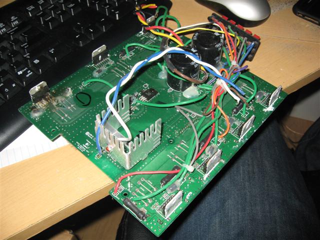

Logitech z-680 amp repair

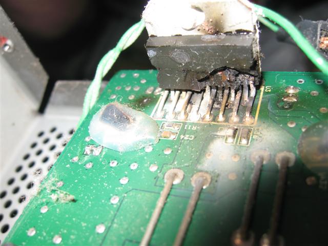

I would not recommend bridged LM3886 amps or any chipamps really to drive a 4 ohm sub. For this you really need a discrete amp with a decent heatsink and capable power transistors, especially if you like to pump bass. As the destroyed chip shows, chip amps just do not have the SOA (safe operating area) for this.
You could use the surviving chips to drive the satellite speakers. They are ample for this task.
