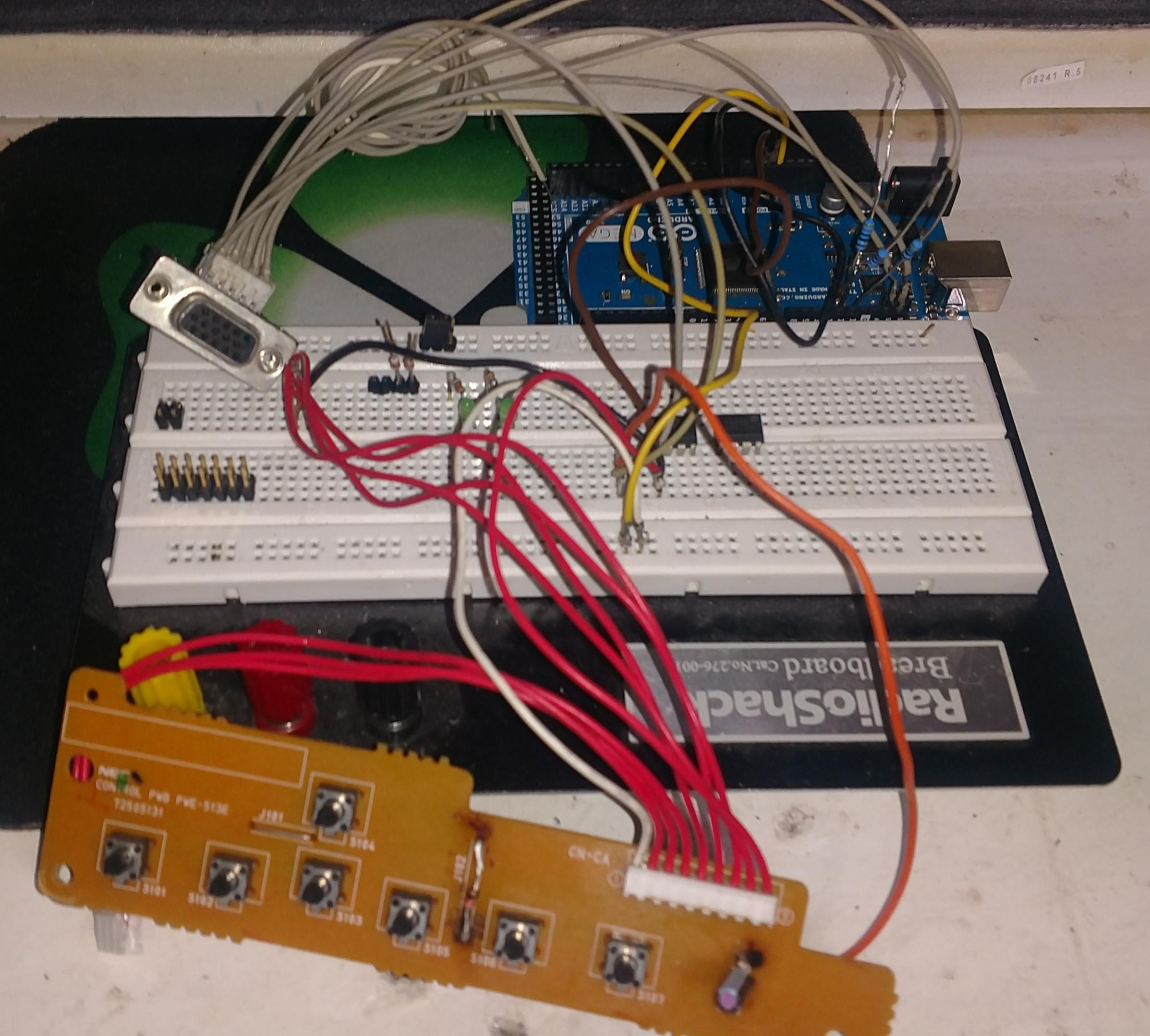

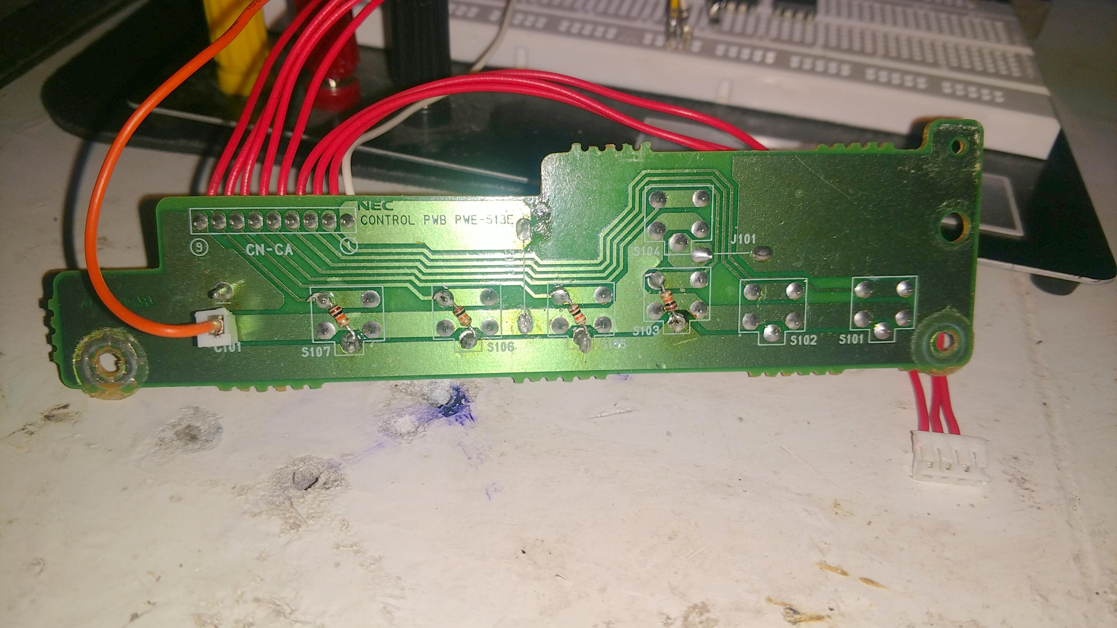

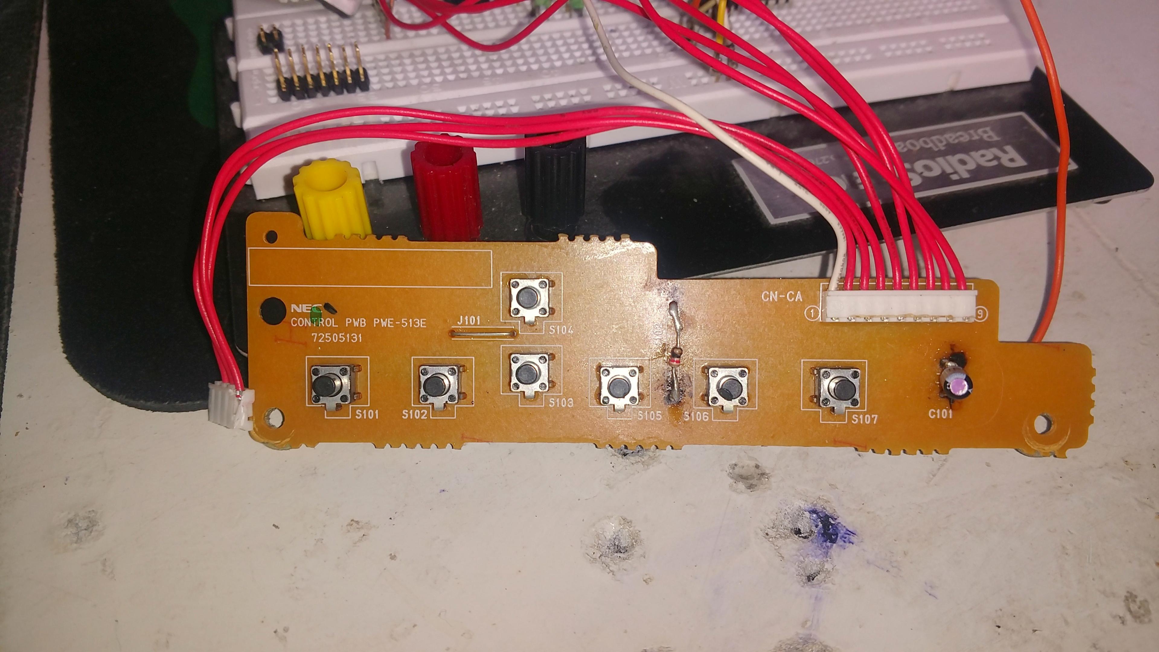

II. The remote pod: how it works
This is a pretty simply designed board composed of a selector and 3 push buttons:
Power
Mode select
Matrix
The pod also has an audio jack connector which I have never used.
Finally it is connected to the sub unit via a VGA connector similar to the one used for display.
The pod contains a microcontroller in charge of collecting the information via the buttons and send the commands accordingly to the sub internal microcontroller

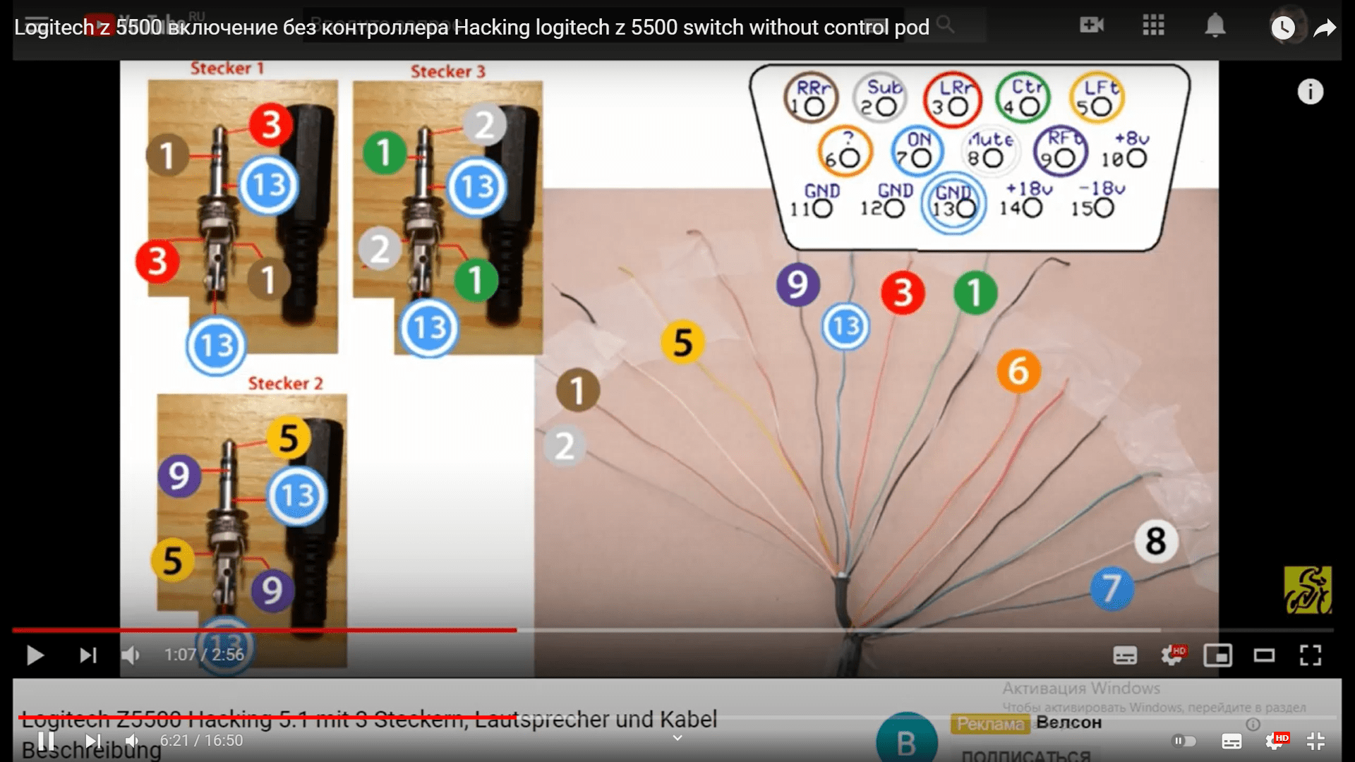

III. The pod pin allocation
Based on a previous post that identified the pin (and I thank the author for that precious kick off help) I identified 3 groups for the pins:
Group Jack: this group is connected independently to the jack on the pod board. I will ignore this as it has no impact on the control electronic and is not connected to the pod micro controller.
Group power
• Pin1: GND
• Pin6: +5V
This just powers the pod electronic board of the pod. It is constantly on when you turn on the sub via the main switch in the back of the sub unit.
Group control
• Pin11: Standby
• Pin12: Mute
• Pin13: matrix
• Pin14: SCL
• Pin15: SDA
The pins 14 and 15 hold the key for the control of the unit and will have all our attention. However we will not completely ignore the pin11 and 12 as they help us turning the system out of standby mode....

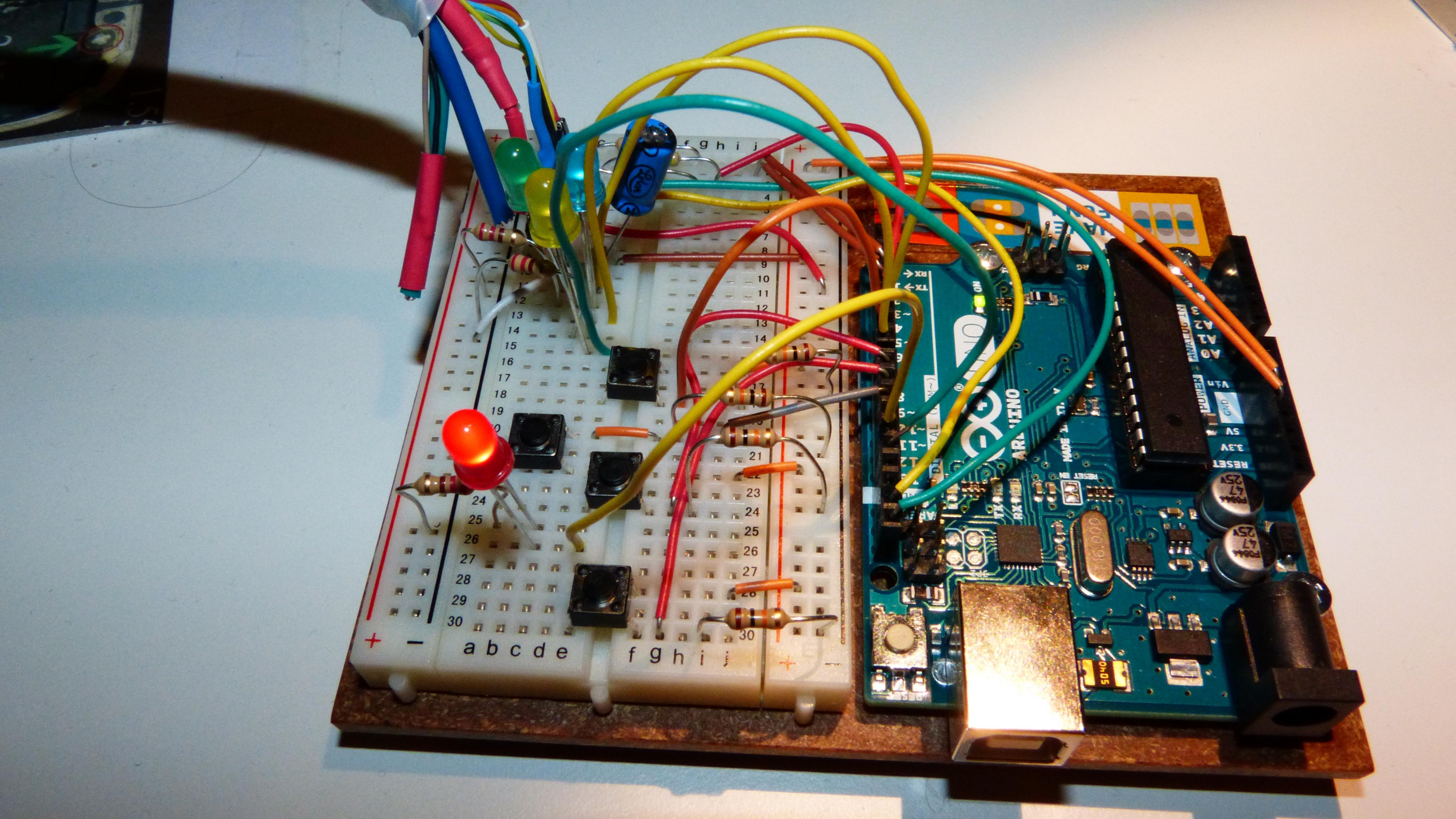

VI. The electronic setup
What follows is pure prototyping. It works (for me at least) but is far from representing a finalized solution. I hope it will get you through the difficulties I encountered to be able to control the sub with an alternative hardware to the supplied pod (especially if you lost it).
The design I propose here doesn’t include either a remote control capability. If you wish to get more details on how to set a IR and basics for remote control please visit the following website: Arduino Infrared Remote tutorial - All
a. Material
⁃ An Arduino UNO
⁃ A breadboard
⁃ A VGA separator ( I personal used a VGA extender cable I sacrificed to do the separation of the pin cables)
⁃ A VGA cable with a female connector (usually in extenders)
⁃ Some male female inverters (depends on the cable and separator configuration you have)
⁃ 4 push buttons
⁃ 3 resistors 470 Ohms
⁃ 4 resistors 220 Ohms
⁃ 1 resistors 1 kOhms
⁃ 4 resistors 10 kOhms
⁃ 2 resistors 30 Ohms
⁃ 1 capacitor 1microF
⁃ 4 LED (same or different colors as your preference)
⁃ Jumper cables

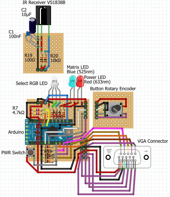

b. Build up the electronic circuit
We are going to make a simple 4 buttons pod:
• On/Off
• Selector
• Volume UP
• Volume DOWN
Set up the 3 buttons the same way with one resistance to the ground and the 5v connected to the push button
The line between the resistance and the button shall be connected to one digital output from the Arduino
Using the VGA separator, connect the following pins to the Arduino:
Pin 1 ground to Arduino ground
Pin 6 5v to Arduino 5v ( optional if Arduino is powered via USB)
Pin14 to SCL of the Arduino
Pin15 to SDA of the Arduino
If you want to focus on the volume control first and see the on/off function for another time then directly connect the pins 11 and 12 to the ground. Otherwise connect them to some Arduino digital output with a 470 Ohm resistance to protect.
That's it you have created the remote! At least from a hardware perspective.
It should look like something like this: (pin connection on the picture may differ from the picture)

  • Layout Generic command.pdf
Hey,
This post is old and many people may have moved on the Z5300 Pod case but some other lacking the remote pod might be interested in the solution I managed to come up with.
The previous issues on the I2C connection to the Sub was due to the fact that the Sub doesn't follow the I2C protocol according to the standard. Instead it is reversing the Acknowledgement bit between the message transmitted.
I posted a PDF with the solution to build a new prototype pod with an Arduino. i also used a Infrared sensor to enable remote control with a TV remote. This of course requires you to adapt the code according to your model of remote.
I am currently building a more finished and smaller version based on the Arduino nano v3.0. I'll keep you posted!
Power
Mode select
Matrix
Group power
• Pin1: GND
• Pin6: +5V
Group control
• Pin11: Standby
• Pin12: Mute
• Pin13: matrix
• Pin14: SCL
• Pin15: SDA
• On/Off
• Selector
• Volume UP
• Volume DOWN

I know I'm a newbie.lol any way I made my button pad froman old NEC tube monitor it had extra buttons to boot. I only had to solder the resisters on the back of the board. Here the Front and back pictures of the one I made. Hope to get my arduino mega up and running soon!!!I'm going to make my wires much nicer,I'm going to make a cable.As you will see. the wires are everywhere. I want to get it to work first.Everything I used to make my button pad and monitor plug was from old computer parts even the resistors are used from an old toshiba calculator that I desoldered every electronic part that was on the board.
So I got it working Kind of.The scl and sda lines have a 5k resistor in series of each connection and when connected to arduino it wont let the arduino turn on or do anything. when not connected to the vga connector it works fine and sends the code. I verified the code being sent with the monitor function of the arduino program. so here is where I am. I took mute and stby to ground and power it up. I also had to bypass the 5k resistors and connected straight to scl and sda pins and it lets the arduino send the commands but when I turn it all on and push the power button on the arduino nothing. Ity only turns on after I PUSH THE VOLUME BUTTON TO UP THEN IT WORKS. THE VOLUME IS CLOSE TO ALL THE WAY maybe little more then half way. I'm not sure cause I never heard it working. I found this unit from dumpster diving.
Update: I have gotten it to work!!!!! It works Great!!Sounds Great. All the buttons work as described!! My only issues I have had.
To get it to work correctly I had to use the original Twi.h file. when I changed the nack and ack code lines and reverse the numbers it made it not work right. After changing the values it worked like it said it would if you didn't change them.So for me the non modified twi.h file worked for me and I could never get it to work with the 5k smd resisters on the amp board in series of the sda and scl lines. I had to solder a wire over each resister and bypass them. That aloud me to use the monitor control plug and not have to solder to the IC sda and scl pins. the wire was the easist way to do it for me.So if you have any issues like I had try what I did. It works great!!!!
Now for my next road block. I'm lost too. I want to write the code to control the Bass and treble. I have no idea how to take hex code from the data sheet and turn it into a i2c sketch for my arduino.If there is anybody out there that knows Please Help. I hope My post will contribute to this thread. I can say it works!!!And is real easy to do.
P.s Also when you hook your grounds up make sure you use 3 grounds. The 3 are at the monitor plug pin 1,7,8.

But I just found a Z5300 a few days ago for just 15 $ CAD.
Thanks a lot to Rem604 for the code !
I didn't modify the Wire library, but soldered the pins to the external connector.
I'm currently using a modified code from Rem604's.
I prefere using a rotary encoder then 2 push buttons.
I also modified the code to store settings in the Arduino EEProm.
Nothing too difficult ...
But I have a problem with the "select" button.
The initial behavior is to switch between sub, center and fader.
I want to add balance, since it's just a need for me.
I ear quite correctly with my left ear, note so much with the right.
So the way I balance between sides is important for me, even if for most of people it may seems odd 😛
In the original code, the first i2c is to select which function is used. The second i2c frame send the value.
I can't understand how the "select" mode works, and change between 4, 7, 0 or whatever ...
Any help will be nice.
I've modified the code for my own use, it's ugly and I don't care.
If some are interested, I'll make a clean version and a pcb with Kicad.
