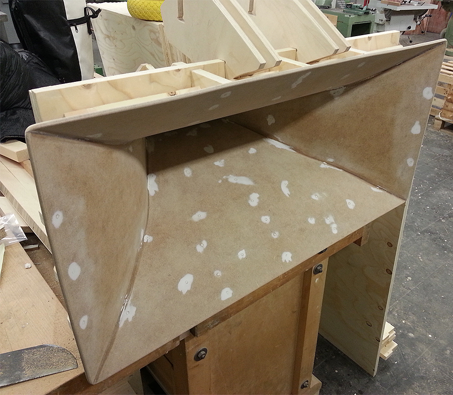

Well, I have recently built a large prototype expo-conical Horn roughly based on Keele's CE horn concept (image). It was designed to control horizontal directivity down to around 400Hz, and the constant directivity qualities are pretty satisfying.
A DH1A is attached to the horn and plays adequately from 500 up to 18k or so, using a little EQ on the high end it is acceptably linear.
However, I am currently trying to get away from these concepts pushing so many octaves through a horn because I felt like I was in need of more transparency, precision and resolution. However, like I already mentioned, I am currently still trying to map out the way to achieve that.

Removing the 500-1000 Hz octave from the HF driver will go a long way towards transparency, precision and resolution, and can be accomplished with the DH1A using 6" or 8" speakers mounted on the same horn, as in the DSL SH(Synergy Horn) 95, resulting in a virtual single driver point source covering from as low as 100Hz (using bass reflex porting of the horn enclosure) to 18kHz. No lobes.
Removing the snout adapter on the DH1A reduces the throat to 1.4", which also makes it easier to build a horn with better HF properties, and better facilitates the offset horn mid drivers.

I agree, removing that octave would help a lot. However many advantages the synergy concept may have, highest efficiency is still one of the main goals with my project and I like classic horn design a lot.
Yeah, for this prototype, an aluminium tube is reaching into the snout of the DH1A that forms the first 5cm of the horn and also the transition from circular to a square profile and prevents the exit to widen to the 2" dia. I actually did try removing the snout once (with heating the bolts, probably not enough), but my tools broke in the process- so much for locktite. :)

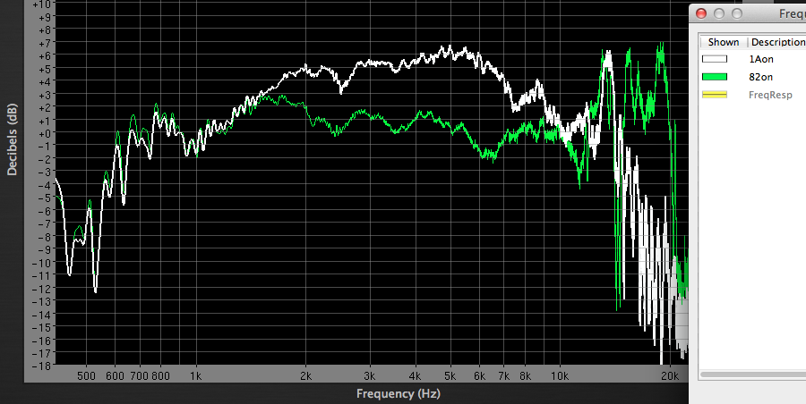

The fall off is also determined by diaphragm construction, as you can see below the B&C DE82 using a 3" voice coil mylar/titanium diaphragm actually shows a rising upper response compared to a 3" all titanium diaphragm EV DH1A, which more or less falls at about 6 dB per octave. Both were measured on the very narrow constant directivity Maltese horn, midband sensitivity for the DH1 is around 115 dB one watt one meter (2 volts, nominal 16 ohm diaphragm). The mylar surround throws away midband sensitivity, but increases the upper sensitivity.
Using the Maltese HF horns requires some serious low mid and bass horns to match sensitivity. Also requires a rather small listening window, unless the distance is long, 11 degrees only covers about 3 feet of my couch..

If the diaphragm is rigid then it has to fall at 6 dB / oct. Only a diaphragm that is breaking up can do otherwise.
So you are saying the B&C DE82 diaphragm is breaking up.
Seems to be a fairly common design approach.
The B&C DE82 still sounded OK when EQed, though it couldn't get as loud as the DH1A before distortion became objectionable.
I wish I had received the "TN" all titanium diaphragm, the mylar/titanium had been put in by mistake.
Art
Its just simple physics that a single degree of freedom system has to fall at 6 dB/Oct below resonance. If there is more velocity than this then there has to be multiple motions (more degrees of freedom) in the moving system. Usually this is the surround. JBL did a paper on this some years back. I never liked the idea of using modes like this to "extend" the response, but it seems to be pretty common.
