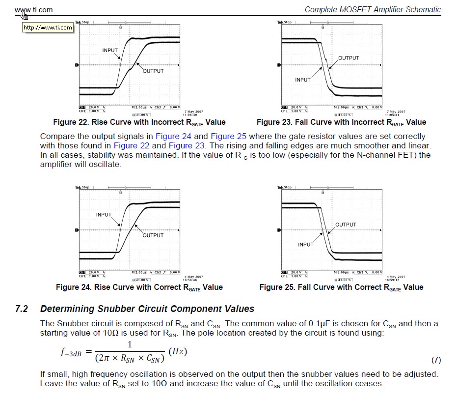

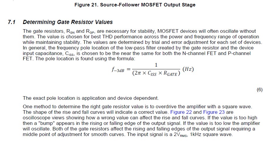

I have use 22pF, the mosfets get driven by een dc coupled tube EC99.
220 pf was a type error, I did use 22 pF
Using cap or gate resistor to get even respons of P and N channel, better is gate resistors because the lateral has low capacitance this is a good working method, if you do wel the 22pF
can even be removed, fase shifting occur when P and N are different als she always are, therefore I am busy with a circlotron, these do not oscillate, however sound like, circlotron sounds some more relaxed.
A way to get good respons is to use a square wave and adjust the gate resistors until the spike dissapear and the square gets just little as possible rounded corners, (20 Khz).
