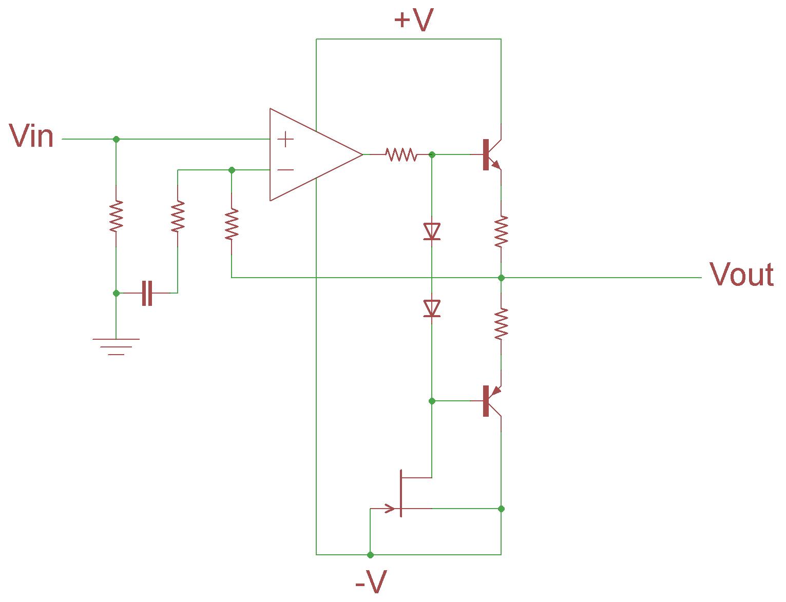

Adding a couple transistors to be the output stage will allow a bit more power. Something like this.....

A speaker is around 8 ohms, the output impedance of the 741 is about 100ohms so all the power is being lost inside the 741.
I have succesfully driven headphones from op-amps with resistors on the output but obviously not very loud. I used an op-amp to drive a disco cueing headphones, right deck went to right ear and left deck to left ear. Despite 225WRMS of disco sound I could still cue using the headphones.
For a 8 ohm speaker you need at least a few watts of power, you can use a chip amp or a discrete amp for this. Loads of circuits on DIYAUDIO.
You can easily buy a module off ebay for a few pounds.
2.2Wrms @8R (6Vp) is 750mAp. The circuit in post 7 simply adds a current amplifying stage to lower the 100R output impedance so it will drive a speaker. Use 47-100R for the base resistor and maybe 0.47R for the emitter resistors. You could use TO-126 transistors for the outputs or rather multiple paralelled small signal devices like 2N4401/4403 just make sure each transistor has its own emitter and base resistors. Increase the emitter resistors as well, for example, 3R if you use 6 pairs. J-fet can be any device, Idss maybe 2-10mA. Mount the diodes against the BJTs. I cannot think of a cheaper solution since those transistors cost only pennies a piece.;)

It is simply a non-inverting op-amp circuit that includes the output follower BJTs within the FB loop. The output of the op-amp is conducting DC current through the diodes and through the J-fet. The J-fet used in this way creates a constant current source. So whatever the Idss of the J-fet is, check a datasheet for whatever one you have on hand, that current will be conducted from the op-amp output pin. This sets up a bias voltage across the diodes to bias the BE juntion of the BJT's, two forward PN junction drops. The emitter resistors limit current and add stibility to the bias. The diodes and BJTs should be in contact so they share the same temperature, and this also adds stability to the bias. This is class AB, where both devices conduct a small current but the NPN transistor drives the positive half of the waveform and the PNP drives the negative. Another option, and perhaps simpler, would be to use class A, but this would require dissapating ~10W of heat assuming a +/-6V supply.:eek:
