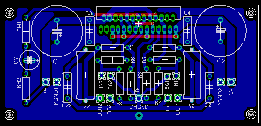

Ok I correct all errors that I made in SCH file and I think that is now ok :)
Here is image file:
http://www.dodaj.rs/f/1Z/bJ/3mXEm1Hs/sch1.png
The resistence of 2R7 need to be 5W wire type?
I have one question for pinkmouse, "That's just a workaround to aid laying out a star ground, if you look at the pcb you can see what I mean." so I need to conect CHNGND to PGND with jumper wire in the middle off PGND1 and PGND2 pad?

Here is my version of bridged LM4780 Single side PCB

ritvarsrizikovs Great PCB.
pinkmouse
Now I understand what you saing about grounding :) You are talking about all ground need to be connected to chassiss in one point right? I read about that on this link:
Power Supply & Wiring
I think now the schematic and values are ok and I can start with building this amp. I got 3 peaces of LM4780 and torid transformmer 2x20V 6A so let the building begin :)

Afternoon folks, updated version is now attached. Layout and grounding improved, and dimensions reduced to fit my current application. As always, files in Eagle format, lines on top copper are jumpers. Enjoy. :)
Hi Al,
I put together your layout and it sings. I am surprised a chip like this produce very nice sound. Bass kicking. Amp is very silent.
Thank you very much.
Raj
