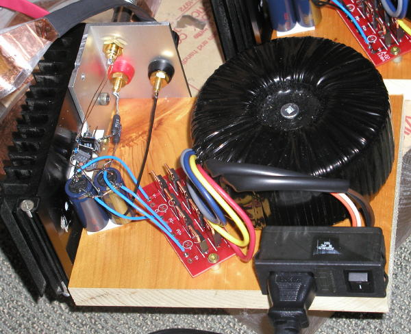

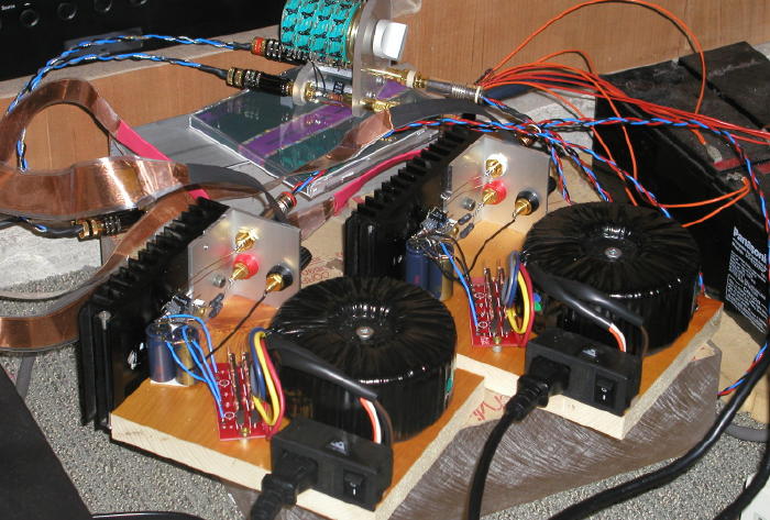

So, the amp is working and the first impression is a very positive one. Very similar signature to LM3875.
I used BYOB approach and the amp is assembled around a spruce board. I used 0.22 ohm Mills at the output and DC offset is 0.024mV in each channel.

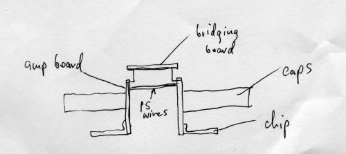

Sizewise, the amps board wouldn't be much bigger than the one used for LM3875. I still have to figure out how much capacitance is really required for best overall performance, but even with 1,500 the bass is very good. So it shouldn't be more than 3" x 1.5" big. It would include 2 jumpers, for either running channels in parallel or stereo. For bridging, I would suggest aligning them, with wires running through PS holes on each board, so power distribution is very much simplified. The amps board should have mirror image of PS acces points, which is not a problem (basically left and right version). The bridging board could be mounted on top, for even simpler layout. This would be one cool, high power amp module;)
What is really required for the bridging board, any schematic example?

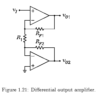

It might be better to do it without a bridging chip, and just use a differential output amplifier. This would allow you to try different opamps, and even discrete opamps, such as used in the mox.
I got the below picture from my school lecture notes. You can find it here:
http://users.ece.gatech.edu/~mleach/ece3050/Sp04Notes/OpAmps01.pdf
on page 18, with a description of how to calculate the values.
For the application of bridging, you would make Rf1 = R1 and Rf2 = 2*Rf1. A good value to try might be 1k for R1.
Brian

The transformenr I'm using here is double 22V AC secondaries, 300VA Plitron. This produces around +/-34V DC on rails.
I never used no centertap transformer with virtual ground, so I can't comment on that.
I tried adding 5,600u Nichcons directly after rectifiers and the sound degraded substantially. I will stick with 1000 per rail only. Also adding 4.7BG N on rectifiers board, improves performance, so they would be recommended.
