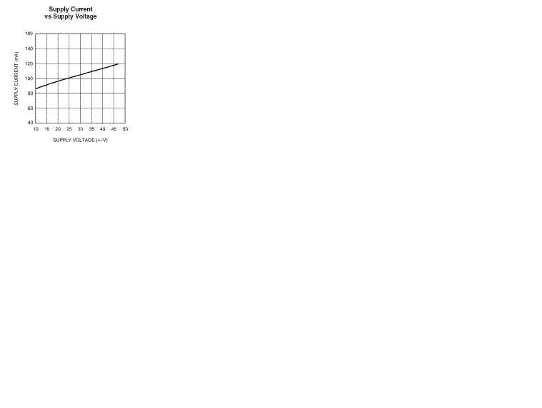

Is this the graph to figure how much current is needed to supply the amp?
No, that's the idle current.
To find required current we usually use the power output formula. Pwer = Current^2*Load resistance.
For the rated 60 watts into 8 ohms, that is about 2.7 amps per channel, or about 5.5 amps total.
