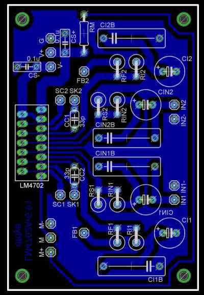

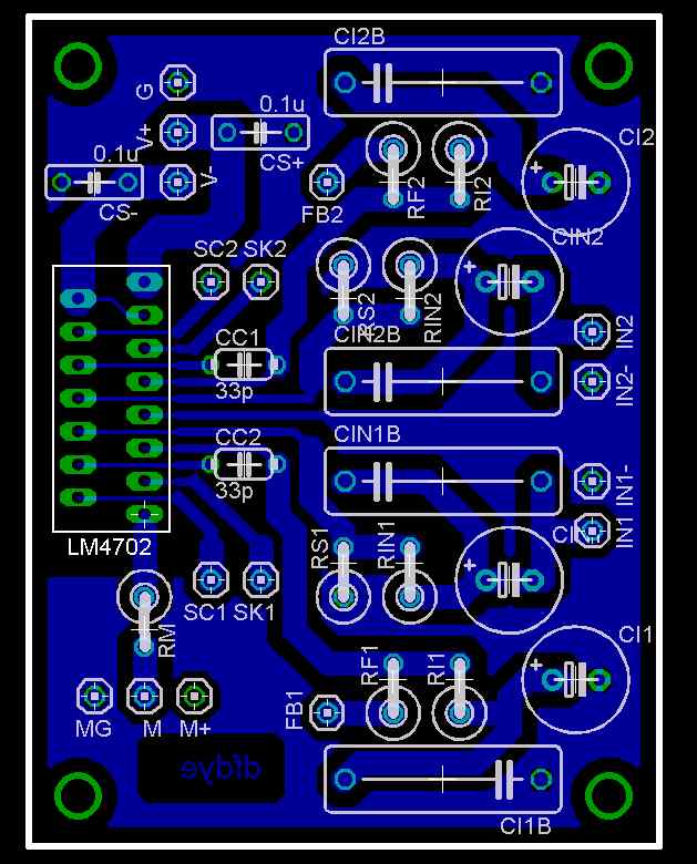

Alright, time to get the ball rolling on making some PCB's. Since I am still REALLY new at this, I figured I would run a design by you guys to see if I am anywhere near the right way of thinking about this.
The resistors are all vertically mounted to allow a variety of different sizes/brands to be used. The thinking was that using 1/2W resistors would be easier with this configuration without taking up a ton of real estate on the board. I know the silk screen layer overlaps in several places, but I am planning on etching these at home and not applying a silk screen. (however, is there a way to move labels in Eagle without moving the whole component?)
After the discussion over using bipolar electrolytic input caps and bypassing them with film caps, I put in space for using 1uf film caps paralleled with 33uf electrolytics. I noticed on Russ’s boards (which, with apologies to Russ for my bad design , was the starting point for this board) that there are larger electrolytics on the power inputs that I am not 100% sure the purpose of (are these additional reserve caps, or are you putting in power directly from the transformers here and using these as smoothing caps?) The parts I have tentatively picked out for the comp caps (CC1&2) are ceramic, though if there is some reason I shouldn’t use ceramic in a circuit, I would love to hear some alternate suggestions!

I will definitely let you know when the prototype is up and working (hopefully some time within the next week if all of the parts get here, but that may be a little optomistic!), but I am having a hell of a time getting some of the more fine traces to transfer to the blank PCB's. So far I have used Epson Photo paper, Laser overhead and inkjet overhead material as toner transfer material, and I think that I just need a little more practice to get the fine traces around the chip to come out clean. For now, it is all sharpie!

In the mean time, I have ruined several blank PCB's trying to get good home brewed boards.
Olimex here I come!!! Oh, and I fixed/tweaked a few more items on the boards. Once I'm happy with the final versions, I'll post in case somebody wants one.

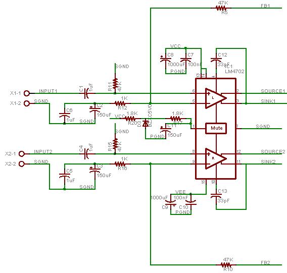

Now that I am getting close to putting together the output stage of the amp, I was wondering how Russ and others are using the thermally compensated transistors. I know that the SAP16's were suggested, but I wasn't really sure how these would be wired up. If Russ or somebody else could post a simple schematic of how these would be used, I would grately appreciate it! (Still learning!)
I am still planning on using regular transistors for the first itteration, but I would love to have some more options for future tries.
