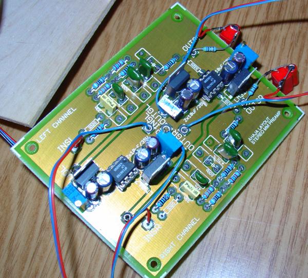

Looks like the capacitors in the RIAA network should be switched. The 47/33nF combo should be attached to the bottom of R7 as shown below, the 27.2nF combo is attached to the non-inverting input of the second amplifier. (Yeah, I did point this out to National, but haven't heard back from them.)

One month ago I made a few pcb's for this preamp, based on National pdf (Lm4562). 2 weeks ago I soldered elements and gave him a chance :) ... played good. But I got distortions, sth like dirt in sound. Then I realized that feedback loop is too big on pcb ...and I soldered smd 3320R beetwen opamps pins - that was that :). I found this post on forum and I changed positions caps in riaa - bingo !!!! - jackinnj was right . Now sound is out of any disstortions; no hum; big, deep bas; vocals are very good; stage is also deep and large; is just beautiful music.
PSU: old russian transformer (2x15V); schottky diode (8) with bypass caps on each; chokes; 12x5600uF/25V (Rubycon). LM317/337 as close as it was possible to opamps (on preamp board).
I changed also gain - instead of 150R I placed 100R - with my Ortofon 510mkII (3mV output) is great.
Here are pictures
>jackinnj - thanks for idea.
